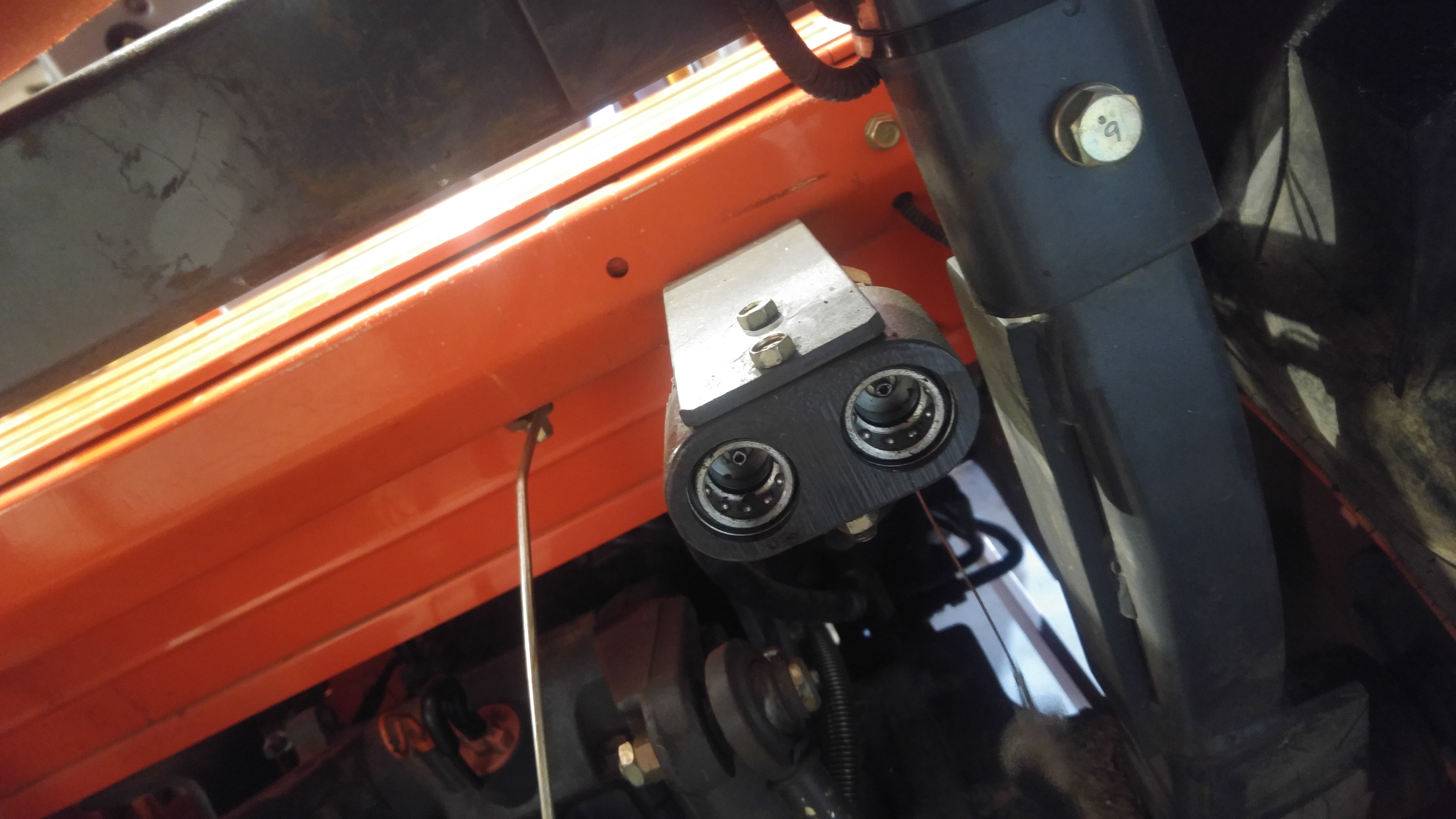

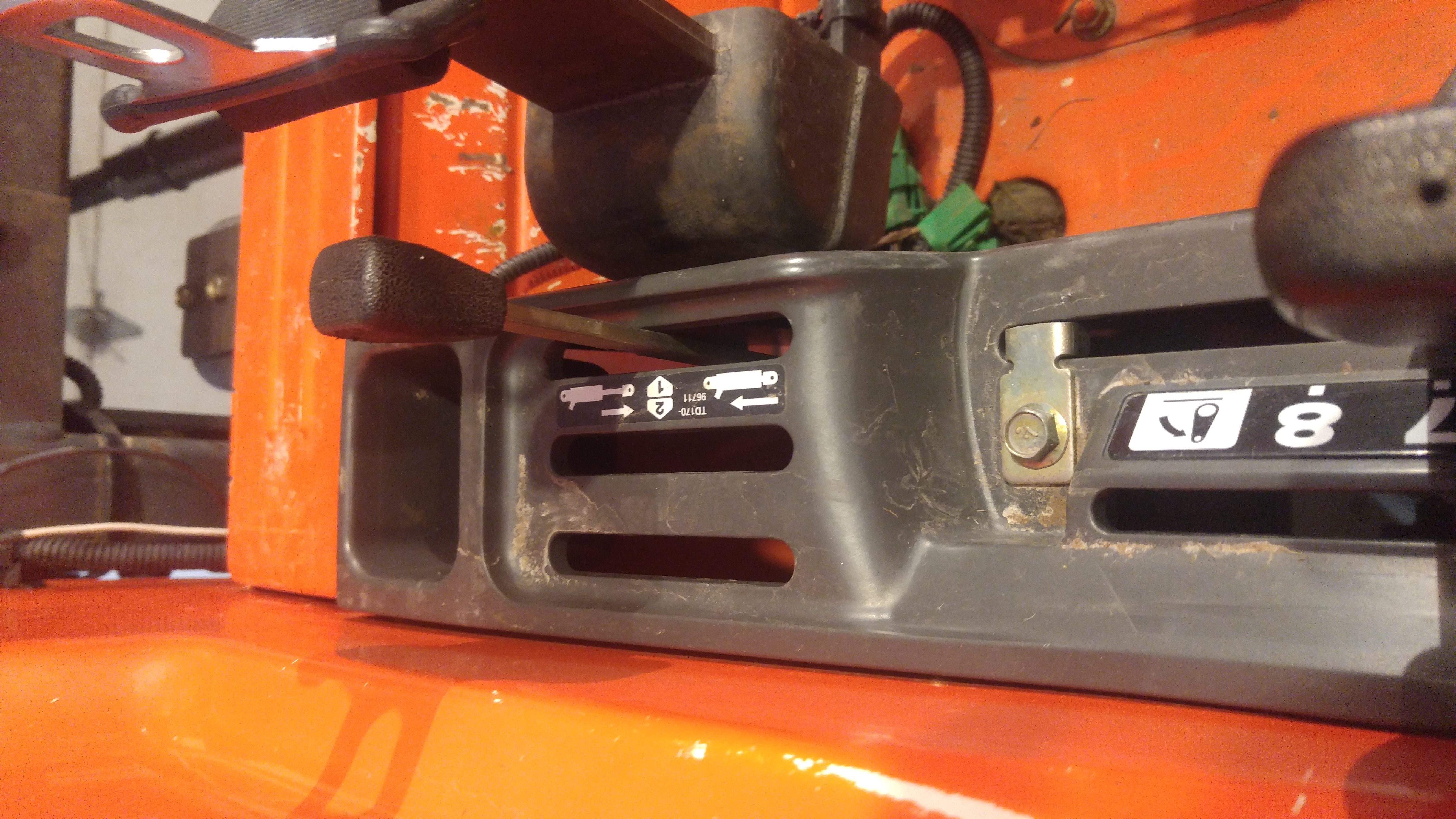

Hi,
I have a 2008 Kubota L3940 and I have been having an issue with my rear remote and I don't know where to start. I was hoping someone out there could get me started to figure things out. I have attached pictures of my set up - I believe it was installed by Kubota dealer.
The problem is only one of the connections work. I have a hydraulic top link and it only works in one direction. When I switch the hose connection, it only works in the other direction (in or out). When I push my lever to activate the connection that doesn't work, it makes a loud squealing sound. I don't know where to start troubleshooting this system (and how to do it safely) . Any help in that direction would be much appreciated!

I'd say we know the problem is NOT the toplink's cylinder, hoses or connectors, because it works when hoses are swapped.
I'd also say it's not one of the tractors connector's, because both connectors have to flow oil even when cylinder is only being operated in one direction (i.e. oil fills one side of cylinder, and is returned from the other side when cylinder moves).
If you follow the handle in your 3rd picture, to the source of the hydraulic lines that supply the remote connectors shown in your 2nd picture, that is where you should find the actual Selective Control Valve (SCV). I'm no expert, but I'd guess that's where the problem is.
When you push the lever and get the squeal, can you see if the top links hydraulic hoses are pressurized (do they move)?
I'd guess they do, but something wrong in the SCV isn't allowing the return line side of the cylinder to empty, so cylinder can't move, so the system's relief valve operates and you hear the squealing.
This is just a guess. Hopefully more experienced people chime in.

One possibility is that one connector is not getting fully connected.
If the center plug on the tractor side is not fully locked out it could possibly allow return flow,
but not supply flow.
When you connect your remote hoses;
are you pushing the hose end in and is the tractor connector moving forward then back a bit?
are both of the tractor halves going forward when you connect your hoses?
when you disconnect your hoses are you just pulling on them, do they both take the same effort to pull free.
do your tractor halves move back and forth freely and evenly?

When you mate the female ends, the cylinder hose ends to the tractor females.
Do you just push them in till they connect and then give them a light pull to be sure they latched in?
When you disconnect do you just pull the hoes out of the female tractor ends?
Do they require a sharp tug to disconnect?
If you grab the lines going to the tractor connectors can you move those back and forth almost a 1/4 of an inch each way?
Have you tried flushing the bodies with WD-40 or a similar product while moving the tractor ends back and forth?
There are o-rings on them that can become dislodged and not allow the connectors to latch in fully.
Do you just push them in till they connect and then give them a light pull to be sure they latched in? Yes, they both seem to act the same
When you disconnect do you just pull the hoes out of the female tractor ends?Yes
Do they require a sharp tug to disconnect?Yes, they require a sharp tug - both seem the same in this respect as well
If you grab the lines going to the tractor connectors can you move those back and forth almost a 1/4 of an inch each way?Yes, between 1/8' and 1/4"
Have you tried flushing the bodies with WD-40 or a similar product while moving the tractor ends back and forth? No - I don't have any WD-40 on hand, I will try this soon
I answered the above questions in the quote - hopefully in bold
I went over to my shop this morning to see about the questions above...it has been a while since I hooked up the top link - when it was acting erratically in the spring, I just put the old one on and hadn't tried it since.
When I hooked it up today, it would exhibit basically the same issue as it had in spring - it would act erratically - sometimes it would work, sometimes it would work really really slow, and sometimes it wouldn't work at all in the one "bad" direction (depending on which hose is hooked to which connector). Even if it worked, it would make a squeal noise in that direction. Not sure what to think about that...
I will try to flush out with WD-40. Any other ideas where to go from here? Thanks!

On my 3301 the rear emotes the lines have to be just so or it works the way you are saying. Take your top line and plug it into the bottom and the bottom into the top. I spent a whole afternoon taking one of my pieces of equit apart and putting it back togather to find out by switching the lines all was well. You don't want to know what I said

I have no idea what valve is on your tractor but,
if you trace the lines back to the valve are there any flow restrictors in the lines or on the valve?
If you took one line off your toplink and put the other quick connect on it,
you could plug the line in as a loop and operate your valve in both directions, if good
your connectors and valve are good.
If not inspect your connectors carefully depress the center teats on the connectors,
male and female side checking for even seating.
Or try another cylinder with your tractor or another tractor with your toplink.
Some valves will have adjustable flow restrictors and or screws with lock nuts to back out
or screw in for single action cylinders, not real common on newer smaller equipment
Good Luck

I don't have any remotes on my tractor but I think on your tractor the lever is connected to the valve with a rod. Does it feel like the linkage from the lever to the valve could be loose? If not how many hours are on the tractor? It's possible that the valve itself is damaged or worn. If you rule everything else out I would go to Kubota's website and find the parts diagram for the valve. Since the valve is most likely a custom designed for the Grand L series it could have built in check and pressure relief valves (I know the loader valve does) that may not exist on a standard valve.

OP here. I am pretty sure the issue is on the tractor side. I have used my log splitter on this tractor and had the same issue with the rear remotes only working in one direction and since the top link works well in both directions (when I swap lines), I doubt that would be the issue...
Where to go from here? I think the first thing is to try to clean it out - WD-40 is best? should I use a screwdriver and press the middle of the connector and let it flush? Anything else to try.
The valve is under the seat and not easy at all to get to or to look at. I was thinking after I try flushing (assuming it still has issues), the next thing to try is to switch the connectors with the lines and see if the problem follows? Anything to be aware of? How do I de-pressure the system (or do I even need to)?
Is this the best plan of attack?

If the issue is with the tractor;
gently unseat the middle teat on the connector and gently flush with WD,
after your tractor has been shut down for awhile it should have depressured itself,
put with the engine off just move your control lever to all 3 positions a couple of times.
You can disassemble the rear connectors and swap them side to side.
