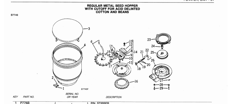

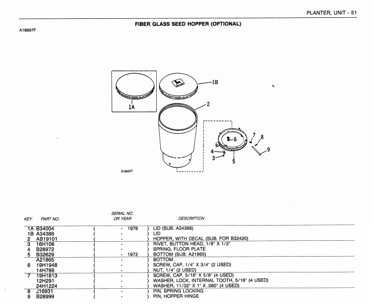

I just got a john deere mod 51 planter with fiberglass bens and the floor plates are frozen and rustyed up bad. I got it broken loose and having trouble finding parts are the parts the same as medal bens in the parts list and what plates should i use to plant peas like black eyes and acre peas any advise or help will be great thanks

51 paarts catalog lists fiberglass seed hopper as optional. Do you hopper bottoms resemble parts photo?
/ Need help with JD Mod 51 planter
Yes, my hopper bottoms do look like this in the attachment I am assuming the bottoms are the same just the hopper are optional.
