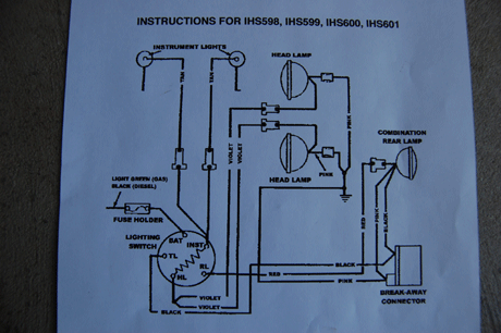

Need Help with one more Wiring Puzzle tp solve THE LIGHTS... All the Scematics I've looked at show 1 wire from the switch to each of the front lights and 1 to the rear lights... I have 2 wire each coming out of my sealed beam headlights and 3 wire coming out of the Rear Sealed Beam... No PUN intended but can anypne shine some light on this ? Why 2 Wires Each on Front and 3 Wires to Rear??? Makes no sence at all to me. Thanks, DanO'

Are they grounds? Check w jumper wires. Is there a flasher for the rear (doubt that)? Pretty basic wiring on my old A.

Thanks for the advice Jimmy... My 53 Super A was Very Simple too. Seems this 63 Cub has a kinda strange wiring set up, the Front Lights Housung is NOT the Ground... 1 Wire Each HOT, 1 Wire Shared to Ground and the Rear Light is a Rear & Work Light combo, Plus a Ground Wire. .. Why??? Who Knows.. Guess Somebody had " a Better Idea"I Anyway, I finally found this wiring Diagram on an old archive Forum from another site, so figured I'd post it here for Future Reference Help. Lightdiagram.gif

Some models did have Fast Hitch at that time. So maybe the rear work light alone to help hooking those attachments up, and maybe for when backing into a dark shed at night to park, etc. Even backing into a dark building on a bright sunny day can make things difficult to park, or get hooked up to something.

Yes the headlights each have two wires only. A hot and a ground. The rear lights have two hot wires each and a ground.
