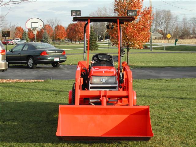

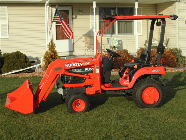

Hey guys and gals, I need some help. I just picked up a cab roof from a Curtis Cab that came into my dealer scratched. To make a long story short, I bought it for a decent price and want to make a canopy out of it. Since this was designed as a cab roof (In other words, it attached to the sides of the cab which supported it), I have no way of mounting it. It is made of a fairly heavy gauge of steel, and weighs something like 60lbs. I figure on making a frame that I'm going to clamp to my ROPS, but I'm wondering if a couple braces angled up from the rops to the front of the canopy will support it properly. I want to try and minimize the vibration on it as much as possible for lights, etc.
I'd appreciate any ideas and if anyone has pictures of how their canopy is mounted, I'd sure appreciate it if you could post em....
Thanks in advance!!!

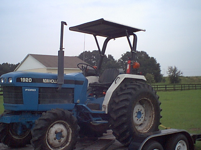

Try attatching it like my canopy is. The are angle iron brackets, and use 'U' bolts to attatch to the rops.. canopy and all.
Soundguy

   / Need help with Canopy design
Thanks to everyone. I think I have a design in mind and am going to try it out this weekend. Sort of a hybrid between your pics here and another tractor I saw on my way to work. If it works, I'll post pictures, if not, well, I think I'll try PineRidges solution to see if it will work. One think about this rooftop is that it is made of fairly heavy gauge metal and I'm hoping that i wont need bracing from front to back.
Thanks for the help everyone! /forums/images/graemlins/smile.gif
Scott
#9
Well, here are the results... Pic 1
From the front...
