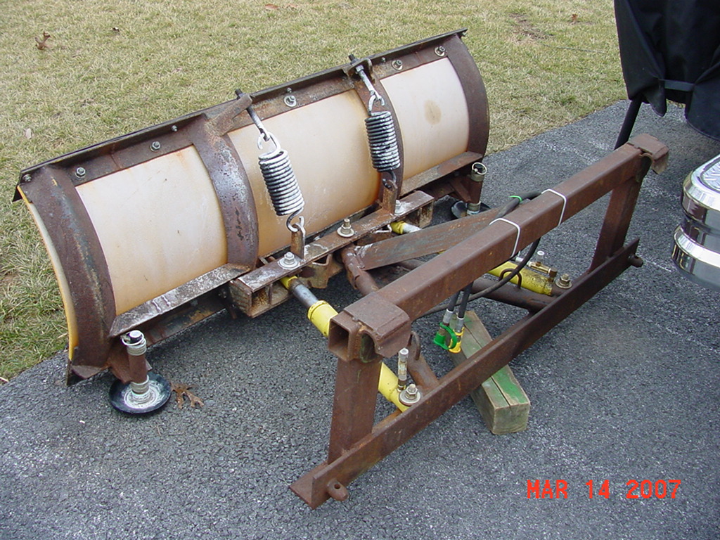

I got 7 1/2 foot western plow for my 3320 I working on my mount for the 300CX FEL. I need anybody that lives in central Illinois to come by my shop and help me fab up a bracket, I don't even know where to begin!!!!!
Today I just ordered the brackets from Deere Dealer, they will be in on Wed.
I need to know what kind of metal , and even what size!!!!
Can Anyone help??
I got some people telling me to mount it to the frame, some tell me to mount it on the loader, heck I am confused on what I am going to do!!!
Please Anybody!!!!

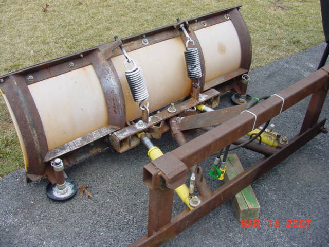

I am not a fan of loader mounted blades, but hopefully these pictures will help you with a design. They are both mine...But the blade is long gone. I used 2"x3" box for the frame.

Thanks Kenny, but how do I build my bracket like yours, when I got the Plow Frame with this?
The frame of the plow that came of the truck is with this assembly.
Can anyone help me with getting this together?

I hung the "hooks" on the loader, measured a crossed them and cut the top piece-then tacked it on...then measured the side and tacked them on...I basically built the whole frame right on the loader to avoid measuring mistakes.
There are LOTS of plows on this site to look at and copy if you search, most are better that mine for sure! I was just helping with the ideas for the FEL QA frame.
