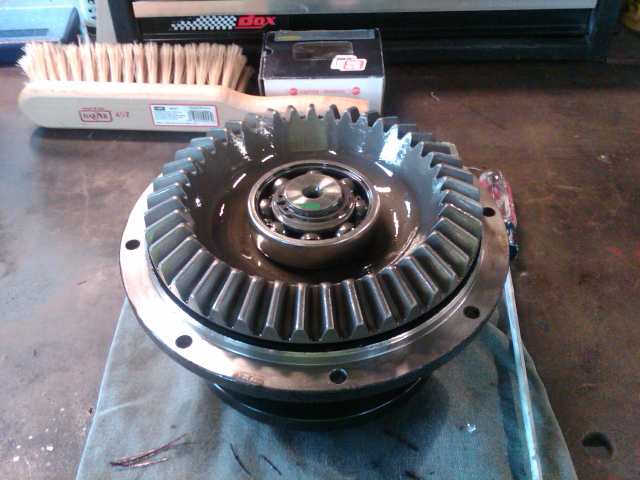

I lost all the fluid in my front axle after a 12 hour day of digging and moving dirt with my FEL, I am sure it is just the seal after reading some other posts on here but I am stuck?? I have removed the clip and tried to use an 8" gear puller on the gear but i cant get the bearing to move at all. What am i doing wrong??? Thanks for any advise you can give!
My hub is the same. I used a press and pushed on the shaft once the
circlip was removed. As I recall, you can't get a puller behind the bearing
by itself. Spicer uses interference fit bearings, unfortunately.
   / Need help with axle seal behind hub on a 3320 #3
As DF said use a press. I hope you too the c clip off before trying the puller.
Matt;)
Thanks i was able to get it with the gear puller. once i had it as tight as i could i hit the center screw on the puller, it broke free then came off fairly easy.

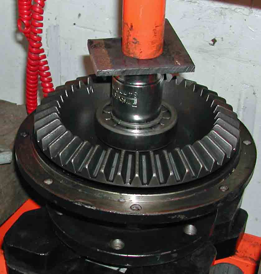

The correct tool to put it back on is a press, too, but I suppose a
hammer will work.
