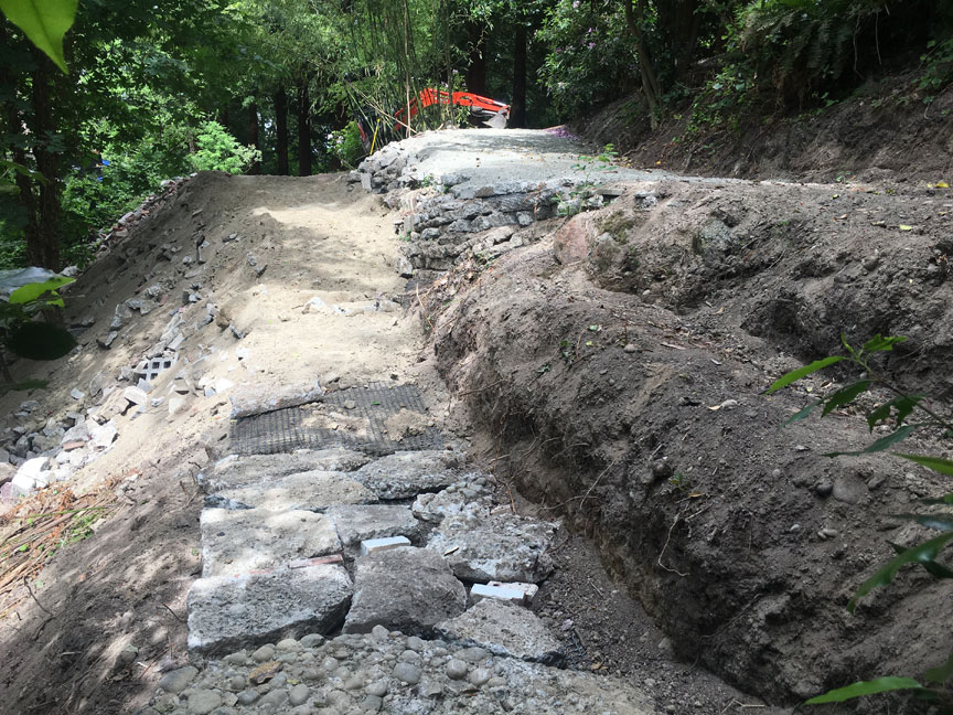

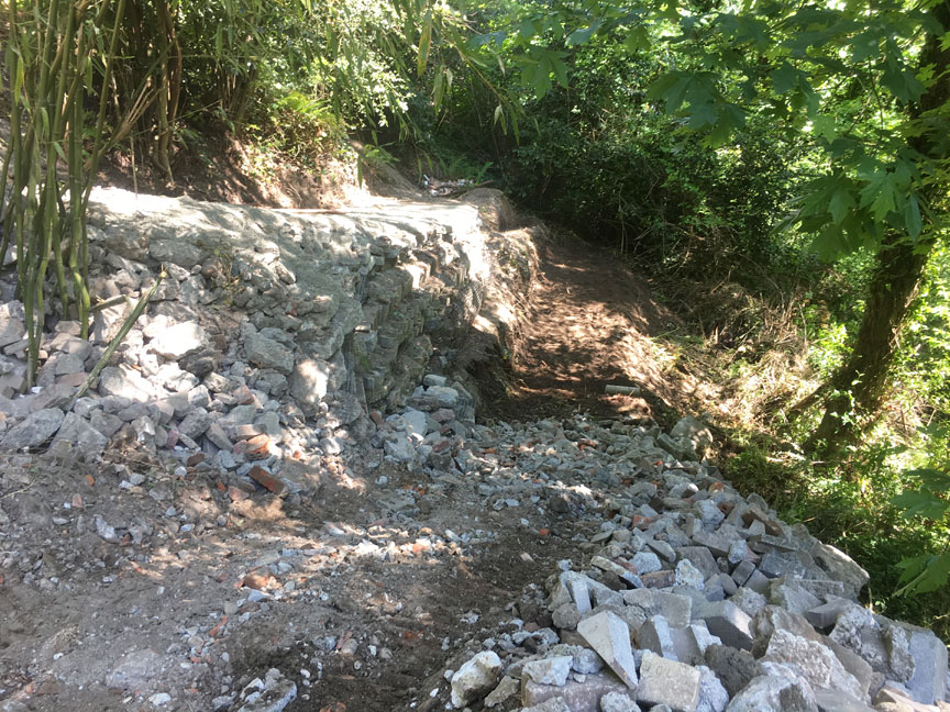

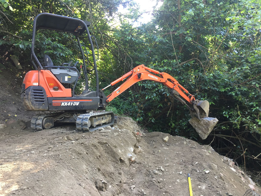

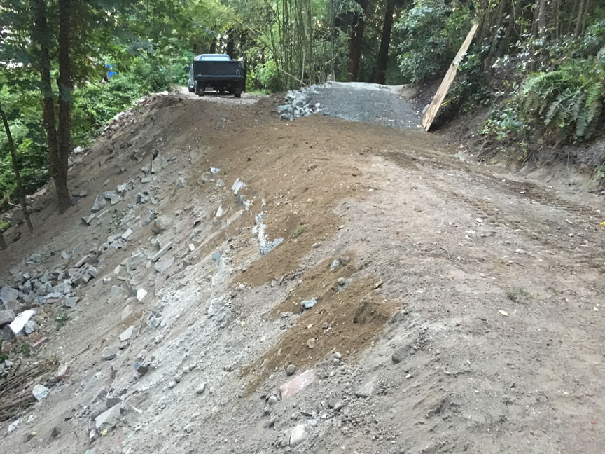

Now that I'm more comfortable with road-building on a steep slope, I decided to widen the parking area. Another developement was finding a v ery close (1/2 mile) source of free dirt AND free concrete rubble. I just show up with my dump trailer and they load me for free. They are happy for the free hauling.
557761d1528517197-need-help-access-road-across-2nd_stairstep_1878_12-jpg
557762d1528517197-need-help-access-road-across-2nd_stairstep_1880_12-jpg
Started the widening by digging another cut/fill shelf.
557763d1528517197-need-help-access-road-across-2nd_stairstep_2028_12-jpg

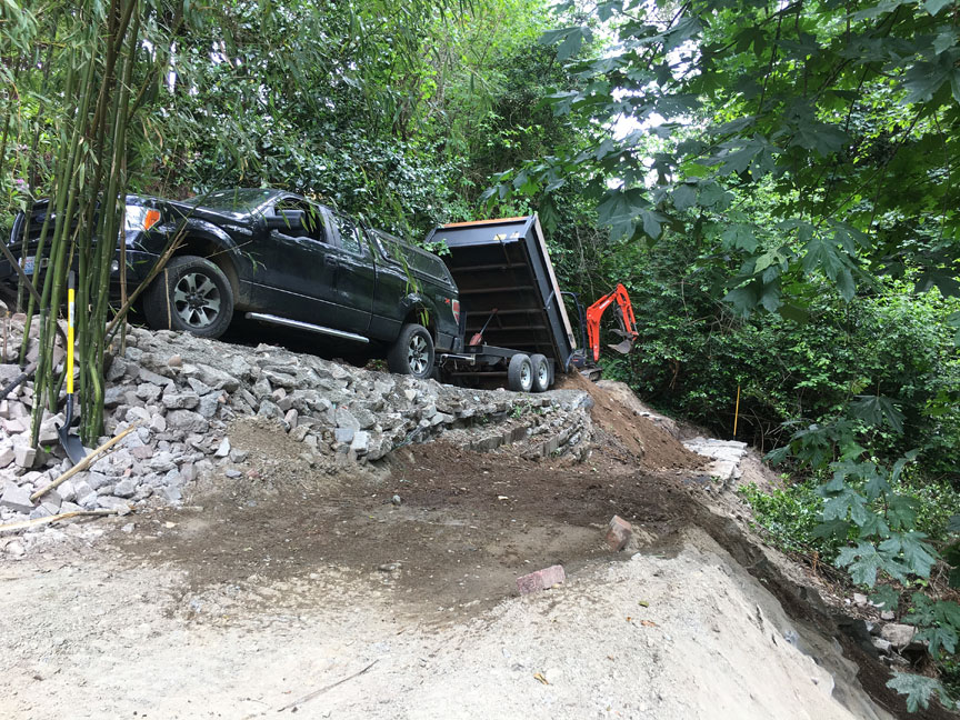

Placed bigger concrete chunks by mini-ex. And in-fill by hand. It took many days!
557765d1528517197-need-help-access-road-across-2nd_stairstep_2047_12-jpg

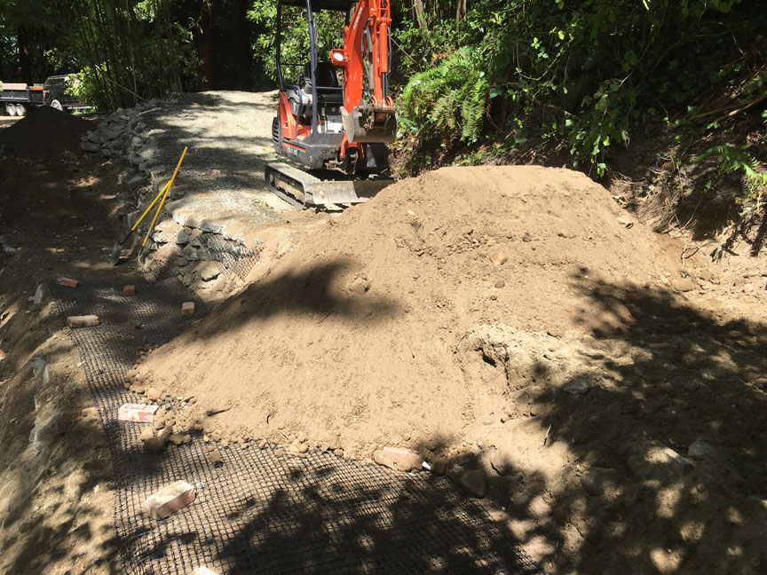

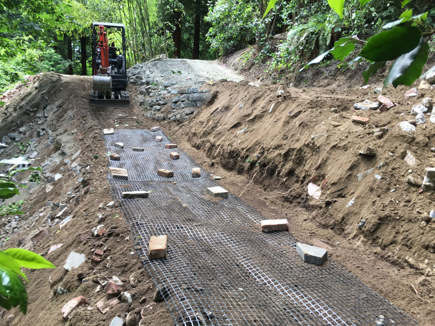

Continuing the layup with the geogrid reinforcement.
557764d1528517197-need-help-access-road-across-2nd_stairstep_2044_12-jpg

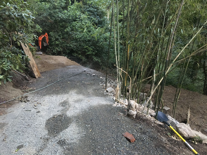

557769d1528517197-need-help-access-road-across-2nd_stairstep_2116_12-jpg
557768d1528517197-need-help-access-road-across-2nd_stairstep_2115_12-jpg
557770d1528517197-need-help-access-road-across-2nd_stairstep_2117_12parking-jpg
Pretty much done for sure this time! Much better!

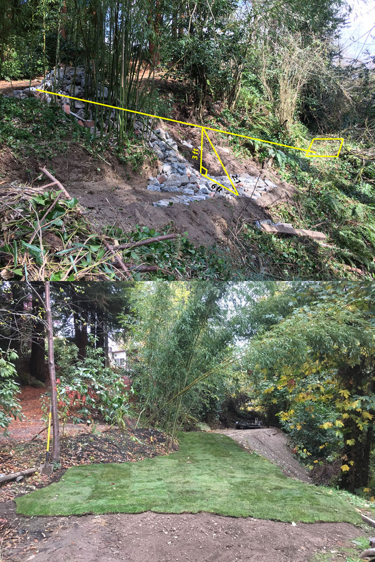

Couple more pics
557772d1528518610-need-help-access-road-across-2nd_stairstep_2165_12-jpg
545062d1521697148-need-help-access-road-across-grade2-jpg

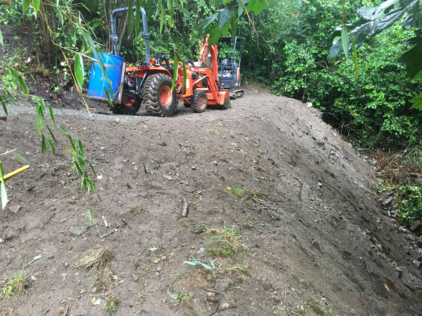

Before. The tree (near the Willys) is gone. Note the bamboo behind the Willys. And note the two dark tree trunks above the rubble pile.
557771d1528518610-need-help-access-road-across-2nd_stairstep_2123_12-jpg
After. See the two tree dark trunks to the right of the bamboo. About 1/3 of the bamboo remains, it may grow back (quick?). But the bamboo's roots are buried about 3 feet below grade, not sure if it can survive like that.
I think I moved kind of a sh*load of material with that little tractor and sub-mini-excavator (3800lb) and dump trailer and hand. Many the blocks of rubble were hand-placed. Now I just wait for the Ivy to cover.

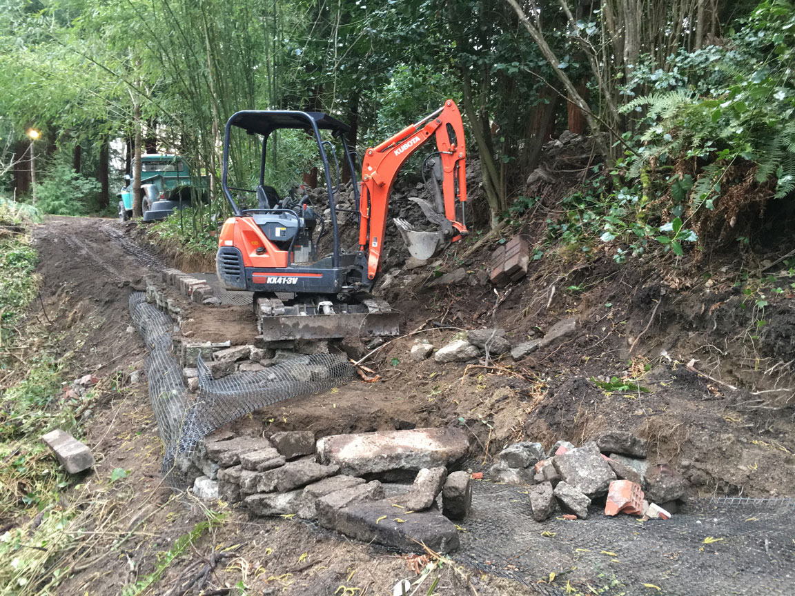

It was perfect size for this jjob for many aspects. But whenever I had to push out a 5yd pile of rubble, it was too small, not enough power. But for the rest of its usage it's easy to store, easy to transport, didn't cost too much. Lots of good things about being small.
557874d1528606106-need-help-access-road-across-img_1244-jpg
It was the perfect size for this task. Other times I reduced the track width. The KX41 has variable track width; it can narrow up to fit thru a 36" doorway. But pretty tippy when narrow.
Very nice job on the project. Did you buy any ibuprofen? :laughing:
I didn't use a single pill. I did carry some heavy chunks at times though and had to give myself a good talkin' to a couple times, "don't take chances!". No sore back, which is not really normal (for me). Normally heavy work hurts my back, but this wasn't a lot of bending over. I think "doing it right" not too fast, but built strength and made my back stronger.

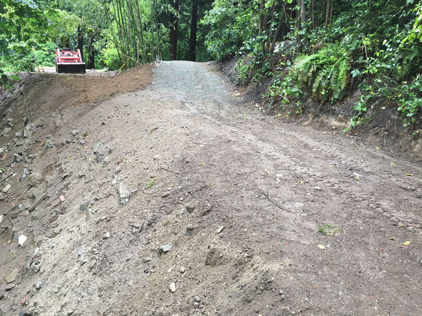

Update.
I am pretty far along on this.
It's much better than I ever imagined and I've learned how to build on a hillside.
I hope it works on one hand and have high confidence it will OTOH. I've done a lot of digging and I know what stays on this hillside (=what was there) and I know that digging stairsteps and filling with reinforced earth is bigtime stronger than it was.
I have to figure out the drainage, and it's winter now, a good time to observe.
And a good time to develop 20/20 hindsight.:eek:
Also extended it 40 feet longer and 3 feet wider than it was in the last pic, so there's a 30x15 level pad at the end.
Thats my car trailer sitting on the pad.
You see the bamboo in the middle of the pic? Same bamboo except its roots are buried 3-5 feet deep. Good thing its low growing bamboo it would be heck to dig out now.
I put in a drywell at the far end. Ready for if I ever put a shed, I already have a drywell for the roof water. Drywell has 3 yards of drain rock. Does anyone know how many "yds of rock" are necessary for a 12x20ft roof?
