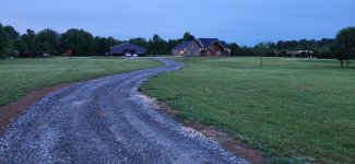

I know timing is not right for this year. But over the course of the next few years I would like to turn my property from junky thin weedy grass to a nice looking lawn. Maybe the hay guys can help? Bermuda is the only grass I really have any experience with and I like it pretty well. I finished my house this winter and threw out a bunch of Rye grass seed for erosion control. That did the job that it was intended for but it sure caused a lot of mowing! Then I got a hundred or so pounds of Bermuda and Fescue, mixed it together and spread it around the house in the thin spots and where the rye was. A whole bunch has taken off, but not near what I threw out. This property has been cut for hay for a very long time, probably more than 10 years, with very little if any fertilizing or amendments done to it. It's thin for the most part and not a lot of real grass, mostly all weeds.
What is my best bet to start working on improving it? I figure heavily fertilizing it will be the starting point. Would it be worthwhile to spray 2-4D and spread seed when a bunch of the weeds die? I don't have access to a seed drill to overseed. I don't really want to disc it up but if I need to I can do that as a last resort. If so, I'll probably just do an acre or two at a time, and probably with my little tiller. Bermuda seed is pretty expensive... What time of the year though? I don't know if that is a fall or spring thing.
I'm open to any ideas. I only have experience with small yards. And back in the day there was a chemical called MSMA that killed almost everything but Bermuda. Just it and 13-13-13 would be about all you needed for a pretty yard.
Also my property is 11.38 acres and 9-10 are what I maintain as a yard.

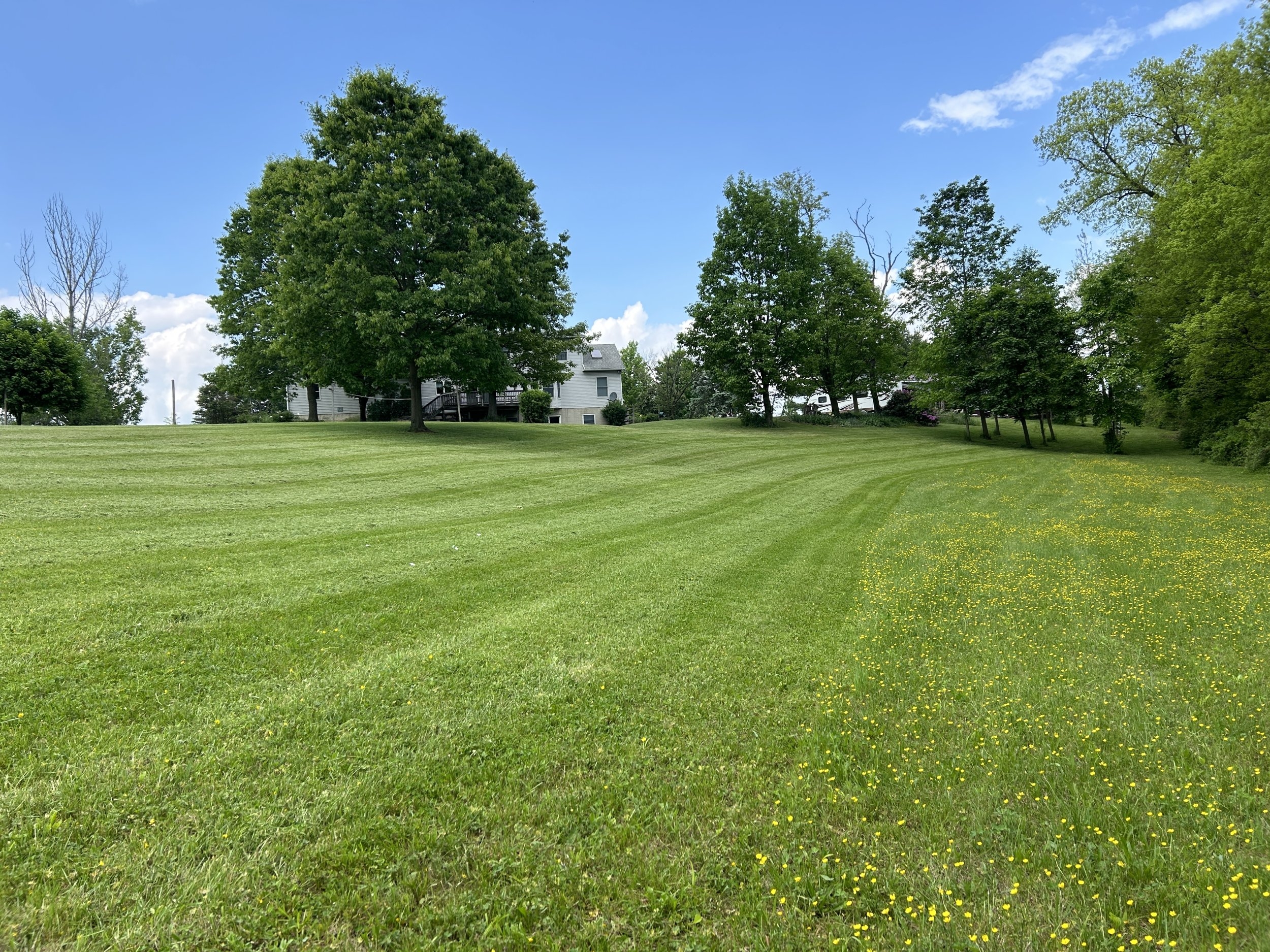

Most of my yard is former field, except where they graded around the house that got Ky blue. I just mow what’s there, looks good to me.

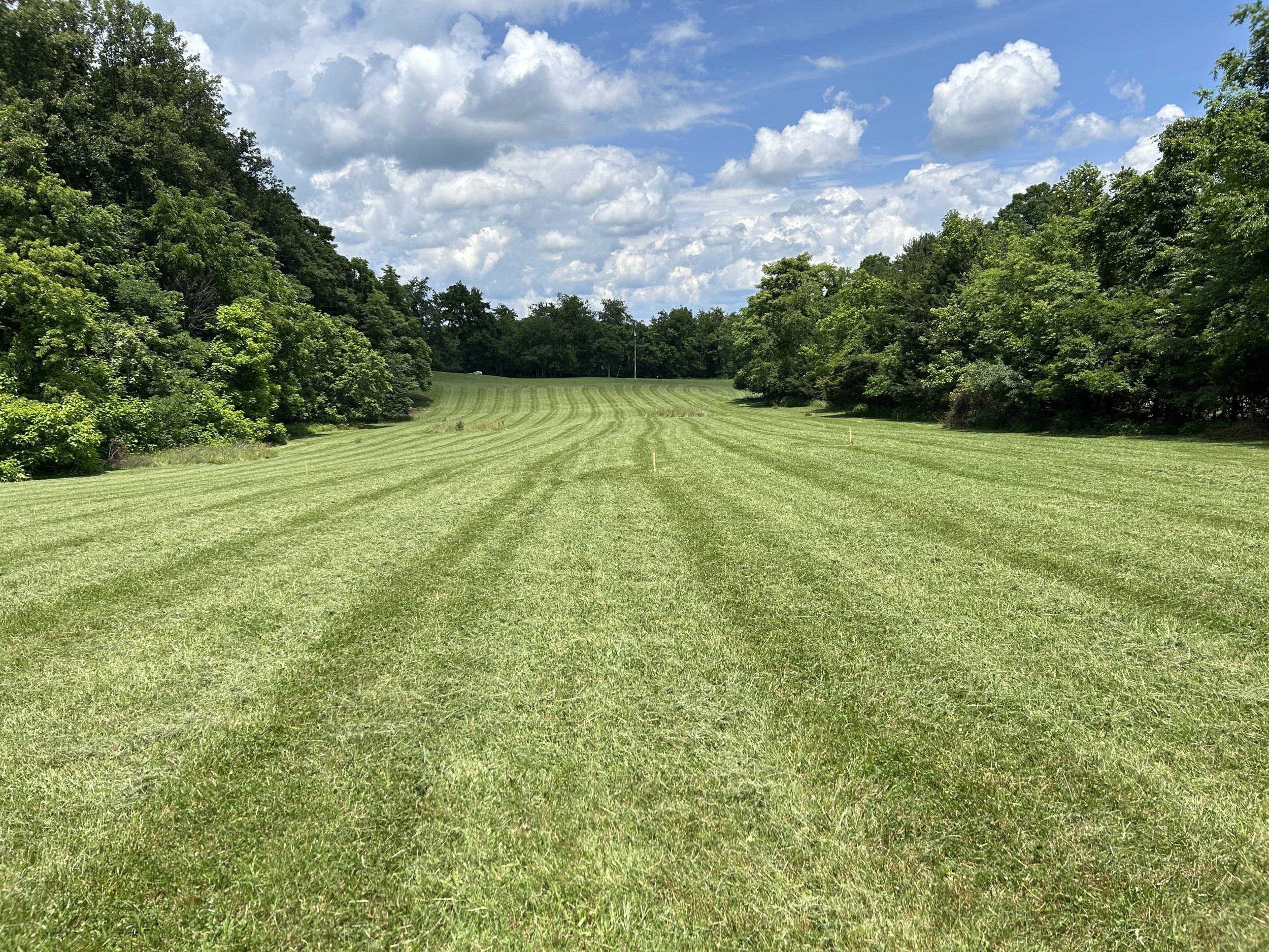

Yours looks much better than mine.
I used to let it grow and mow it with tractor and bush hog once a year, or RFM about once a month. Now that I have ZT, I just keep it mowed. So much faster with ZT.
I also mow about 3.5 acres of my VA land with ZT once a month, it was a hay field when we got it 2 yrs ago
