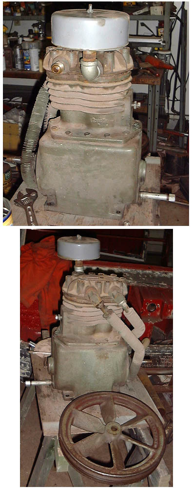

After 50 years of service my air compressor pump is in need of a rebuild! I guess all that sandblasting and grinding on the Unimog was just too much for the old girl. But there are no makers names or markings. Just a date cast right into it! (10-24-55) I need some help in identifying the pump to see if I can get parts to rebuild it. Right now it blows air out of the intake, so I guess it needs some valve work for one. And I know it needs a seal at the flywheel side. The flywheel is 14" in diameter. If anyone knows what make please, please let me know! /forums/images/graemlins/confused.gif I hate to have to buy a new pump when all I need is a few parts to make this one right again. Thanks for all your help. Von

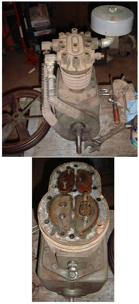

Here is another photo. Thanks, Von

I don't know what make it is, but is there any way you can lap the valves? The seal shouldn't be a problem, you can measure the I.D. and O.D. and then look one up in a Chicago Rawhide catalog. You might end up needing rings, also, that might be why the seal started leaking. You can size up the rings and find replacements. That leaves the rods and mains, the mains stand a good chance of being ball or roller bearings and the rods might still be babbit with shims. If it isn't knocking the bearings probably don't need looking at, but if you decide to re- ring it make sure and keep track of any shims you might find under the rod caps. Don't mix up the valves, just this last Sunday I went through the valves on an old 10 H.P. three phase Quincy that hadn't worked right for years. Somebody had stuck the valves in the wrong holes and nobody could figure out why it took an hour to pump up. They thought the valves wouldn't interchange between holes, I ran my fingers through the ports and used a screwdriver to figure out which way the valves worked and got it to pumping a 50 PSI rise a minute. /forums/images/graemlins/smile.gif

I am exactly in the same spot, after years mine only gets to 90 psi instead of 160, so I think somethings gone south in the valves of the high pressure head.

MAYBE an old Kellogg American.
