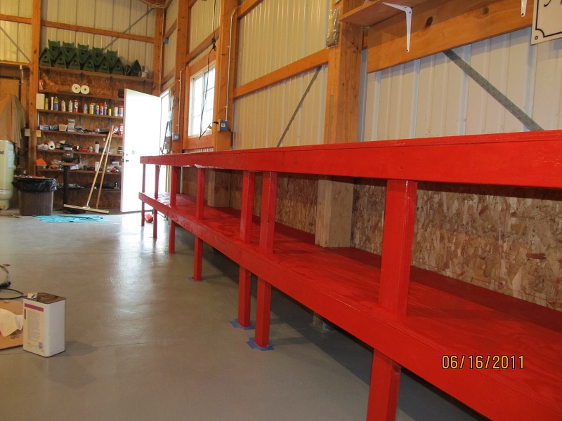

I am thinking of putting either formica or melamine down for the light duty top work surface on my bench and have a couple of questions I hope someone can answer. The bench has 3/4" plywood on the top that's screwed down. I figure I can unscrew the top, trace the top onto the laminte and cut it little oversize. Then I can clamp it to the plywood and use a trim router bit to make the formica the same size as the top. Then I reinstall the top and glue down the perfectly fitting formica. But I may use melamine.
My questions are 1) if I cut a laminate like this, do I cut it with a circular saw right side up or upside down? And 2) Will a trim router work on melamine or formica or will it just shatter the edge? Does anyone know?
Here's a pic of the bench when I first finished it. That was the cleanest it ever was.
Melamine is an old hot rodders trick because it's easy to clean and when it's damaged you just peel it off and put another down. I have a 4 x 8 rolling table like this but I have never cut a sheet. I also have some metal tables so no need for metal. This is just a light duty work surface that I want to be able to wipe clean from light use. Any ideas appreciated.

There is a Formica router bit. I did this once many years ago but IIRC you rout off the overhang after the contact cement glue has dried. If you don't have a good smooth, void-free surface, for Formica I would put down a thin layer of mahogany plywood or Masonite first.
/ Need help putting formica on my workbench #3
I'd use Formica, much harder and will last longer. It also can be peeled, used a torch and heat it, comes right off. Use a good rubber mallet to hammer on it to be sure it has good contact.
Glue the formica to the top and then use the router with a formica bit to trim it. One pass and done. The bits come with roller guides and in several varieties from straight to angles.

I've been using Masonite on my benches. I screw it down with 3/4" screws, countersinking the heads so they are flush. I like how it is smooth and hard, absorbs oil and messes, and can be wiped clean (but stained). I intended to replace it every so many years, but so far it's still holding up great. The Masonite on my benches in my wood shop are all like new after 20 years. The Masonite on my barn bench is getting oil stained and abused a little after 10 years, but still works well. Even when oil stained, it wipes clean and doesn't contaminate the next project I set on there.

If you want to use Formica, first I cut it close to the right size with tin snips. I like to have an inch or so extra, then I apply the contact cement to the wood and the Formica, let it dry, then put it in place. Just stand it up and get it tight against the back wall, then lower it down, and roll it. Then use a router bit for trimming Formica to get the edges perfect. Remember that the bit is turning in a certain direction and it will cut better going one way then the other way. Practice to see which way works best for you. You wont be able to get the router all the way into the corners where it meets the wall, so use the tin snips to cut it as close as you can, then use a sheetrock knife to get it closer and if you need to, use a file to make it perfect.

on the Formica, over saw it about 1/2" using a fine toothed blade, clean up the ply wood, apply a good grade of contact cement, use some dowels to hold it up so one can position it, remove dowel on one edge and start to position it, and move along, and trim up with the 15 degree Formica bit, a hand file an take off any sharp edges,
do the front edge first, and trim with a square Formica bit, make sure he front edge is square, fill any voids with some good wood putty (like Durmas rock hard putty), sand smooth
that is how I would do it,
but IMO a steel sheet broke would be best,
