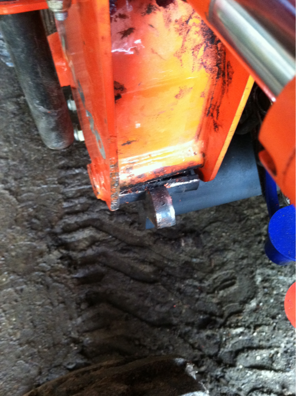

With snow & Ice going I removed my snow chains and front plow blade.
Putting my front loader back my BX25 proved more difficult than expected! :(
I can achieve proper attachment with either the left or right side but if I try both the round surface will not seat into the "U" shaped tractor surface resulting in the round surface slipping forward when I attempt to raise the bucket to insert the pins. Both "U" attachment points appear to be tilted rather than 90 degrees to the tractor centerline. I have tried many attempts with no success. :mad:
Anyone every experience this? Any solutions? Only 250 hrs/one year on the BX25! The bucket pins can not be inserted until the round surface bottoms out in the "U" and keeps the connection properly in place!
Thanks, in advance, for any Help!

   / Need Help! My BX25 Loader will not go back on!
This might show the problem but is worse in pic as the other side has the pin in place. I try both at once and both will not seat but with half this amount. Almost seems both are 5 degrees to outside of tractor centerline. Ideas?

EDIT: Slow Internet connection, just looked at the picture and have to agree with CT Jay, if one or the other will line up and pin with the other out of kilter something sure looks bent.
   / Need Help! My BX25 Loader will not go back on! #9
Looks to me like something's bent.
Did your plow sit on those receivers when installed in place over the winter? Does it mount that way? Possible you hit something over the winter and bent the receivers? Doesn't seem likely that the receivers would get bent before the plow would show damage, though....they're pretty solid and hefty, those receivers.....and bending the tractor's frame would take some event that you'd know about already.
Or more likely, one of the FEL arms somehow got bent into a slight twist?
This isn't what I thought you were describing in your previous post. This looks abnormal to me. If the other side is seated and pinned, then something has torqued either the FEL arm, or one of the recievers? I'd be hesitant to recommend this, but if it were me, I'd look for a torque twist somewhere on the FEL that's taking one or both of the arms out of square laterally. If you did see an out-of square condition, I'd maybe take a heavy bar and try to twist back in the other direction......but that would require a lot of force, and might damage things further. Beats me, to be honest!

Plow does not come close to the arms but I wondered the same thoughts. I wonder if the loader arms are twisted. I may try checking various alignments. Not sure how to bring loader arms back into alignment.
