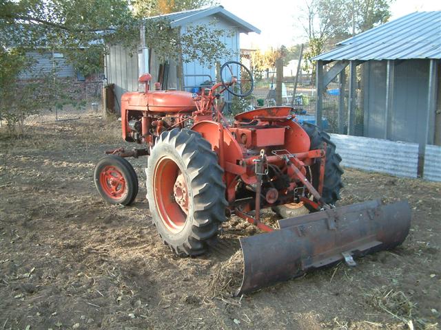

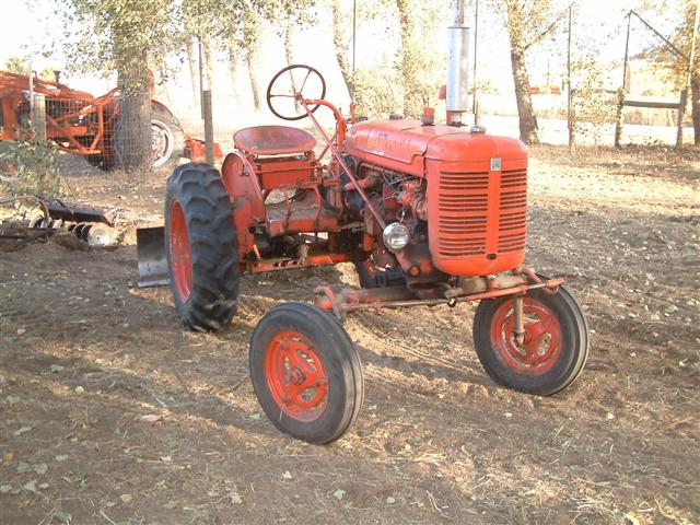

5-10 acres of row crops, huh. What you need in terms of a tractor depends on your budget, the time you have available for plowing, discing, planting, harvesting, and you're mechanical ability to service and repair your tractor.
Low cost route: there are tractors like my 1951 Farmall Super A that are designed for small row crop farming. I bought mine a few years ago for $1300, including a 5-ft rear scraper blade, a 6-ft mid mount sicklebar mower (great for mowing hayfields, ditches, etc) and a 3-pt hitch setup (normally old Farmalls like mine came with a 2-point hitch). Plows, discs, field cultivators, etc. are available (eBay, craigslist, etc).
It's about 18 hp (engine) so you will log considerable seat time doing your farming chores on this type of small tractor. Parts are readily available, not too pricy, but you need to do the work yourself or find someone who will do tractor repairs inexpensively to make this option pencil out.
High cost route: find a recent (10-15 year old) used tractor in the 30-40 hp range possible with a front end loader. Now you're up in the $10-15K range with FEL. You can get your work finished more quickly but working on larger tractors yourself takes heftier equipment (floor jacks, jack stands, engine hoists, etc) and more investment in time learning how to repair a larger, more complex tractor.
Good luck.
