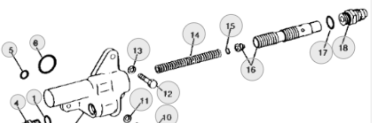

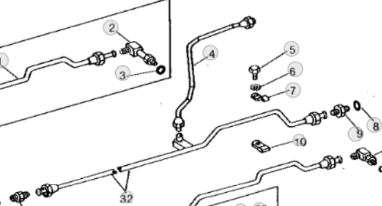

I have a john deere 1020 that has a loader that I like to put power steering on. I bought the priority valve on ebay and I can buy the steering column on line. looking on line on installing the power steering and can't tell if iI have the right pump on my tractor and also where to hook up the return line off the steering column, All pic on line don't show where the return line goes need help.....Thanks
   / Need help John Deere power steering #2
Power steering on JD utility tractors returned oil to trans case via a galley built into clutch housing. Pressure oil was supplied to power steering housing(key 4) via a pressure line from frt pump back to priority valve. Which hyd pump does your tractor have(.69/4 piston or 1.38 IN.3/8 piston)? I think your tractor probably has a 4 piston pump.

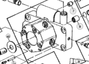

How do I tell if it痴 a 4 piston, and will a 4 piston work with power steering and a bucket. The md of the tractor is T4RIC. 086524T, can I tell by the md#and SN
   / Need help John Deere power steering #4
4 piston pump photo & 8 piston pump photo

An open Center priority valve is going to be a total mess on a tractor with closed Center hydraulics .
Find an entire 20,40 or 40 series tractor and swap parts to make it a 100% factory system.

To my knowledge JD didn't offer a priority valve for open center steering on 1020/2020,300 or 400 because it didn't require a priority valve because it was powered by it's own open center pump & remainder of hyd system was closed-center hyd's.
   / Need help John Deere power steering #7
That would be why I was telling the poster that an open center priority valve on a closed centre hydraulic system was not a good idea. I wonder why the adding of some aftermarket PS system that will cost more and not work as well as the factory system?
All that really needs to be done is to drop in a steering column from a power steering tractor . Connect the inlet to the HP hydraulics and drain the PS unit into the transmission case.
