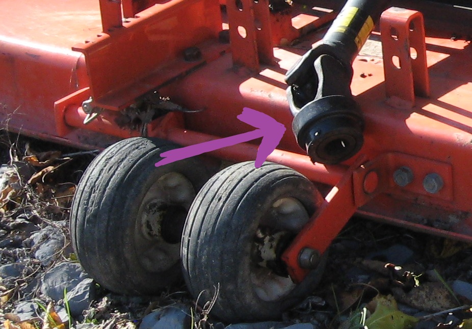

This is not your exact deck, but this is a representative collar you need to pull back to remove the PTO shaft.
   / Need help in removing 60" mower - NEWBIE
oh ok, I was somehow thinking that the part in the middle was what would slide. That piece is going to be on the tractor end of the shaft, not the deck gearbox, correct?
That picture helps immensely as the manual doesn't seem to illustrate where it is!
