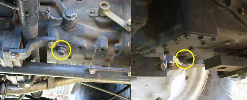

2. Hydraulic drains - The transmission and hydraulic system share a reservoir. There are two primary drains for that (picture attached).
