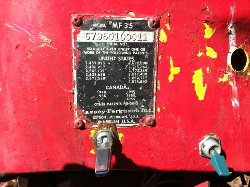

This is my first tractor and I'm having trouble identifying the year of this tractor since the serial number does not match anything I can find on the Internet. It looks like the original paint color was an industrial yellow. Does this model match up to an industrial version of an MF35? Anyone have an idea of what year? Thanks in advance

Welcome to TractorByNet. Can we see some picture of the tractor? Judging from the yellow peeking out of the red. This could be an industrial model which has a different sequence of numbers from agricultural models. Those numbers on your I.D. Tag doesn't show up as agricultural.

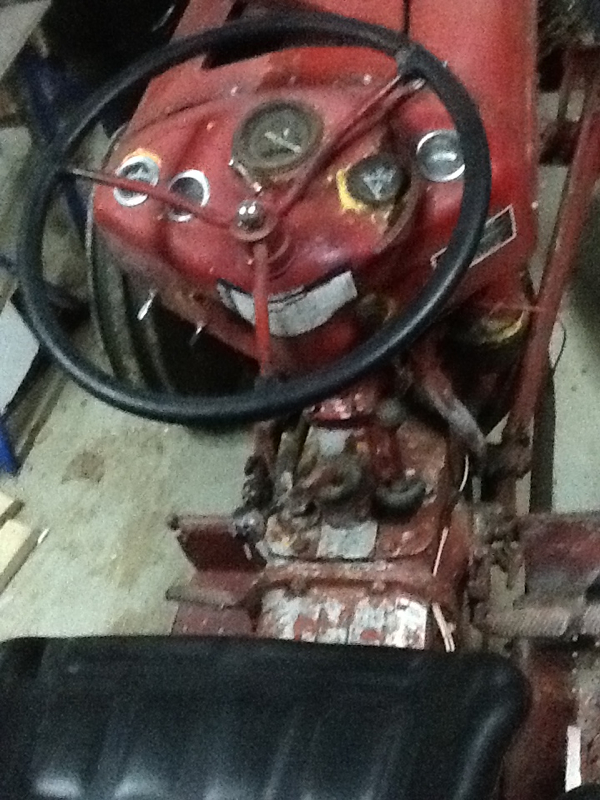

That's where I was struggling. The model number seems so far off from anything I've found. Here are some additional pictures.

The MF35 had embosed lettering and numbering over the entire tag. The embossing cannot be faked. The tags lettering is actually high pressure pressed into the metal. The backside is flat except for the serial number.The lettering and numbers are etched or stenciled on yours. Here is a picture of a real tag. Your tractor has a Z134 engine. The first two letters in your serial number should be SF(G) represents a single clutch. Here is one stripped down for comparison. -kid

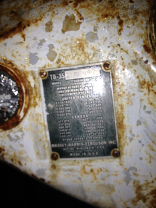

I dont know if its a fake or not. Other than the excess of numbers, it looks an awful lot like mine. Heres mine for comparison.

Andy, it looks like a TO35 to me. I just cant find those last 6 digits of the serial number listed anywhere.

The tractor serial tag is a key piece of evidence to idetify the make year of a MF tractor. Without it, one can only guess it's age. The engine I.D. Tag is located just behind the starter on a Z134 gas engine. With proper previous owner documentation would verify as to the tractors true identity. The serial number does not jive with the index photo i posted above. There is no doubt as to what type of tractor it is. The year is still the question. Without a hands on inspection of casing number, would only narrow to maybe within a couple years. I never could figure out the reasoning for not riviting that tag to the frame. Puting sheet metal screws to secure it only encouraged theives to remove them.

Ok, I finally had a chance to take some pictures today of a little better quality.
The last photo is the plate on the engine. It's been painted over and all I can make out is Racine WI. Is that where the Continental Z134 was made?
I've also found some more letters and numbers. On the back right side of the tractor near the hydraulic fluid dipstick it's stamped: H Ms 23 183253 M5 C 750.
On the left rear axle it's stamped: 183 251 M2 on the right it's stamped 183 248 M2
The other number I wrote down is: CWC 0202 Z134A500 A (I can't make out the next letter). But for the life of me I can't remember where it is on the tractor now.

How can it look like your tag when your tag is a "TO"35 two totally different tags.

The serial number is stamped into the metal tag on the engine block. It's not going to reveal the tractors true age. The other numbers your finding are casting numbers which represent part numbers. The Z134 number your referring to is probably on the manifold signifying an original manifold.

You told him that his tag was a fake and that was a fact! My point was that it sure looks like a real tag to me, looks almost identical to my T035's tag! Did you even take the time to compare the two? Maybe its not a "fake". Maybe you dont know everything about the 35's, but you been told this before so why am i even wasting my time writing this??????

I may me wrong, but if you take a close look at original tags you will see the detail made into them. Did you even read any of my post before posturing a negative stance. Let me explain to you in simpler terms. Your tag has embossed lettering. That means "raised above the surface". That can't be copied without expensive equipment and a huge hydraulic press to make that happen. Tags did change to flat metal design later in years. The years the "Mf35" was made the tags weren't flat. Even the overseas market. Also every website I've seen explaining serial numbers for the 35 says there are three letters in the beginning of the serial number. There is a reason for that which is explained on those websites. I believeI even posted a snippet of one of those sites to illustrate.
The tag maybe a manufacturer replacement, but the serial numbers don't work for for MF35.
http://www.tractordata.com/farm-tractors/006/0/4/6042-massey-ferguson-to-35.html see the link.
The tractor being painted yellow is either a 35X or a "Turf Special". Probably 1963 or 64 model.

And there you are. By all means please enlighten us with your vast knowledgebase. You seem to pop up just at the right moments. Please Mr. SIMassey. Please enlighten us as to what this mystery serial number is or are you trolling again. -the kid

Notice the shadowing on all the lettering and numbers on yours. If you where to look closely at Andy's. There is no shadowing thus the lettering and numbers are printed on. Can you not see that? My 135 is like yours. You can feel the numbers and letters. Now if Andy can show us another picture at a different angle might shed light. Your tag and mine is made that way to keep from counterfeiting serial tags. If you where to remove your tag and look on the back. It's totall smooth except for the serial number.
Here's closeup of my serial tag. Notice the raised lettering.
View attachment 314143View attachment 314144View attachment 314145
Your tag is the same way. Other MF35 tags I've seen are this way as well. TO20's too. This was my point. Also notice mine is a Continental Gas which is illustrated in the serial number by the first three letters. PJ, I'm not trying to start anything. This was an observation. The way the serial number is stamped and the way the rest of the tag looks is suspicious. The tractor "is" showing yellow under the red. Many re-painted them red. This is obviously a special edition tractor with a unique number or it's fake. It is NOT a normal number for a MF35. That is already documented. So it has to be a different version. -kid
