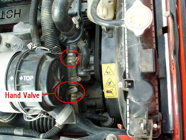

Hi Tom,
Hope that these pics may help you.
This one shows where the hose goes to Heater & a in-line hand valve to kill it in the summer.
Bird

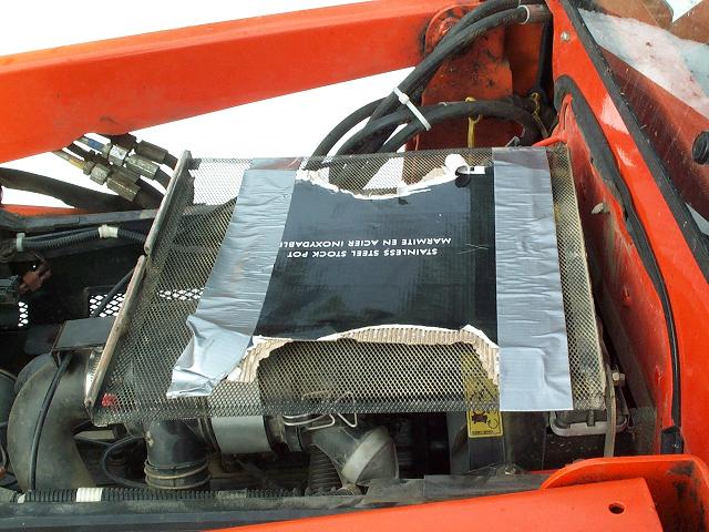

This one is not pretty, but good old duct tape does it again.
This is the area I had to block, to get it to heat up, but not to much /forums/images/graemlins/grin.gif
Bird

Bird,
Thanks for the pictures, it does help. Can you take a picture of the bottom radiator hose connection ? I know its a pain to get under the tractor, sorry, but it will help if the top connection does not work.
