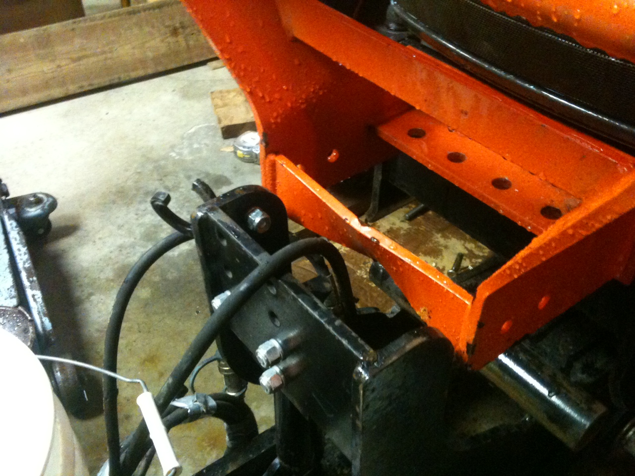

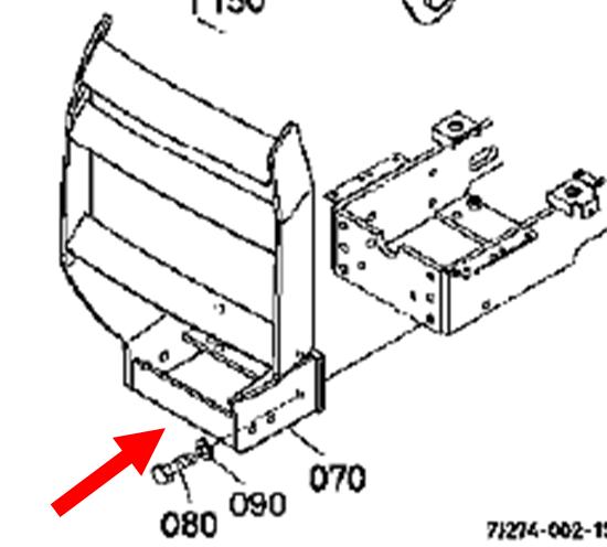

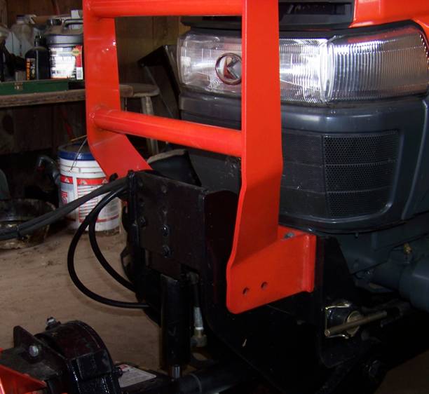

Those with front mounted snow blowers on L Series tractors. Reference L3130tractor and quick hitch L2180.
Do you still have the Grill Guard attached when mounting the Quick Hitch? I have seen pictures with the grill guard in place, but on my tractor there is interference (see photo). My grill guard has a metal support that prevents the quick hitch from going inside the grill guard (see attachment). Is there a different grill guard available for use with the quick hitch or does the grill guard has to be modified (cut the support bracing from grill guard).
I do not have instructions on how to mount the quick hitch and working blind, so I need your help.
Yes, I know I can remove the grill guard or cut the bracing off the grill guard. I just want to understand what Kubota recommends and what others had to do.
Just sold my rear snow blower and this needs to get on ASAP.

Remove the grill guard and reinstall it in the summer season as you want t protect the motor compartment anyway as a priority.
The snow thrower frame will not allow it to raise properly with all the metal in the way.
I think a lot this is because of the tire size and clearances as a narrow mudder crop tire and large diameter rim with a taller hieght has a greater ground clearance.
edit: once you remove the grill guard the quick hitch should mount directly in the nose of the frame with matching holes- be sure to use nylock nuts or the blue "Loctite".
edit: do you have suitcase wieghts that mount on the grill guard?

I had a sub-frame on a L3130(for a plow but same for blower),you must remove grill guard.Two bolts not a biggy.
/ Need Help. Front Mount Snow Blower Question #4
The smaller framed Grand Ls (3240, 3540, 3940) can have the guard attached but on my 4240 in needs to come off. If you are having problems trying to make it work, leave it off. Just put some anti-seize on the threads of the bolts since you'll be removing them twice a year.

Thanks for the quick response.
I ended up removing the grill guard, but it was frustrating as I spent too much time mounting the QH bracket and grill guard before hand. Only to realize I'd have to take it off. It is difficult holding both of these heavy parts and trying to get the bolt started. Used some ratchet straps from the raised FEL to hold both brackets in place.
I already have the grill guard removed and the front pins in the QH. Now I have to figure out how the back mounts and get the length of the QH correct... Then modify the fixed drive shaft. This QH came off a L4330 and therefore has a longer fixed drive shaft.
In a private message some one said they had to cut the bracket off the grill guard to make it work. I'll do that later when I have more time.
Oh, and anit-seeze is my friend.
Any tricks to mounting the back of the QH or adjusting to the proper lenght?

Yes, I plan on leaving the loader sub frame on. The subframe for the backhoe attaches to it. Let us say that with all the subframes under my tractor it is well protected.
2) This does not have the axle brackets. The rear is held in place by the drawbar (push it inward).
3) Floor jack in the front is a pain. It wants to slide off. If I can not use the hydraulics to lift it in place, I will make something or weld a detail on to facilitate lifting with a jack. At this point I just want to get it on.
4) I am good at modifying so the chamfer is no big deal. I just get frustrated when the design engineers do not think about how the customer is going to use it.

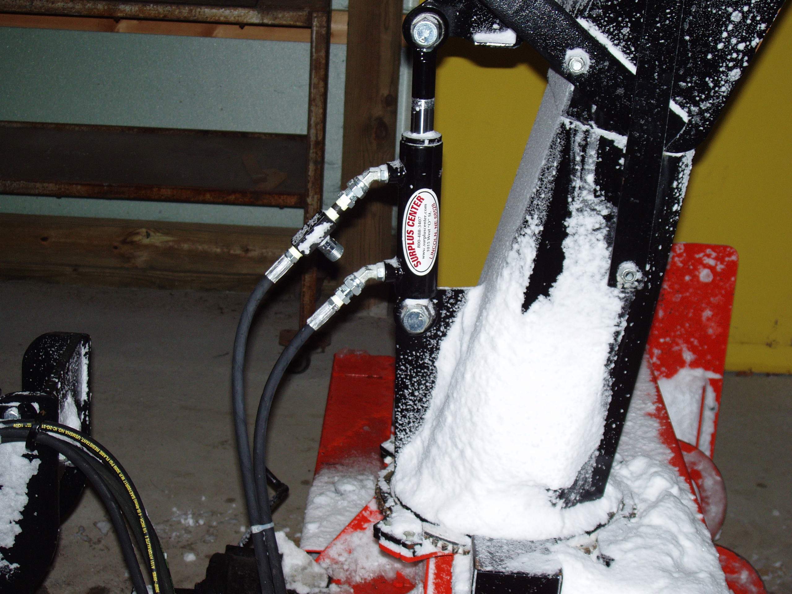

My chute is hydraulic.

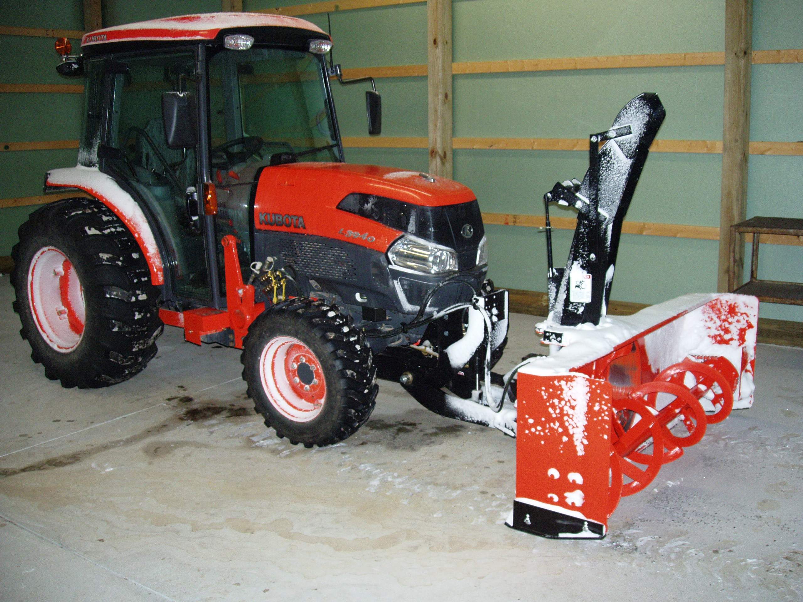

Blower is 6'

The driveshaft is cut to length and welded. Just waiting for the paint to dry. The electrical switch for the chute deflector is installed and the wires to the front are wire-tied in place.
Getting close, but need to do some other non-tractor activities.
