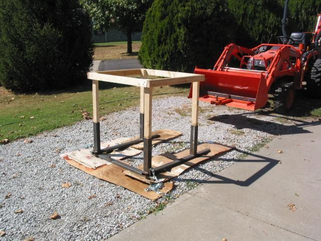

When I first joined TBN I saw this thread for a personal lift. I kept two pics but didn't know how to save the thread at the time. I've spent probably ten hours over the last two weeks trying to find it with no success. Here are the photos I kept. I'd appreciate any help in finding this thread. Thank You, Guy /forums/images/graemlins/confused.gif

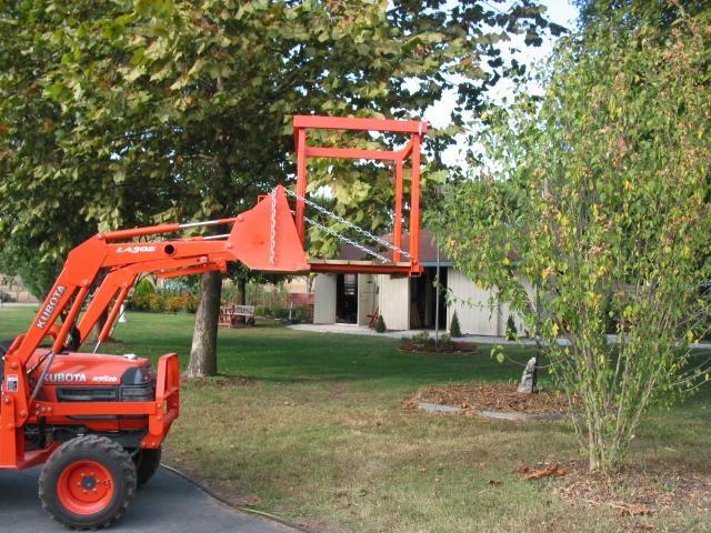

Second Pic

Coupla comments:
Shortly after I joined, TBN went down (hope I didn't cause it) and any posts I'd made changed my name to "Poster" or something like that. It happened to a lot of folks, so it could be lost that way. The post is stil there, but without a name, maybe.
I found a new way to save pics of mods and stuff I want to save. I call it "man lift" for example, and then include the name of the poster in the filename, so I don't have to go through what you are doing (been there, got the t shirt).
Finally, while that man lift would be safer than standing in a bucket, I think it is still very dangerous. One sudden move on the down stick and you will not like the ride.
I would not risk putting anyone in my FEL like that. And I wouldn't trust very many people to hoist me up that way either.
Just my two cents.
ron

I think you should do a test of your loader before you spend the time building the lift. Last summer I was on a lift on a brand new tractor and we had to have someone sitting on the tractor to constantly "touch up" the curl on the bucket to keep the lift level. Most of our compact tractors will leak down or droop pretty quickly with pressure. To test, I'd fill the bucket with material and raise it up to about 8' with the bucket close to level. Let it set and time how long it takes for the loader to droop. If it holds, your lift is a good idea. If it droops, your lift will require two people and constant attention to work.
Good luck with your project.
/ Need HELP finding post or poster !!! #12
The other thing you could do is add an orifice to limit the flow of oil in the lines. That should reduce the speed at which the cylinders would go down.
Of course, the downside is that it would be SLOW as sin to lower it when you wanted to come down.
I guess you could insert a manual shut off in the lines, so that neither the curl nor loader would leak down. You still run the risk of a line rupturing (ok, it is remotely possible), but it would guard against leak down.
A manual stop on the cylinder ram would be another option. If you look at tractor shows or fairs, any FEL in the air will have a safety stop in place.
I am not recommending this, just making an observation.
ron

Ron, your solutions all work, but they aren't completely safe and I don't think the manlift I rented last year was completely safe either. There's always some risk. If I was going to do this, I'd want something like the double piloted check valves many of us have on our toplinks/sidelinks from CCM. That is rock solid and is mounted in rigid piping. If a hose bursts, the cylinder holds rock steady. You have to apply pressure to one of the hoses to overcome the pilot pressure and then the cylinder will move at normal speed.
Of course, by the time you get something built with all the safety and functionality you need, you might as well go out and buy a used manlift for about $3k to $4k and be happy. /forums/images/graemlins/grin.gif
