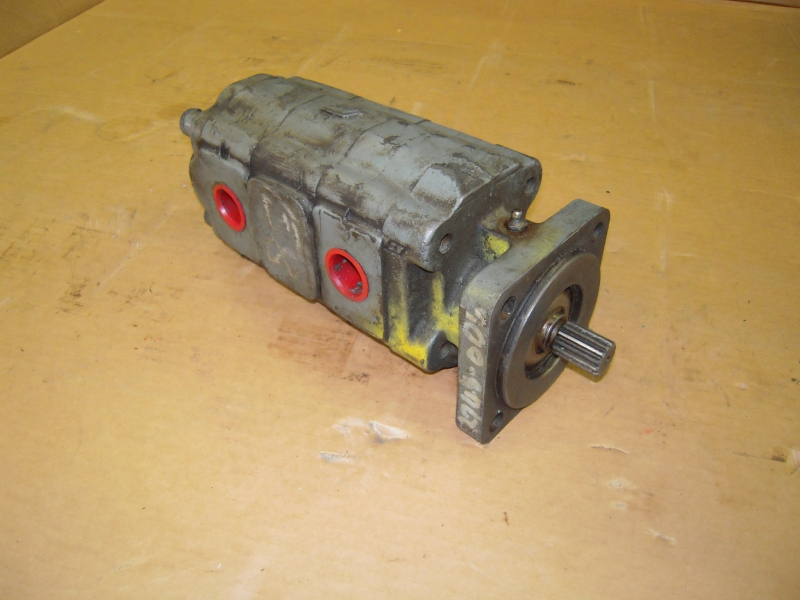

Thanks JJ, I was thinking that is what he meant but just wasn't sure. What is the best way to run multiple pumps off a single engine? I would assume you would have to run them off belts and pulleys??
   / Need help figuring out what this motor is...... #15
No, some of the grounds keepers machine, use three or four pumps piggybacked on a single shaft.

Silly me, I had been looking at multiple pumps and motors for days while searching for info on this big motor I have. It just never registered what I was looking at when I was looking at them.:duh:
I get cornfused when I start looking at the graphs and charts about input/output/gpm's@ this or that RPM of a pump as it equates to what the effects are on a motor, pressure??? gpm..... torque, speed it will turn a load. I guess the question I need to ask is if I have a 62.7 hydraulic motor designed to run @ 2000 rpm's what size pump will I need to hook up to it to get the full RPM potential and how do I turn those 2000 RPM's into the 5500 to 6000 feet per minute or what ever it is, needed to drive that 3/4 drive chain. Is there a chart somewhere to figure all that out?
   / Need help figuring out what this motor is...... #17
62.7 cu in is a rather large motor, and if you gave it 20 GPM, it would run at 74 rpm.
A 10 to 1 ratio would turn a shaft at 740 rpm.
To get 2000 rpm out of a motor that large, you would need about 550 GPM's.
The motor will run given about any GPM.
Motor torque would be about 24,881 in lbs, at 2500 psi.
I could visualize you using about 20 GPM for the log splitter.
------------------------------------5---------------hyd chain saw.
------------------------------------3---------------log lift.
------------------------------------3---------------log pusher.
------------------------------------3---------------for conveyer.
Maybe more, maybe less if using a pump for multiple things.
A pump or pumps needed to produce 34 GPM's using engine speed of 3600 rpm would have a displacement of 2.2 cu in.
HP required would be about 58.
If you need some help , go to the technical help here. Surplus Center
Use the hyd calculators in the left panel.
Surplus Center

This 2.31 cu in pump will produce about 34 GPM's at 3600 rpm and has a psi rating of 3000.
2.31 cu in PRINCE HYD PUMP SP25A38A9H2R
You would have to divide the output for different operations.
A tandem pump would be preferred for different flow rates.
