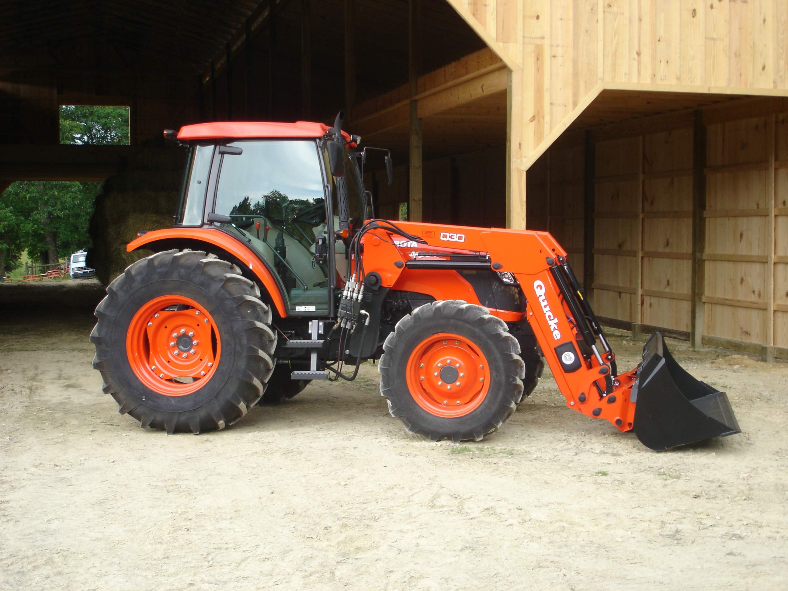

This is what I bought a few weeks ago:
I just bought a M9540, 4x4, Cab, 12 speed Hydraulic Shuttle Shift, 3 rear remotes (2 self canceling, 1 float) and Front Loader with 3rd function valve. I never had a FEL on a tractor until I bought a new tractor in 1997. This is the 3rd tractor I have bought since then and all have had front loaders. I also have a Bobcat to use around the farm and still bought one. I bought the FEL on my Kubota with the skid steer hookup and I am able to use all the attachments I have for my Bobcat on my tractor.
