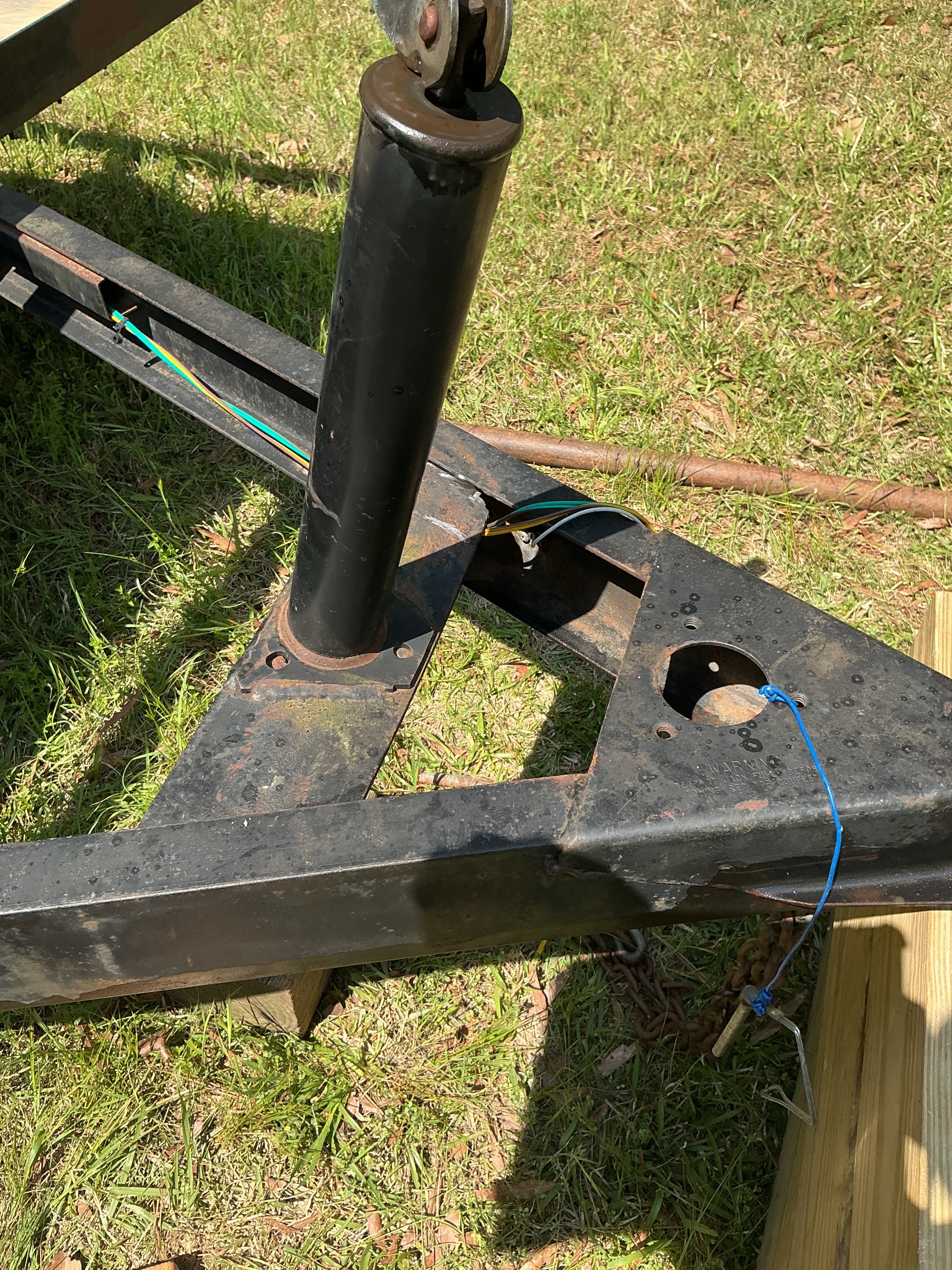

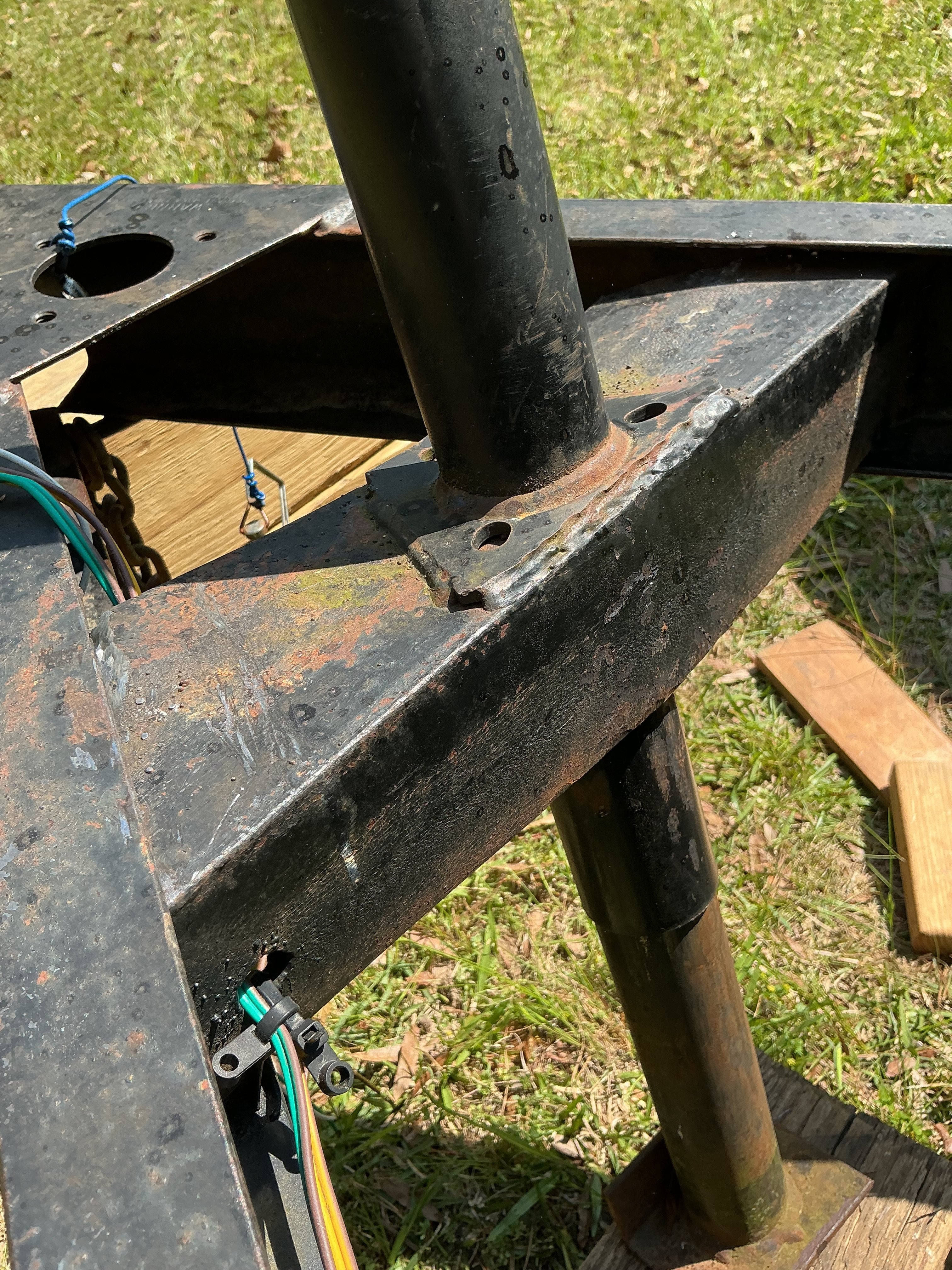

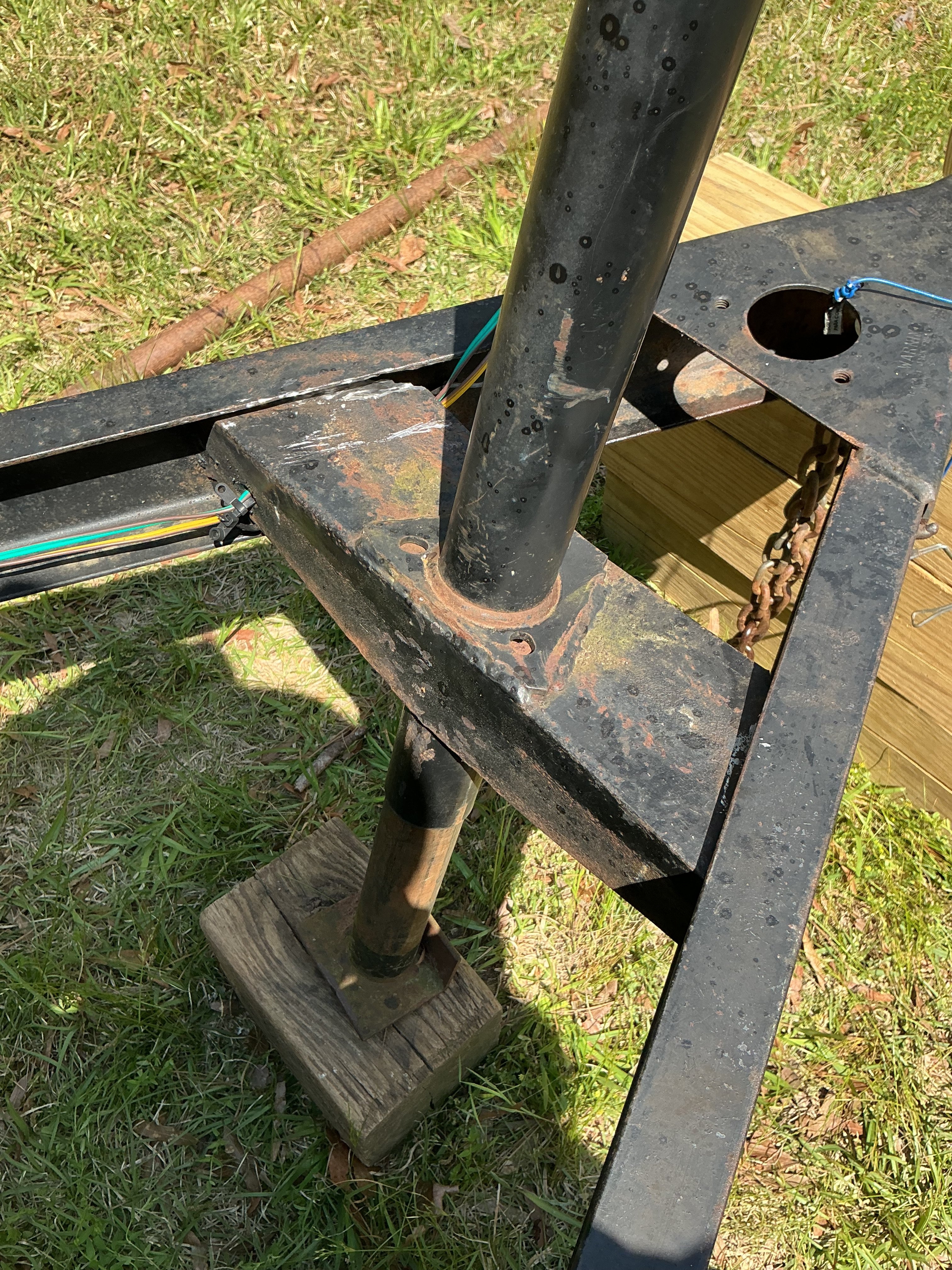

I bent my trailer jack by driving over a stump and the bottom of the jack hit the stump and bent the jack bracket backwards. I have been able to grind out the welds on the ends of the bracket and clean them up but I don’t know how to bend the thick steel bracket back to its original position. You can see where the front edge of the bracket has separated about 1/2” from the bottom of the side rail. I have beat on it with a sledge hammer, tried to bend it with a lever, etc but I can move it. Anyone have any ideas how to bend this thick steel bracket back? Thanks

It appears the entire angle iron is bent at the 90°. If you want it back original, I suspect you need to remove the jack, cut out the damaged angle iron and replace with a new section. Trying to bend it back to the original position is not possible while in that position due to "rebound" after contacting the frame.
FWIW, I used a 24' flatbed trailer for about 12 years with a bent jack mount and never encountered a problem.(lesson learned, raise jack completely) Looks is the only issue IMO.
Just be happy the jack tube isn't bent, or you'd be unable to use the trailer until replaced.

Since the angle iron bent, that face is now longer than it was before bending. It will not bend back into position. You could clamp it very firmly and then weld it, but it won't bend back to where it was and stay there.

Take the Jack handle off then slide a long piece of pipe over the jack. Push top of pipe towards rear of trailer.

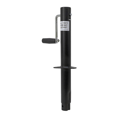

Don't bother. It's going to be far easier, quicker and end with a better quality product if you just cut it out and weld in new. Won't cost that much either. All you need is a couple feet of whatever size angle that is. Looks like 4x4x1/4" or so. If I were you, I'd remove that jack and replace it with one of these on the side of the frame. 2000 lb 10" Top Wind Trailer Jack Round Tube Northfield RD200-TWS-TMR-PZ [300134]

Ratchet strap or chain binder around top of tube & haul back to rear of trailer? If you bend the tube, you'll be looking for a new jack anyway, if it gives you enough leverage to lay in some c-clamps for the last bit then decent penetrating welds, you saved yourself the cost of angle iron ... lol. You always need more clamps & straps/binders anyway. A decent sized C-lamp might do it on its own, or if the tongue is heavy enough, a bottle jack under the angle iron posited to move in the direction you want. Not sure what all ends they have, but a cheap HF porta-power hydraulic body work bender would also get you what you want.

Why is this one on the side of the frame better than the kind I have?
/ Need help bending trailer jacket bracket #11
Why are these kind better?
Partially because you only need to crank it a little bit before pulling the pin and turning it 90 degrees to horizontal, completely out of the way.
It's also usable in other places, if buying/making more of the mounting tubes, such as supporting the rear of the trailer. Might even work for changing a tire but I've never tried doing that.

Personally, I'd just bend it back to vertical, being careful not to kink the jack tube because the worm drive's slug will hang up on the pinch point. The angle iron may bend in new areas as a result, but so what ? Just keep it vertical. It's a trailer, not a surgical bed frame or a Minute Man rocket's base thrust plate.

To bend it back you need to understand how that happened, then just reverse the forces. But having the attachment welds cut one side may make the easy fix impossible.(too much give and flex now) Just finish cutting it out and buy new side frame tilt mount. Amazon $60 for a Bulldog

How do you attach this to the trailer. Do you have to weld a small piece of pipe to the side of the frame and then this jack slips over it? Hard to tell from the pictures.

I would use 2 come-a-longs and 2 straps. Choke one strap at the top of the jack and winch to the back of the trailer. Also, choke the other strap at the bottom of the jack and pull to the tow vehicle's frame/axle. Using both at the same time should easily pull it back to position.

The picture looks like somebody has been cutting the crossmember free from the main rails. Am I seeing that wrong?

That's the basic idea, but the jack comes with the piece of tube that's ready to weld on. It allows you to rotate the jack up out of the way, in a horizontal position, when you're not using it.

Well if I was gonna abandon that jack, I would just get an a frame jack and bolt it in the other hole.
