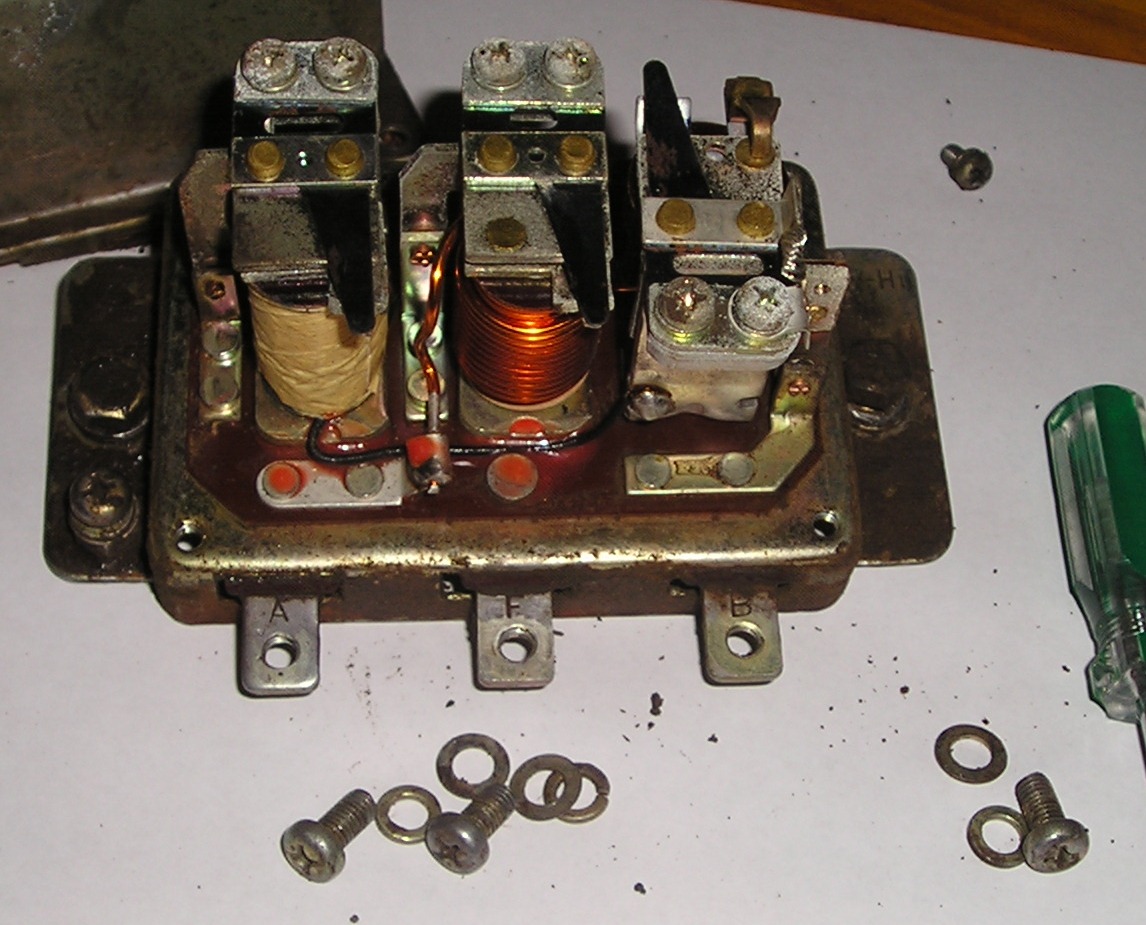

Here are the pictures of the current non-functional regulator. As I was taking the pictures, I started wondering...
What if just the diodes were bad? Can they be replaced? they've got numbers on them, but you can't quite see it in the picture. Could I bridge them and see if things started working?
Also, as you can see from one of the pictures, there are three tabs in front...A F B. Presumably, two would come from the generator and one would go to the battery. B= battery...could it be that simple? What would A and F stand for? How would I know (guess) which posts on the generator they'd correspond to?
Thanks in advance,
-Steve

I don't think there are any diodes. The things under the can are relays and the spiral things under the bottom are wire-wound resistors.
I gave you a load of semi-technical junk in my previous post. Bottom line for most of us: If someone can come up with an off-the-shelf, general trade unit that has worked on that tractor, I would try it for a reasonable price. If not, go alternator.
Oh, A=Armature, B=Battery, F=Field; most probably.

/ Need help--adapting a generic volatage regulator
BTW, the numbers on the resistors (that you can't really see in the picture) are as follows (top to bottom): 19, 10, 32

Ashas been said.. a=armature.. f=field, b=battery.. case may be ground.
No diodes in mechanical vibrating contact relay.
Mechanical voltage regulators generally fall into 2 categories.. A circuit, and B circuit.. and don't be surprised that some genny and alternator regulators will work on either unit.. genny or alt.. etc.
You need to decide which circuit it is... A or B
A circuit: regulator field tab provides 'ground' to the field coils in the genny.
B circuit: regualtor field tab provides 'power' to the field coils in the genny.
start tractor,
If reg type is's unknown.. start testing it. Grab a test lamp with a gator clip... hook clip to ground.. poke test probe to f contact on genny
jumper arm to battery... this bypasses the cutout.. if the ampmeter registers a charge when you hit the probe to the f tab ont he genny.. it is a circuit. if nothing, then hook gator clip of probe to battery hot, and then poke the f tab ont he genny again... if the ammeter registers a charge, then it is B circuit.
You don't mention.. but i am guessing 12v?
While you really should find what value the field coils are.. if it does turn out to be a 12v B circuit unit.. just grab a regulator for a ford diesel hundred series tractor... they will be 12v b circuit regulators.
I'm surprised that your repair shop couldn't have sourced parts for you.
I have an old hitachi alternator on my yanmar 1700.. it uses an old style chrysler regulator onit.. works fine...
Post back if ya need more help.
gennies are fairly bullit proof...and fun to work on they either need field power.. or field ground.. just depends where the field coils are hooked up internally ( to arm or case.. )
Remember to unjumper/bypass the arm / battery connection after your test.. otherwise the genny will discharge your battery..

Hi Soundguy...you got me thinking and reasearching and I found something on a different forum.
Yesterday's Tractors - Discussion Forum
Heres a quick check on the regulator. Flip it over.. look for the bias resistor.. An A circuit regulator should have a bias resistor between the field contact and ground on the regulator. On a B-circuit regulator there should be a bias resistor between armature and field.. there may be other bias resistors present.
Sound familiar? :)
Anyway, I did just that, and I'm pretty sure it's a "B circuit". The picture I uploaded at the start of this post doesn't label it, but the tabs on the right are the field and armature.
Thoughts?

That's my post you are quoting from ytmag..... and it generally hold true. Your reg is a bit more hi tech than the old ford regs that use only 1 or 2 bias resistors.. however.. my 'bet' is that it is b-circuit as well.
Once you get the tractor started, it will be easy to check. Wire it all back up to the reg.. start tractor, hook up gator clip to power, and take the probe of the test lamp and hit the field tab... if the ammeter doesn't go + then jumper arm and bat and repeat.
Also.. I didn't mention it.. but gennies and regs need to be polarized.
B circuit polarizes by jumpering bat to field momentarilly.
Uh.. don't do that part untill you figure out if it is really B circuit. Jumpeirng bat to field on an a-citcuit reg can burn field points.. faster than a nats wings..
Soundguy
