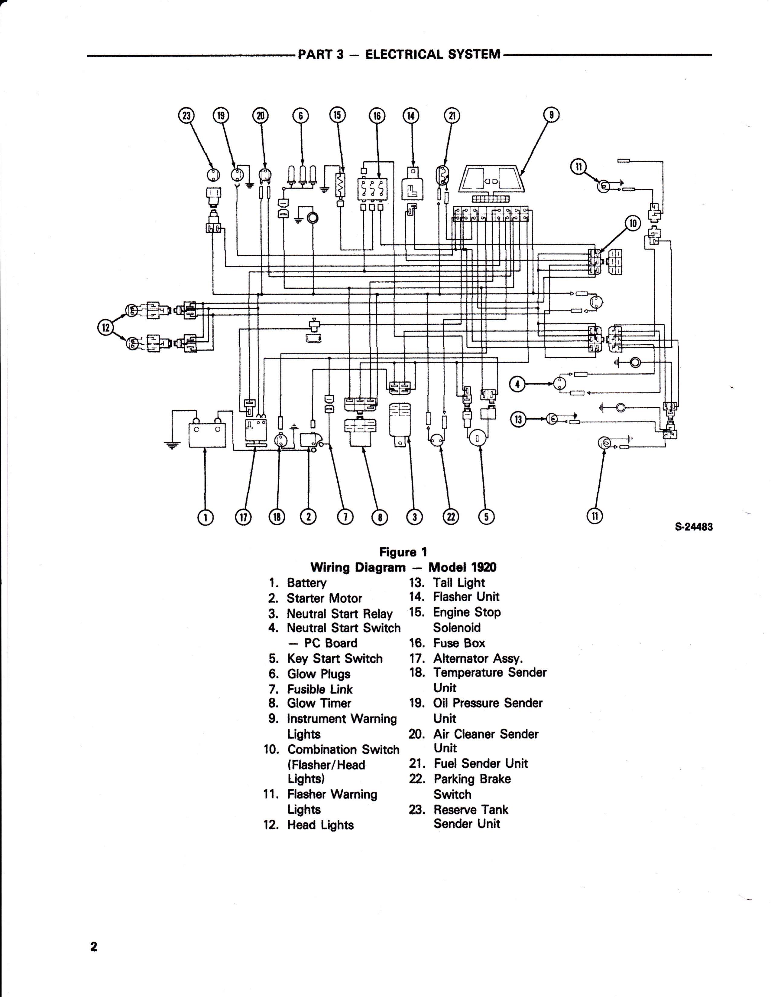

I would leave the temp unplugged install a new fuse link, tank gauge and sender and see if they work. The temp sensor probably saw no excess current just shared the same voltage source. Can you find the wiring schematic online somewhere, if so post it that way I won't be guessing. What I've found is that not everybody wires stuff the way we do. Working on a late 80's CNC machine Kitmura taught me that.

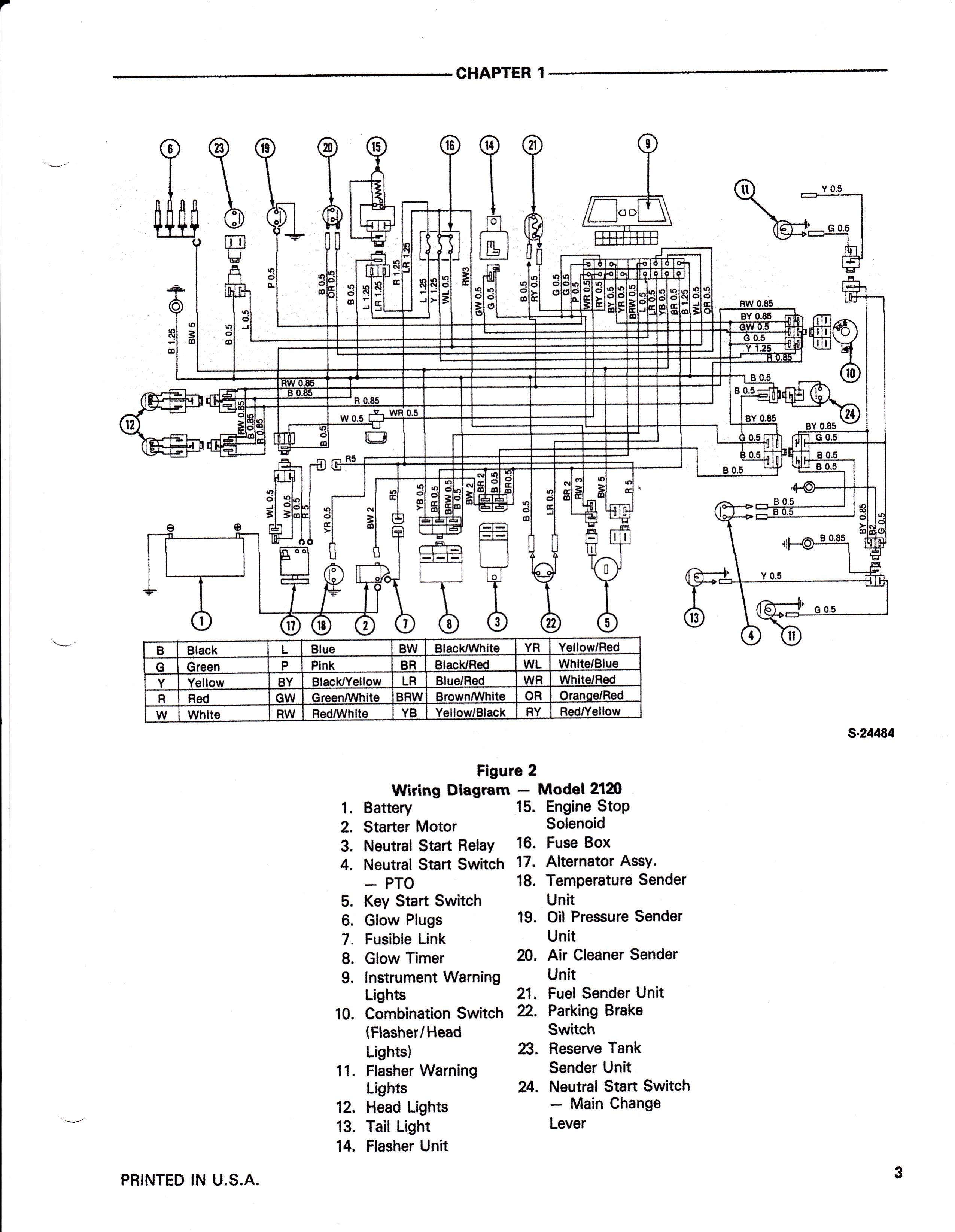

My service manual covers the 1920 and 2120. The wiring diagram for the 2120 is color coded so I've been trying to match colors to the 1920 diagram. One thing is strange, the 1920 is a 4 cylinder but the diagram shows 3 glow plugs.

   / Need guidance on why my fuel gauge got scorched #14
Both circuits show the voltage source is shared with a headlight circuit, and then into the dash, without any diagrams of the dash. Both circuits show the temp sender is ground loop with supply from the dash. If the temp gauge fails to work You may have burned connections in dash panel. So a shorted fuel sender could have eaten the dash circuit

#15
Thank you for taking the time to analyze the wiring diagrams. I read your post several times while studying the schematics. When I get the new fuel sender, I'll install the new sender, fuel gauge and fusible link....and hope for the best.

I ordered a new fuel gauge and fusible link. I want to make sure there aren't any other issues going on that could affect the new parts. After work my son and I pulled the float and checked the resistance as it moved. We had one probe on the positive lead to the sensor and the other to a good ground. As the float was moved the resistance would increase for an instant then drop back to 0.11, which is where it started. As I'm typing, I think we might have been on too high a scale. Were we checking the sensor/float correctly? We'll recheck it with the meter on a lower scale. As always, I appreciate the help.
You check of the fuel sender is incorrect. You should be checking resistance between the two leads of the sender. There is no hot leader to the sender it varies the resistance to ground for the sender. Your ohm meter should be set on the lowest scale it has. As the float arm moves the reading should make the needle move. From the diagram it looks like circuit 05 a black wire is a common ground for most of the circuits. The big copper coil on the back of the gauge is a resistor that was crossed somewhere. The mystery is where.
