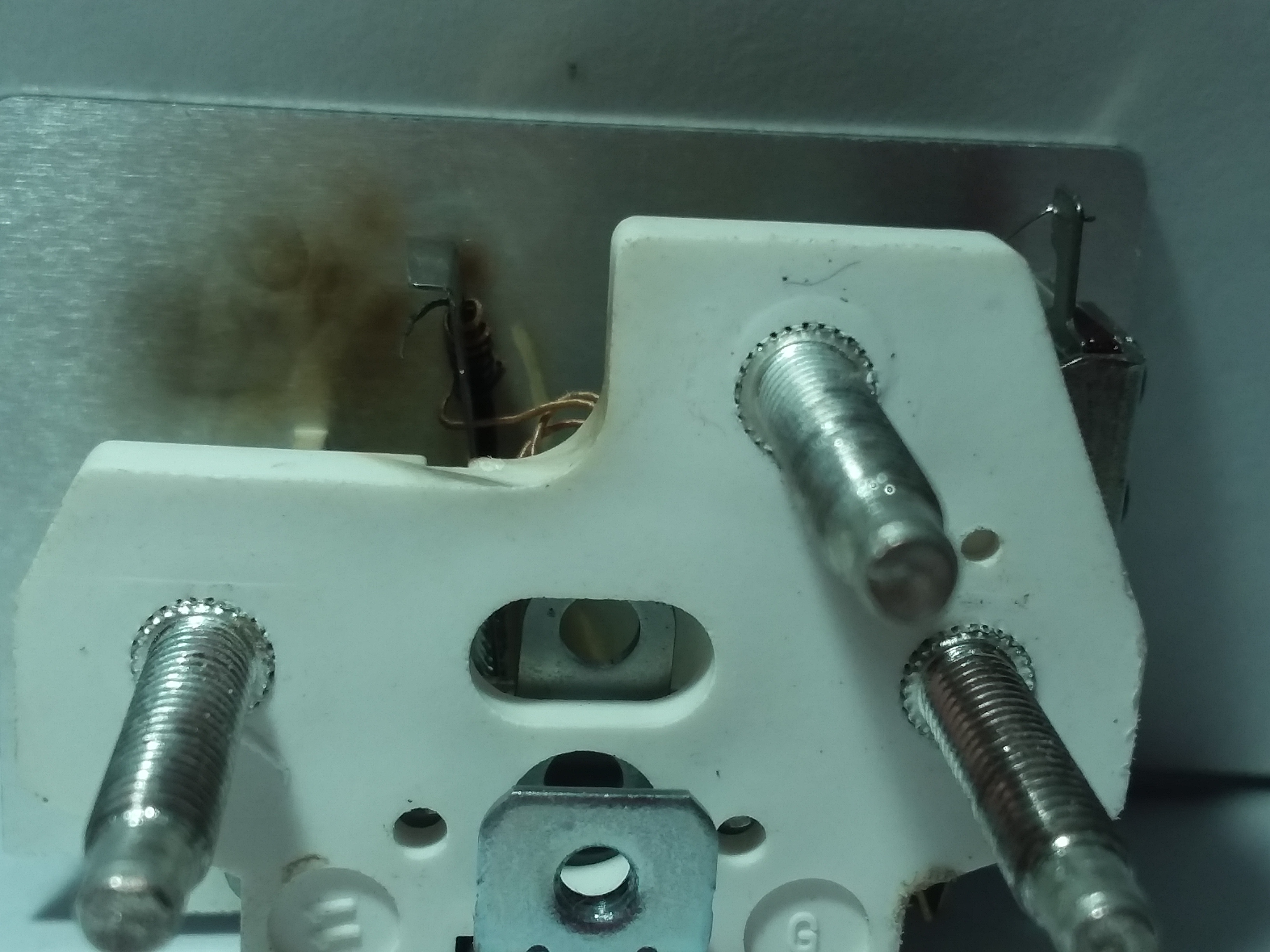

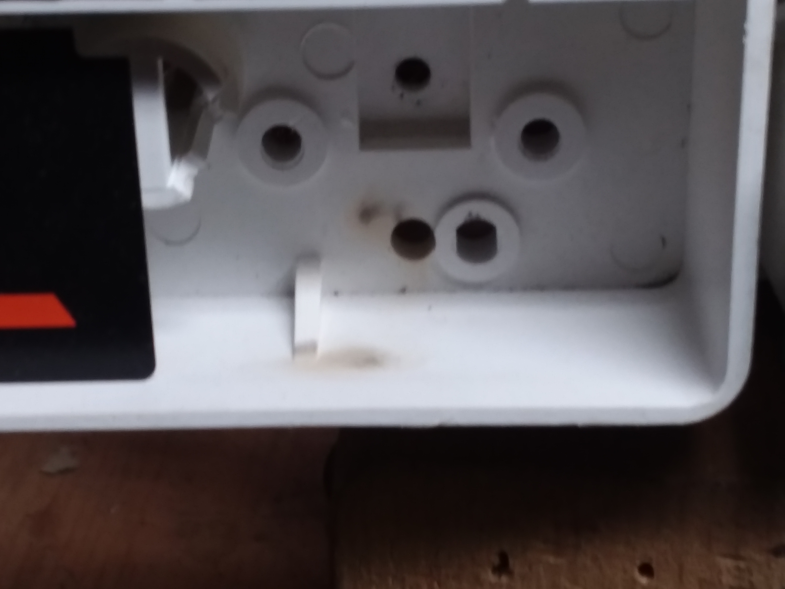

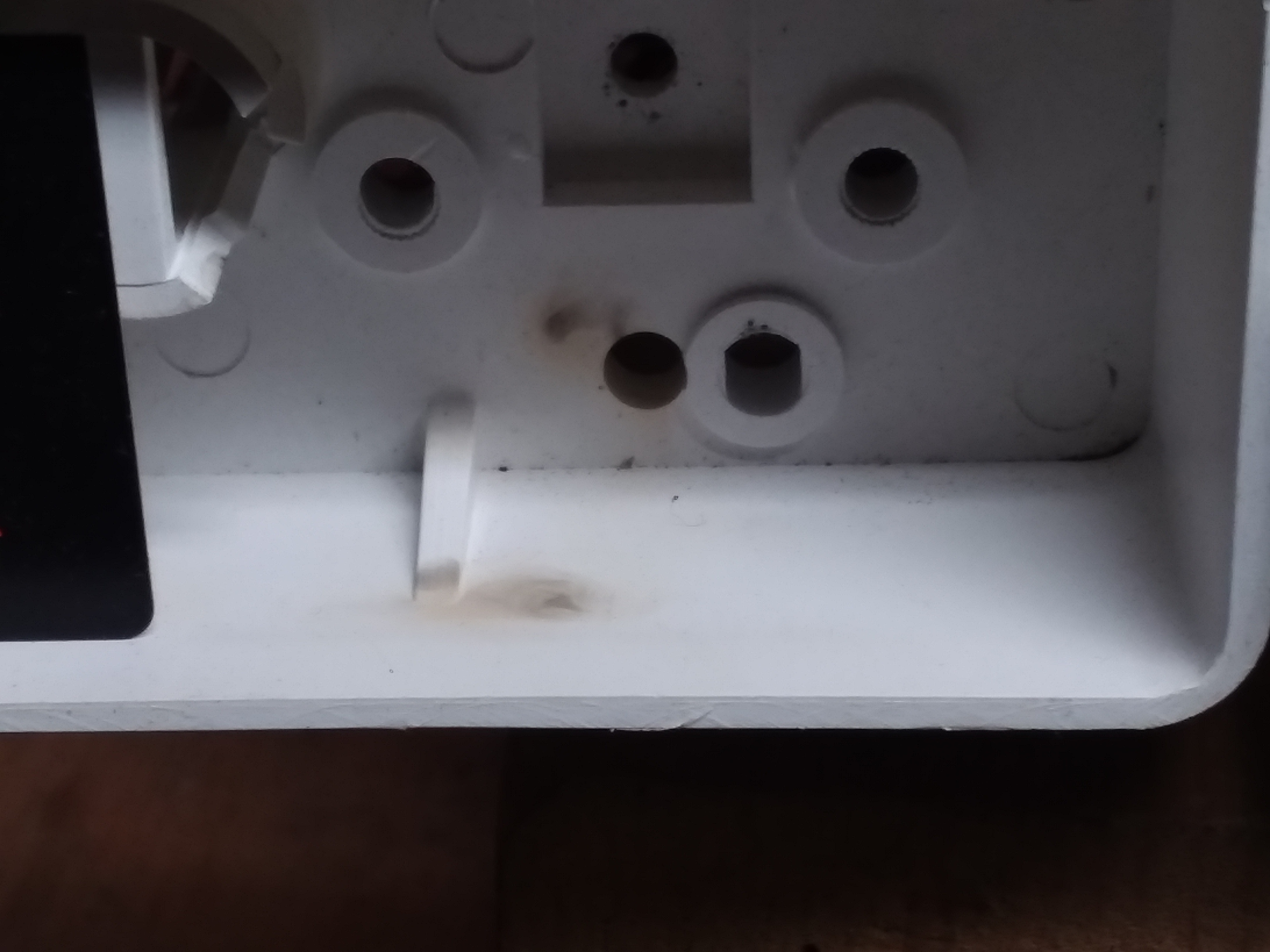

Things were working fine until earlier this year when the temp and fuel gauge stopped working. The needles were on C and E respectively. A couple weeks ago the fuel gauge needle "disappeared'', it was pegged to the left as far as it could go. While removing panels to find the source of a leak Advice needed on leak (I'll have an update on the leak tomorrow) I figured it would be a good time to work out the electrical bug.

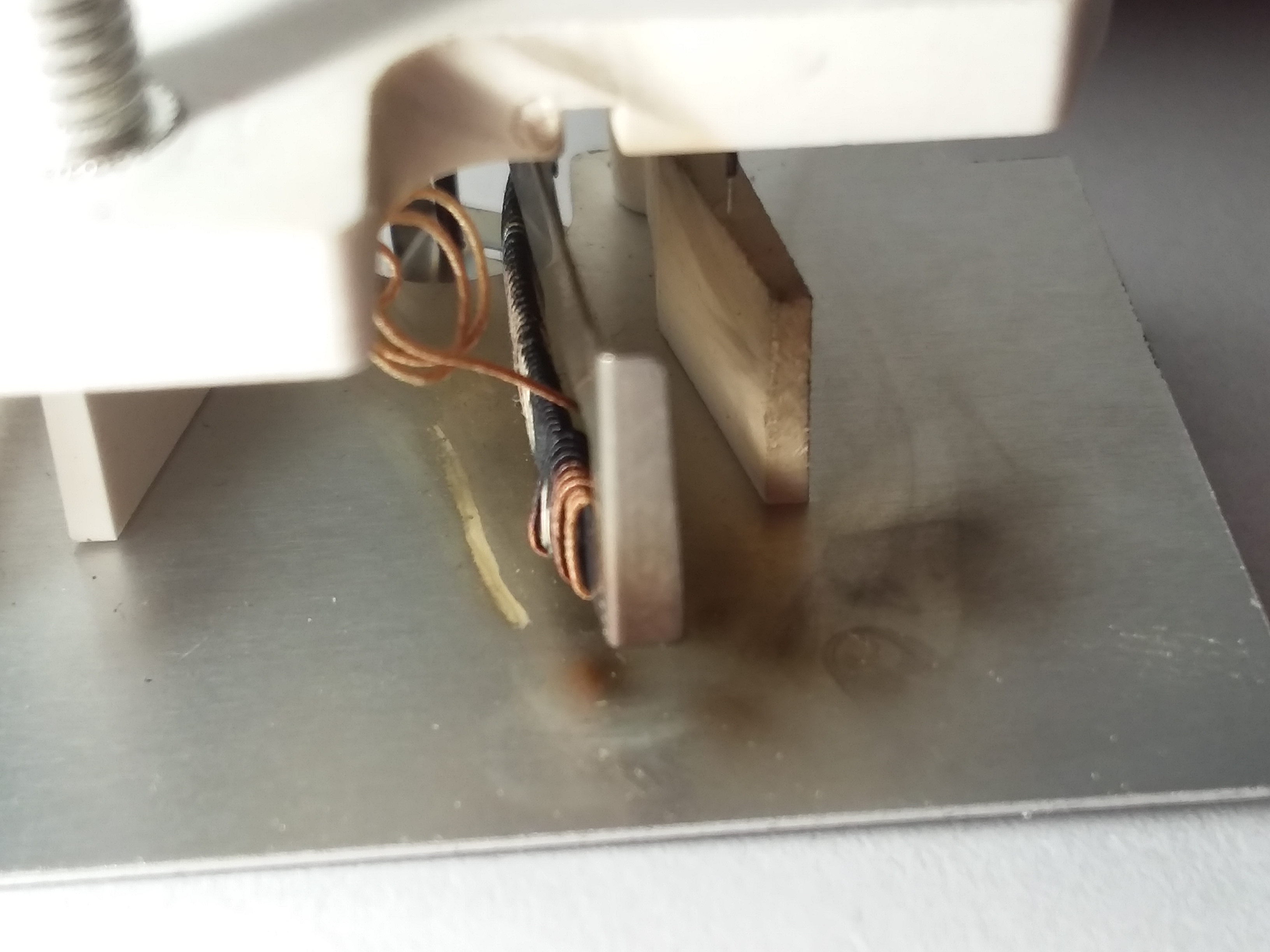

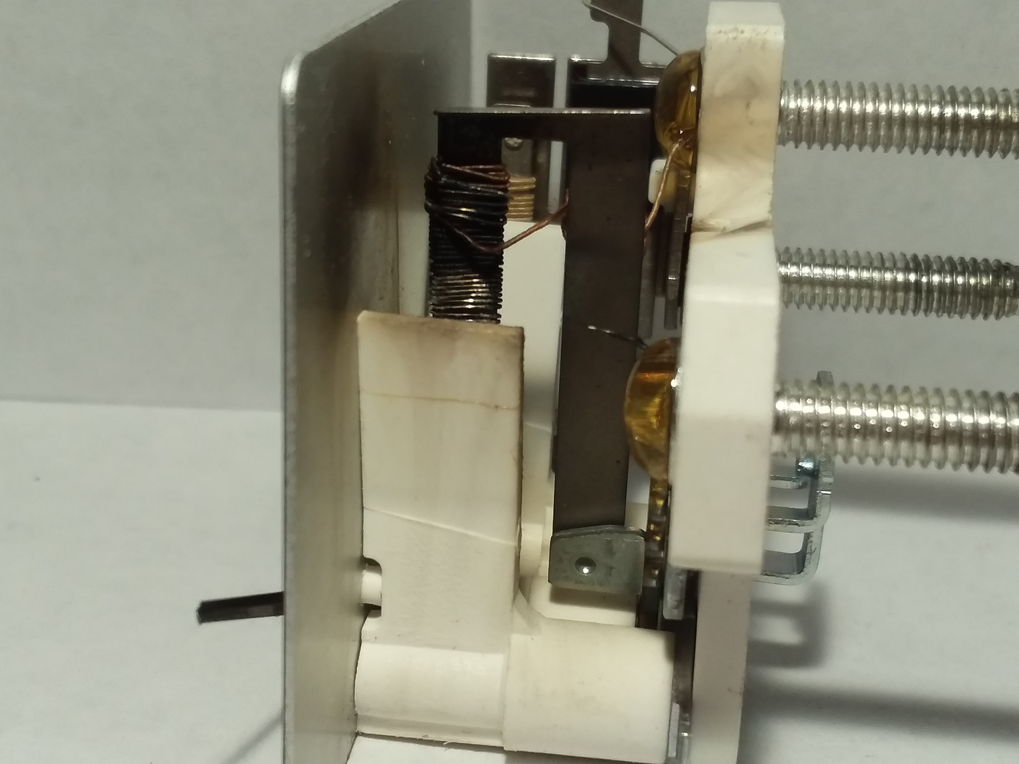

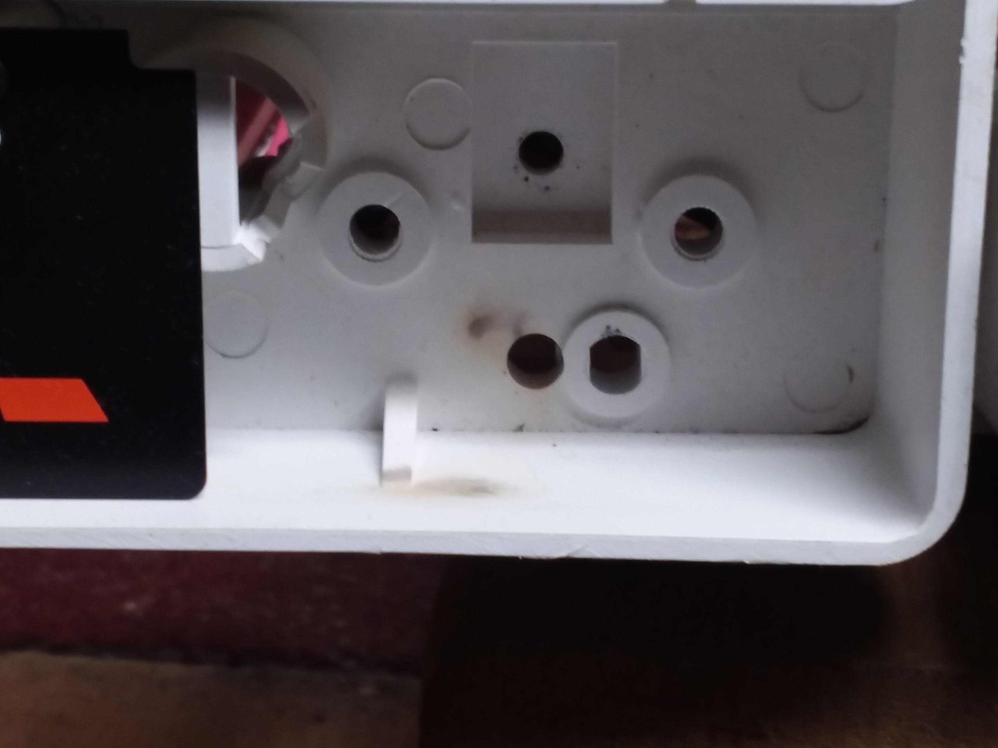

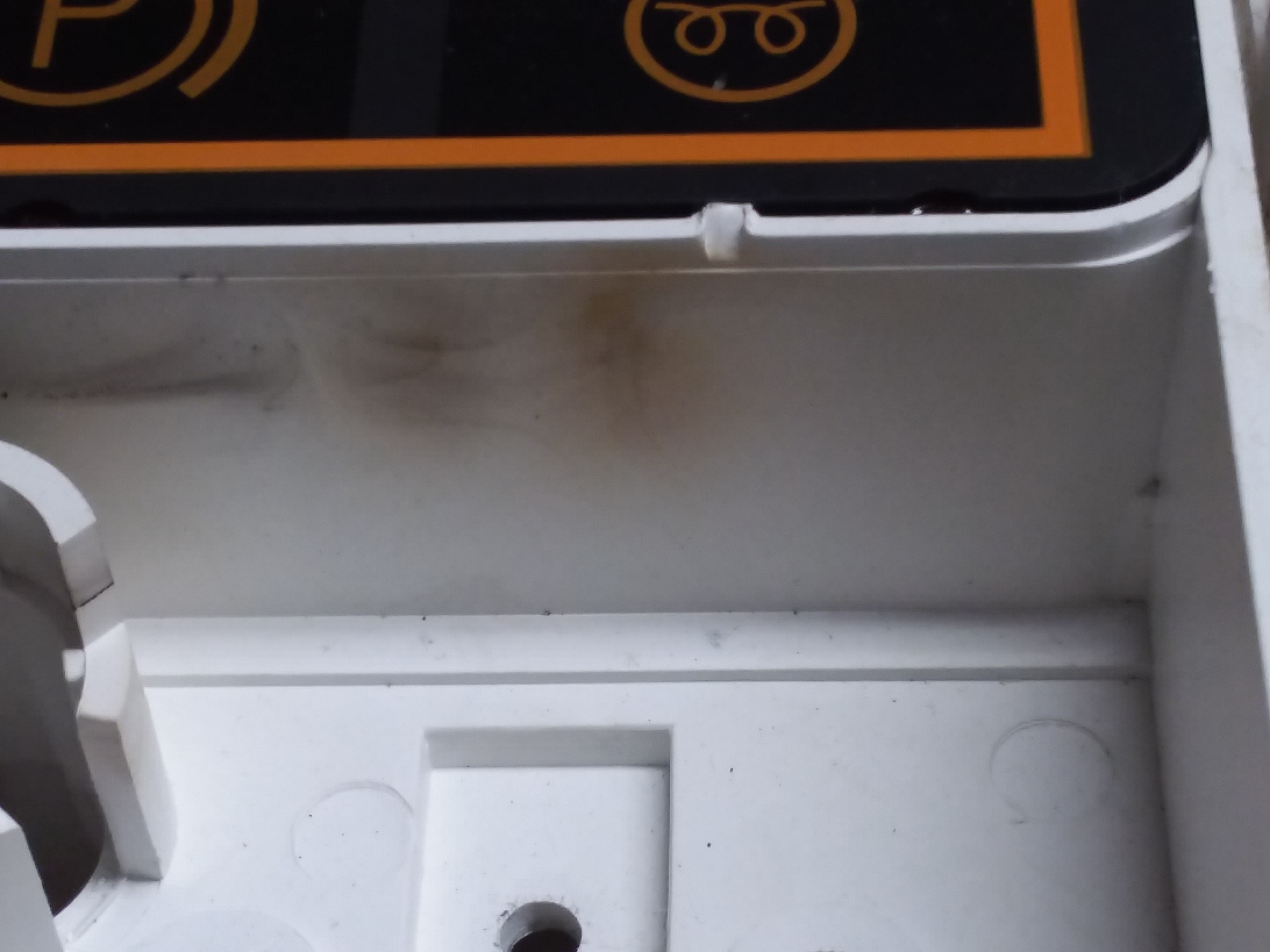

My electrical troubleshooting skills aren't the greatest, but I checked continuity from the affected sensors to the back of the gauges to make sure no wires were broken. Everything was ok. I took the fuel gauge out and the back of it was burned or scorched, not severely but enough to be noticed. There was a wire in the gauge that was broken. The meter housing was also lightly scorched. I took a few pictures to clarify.

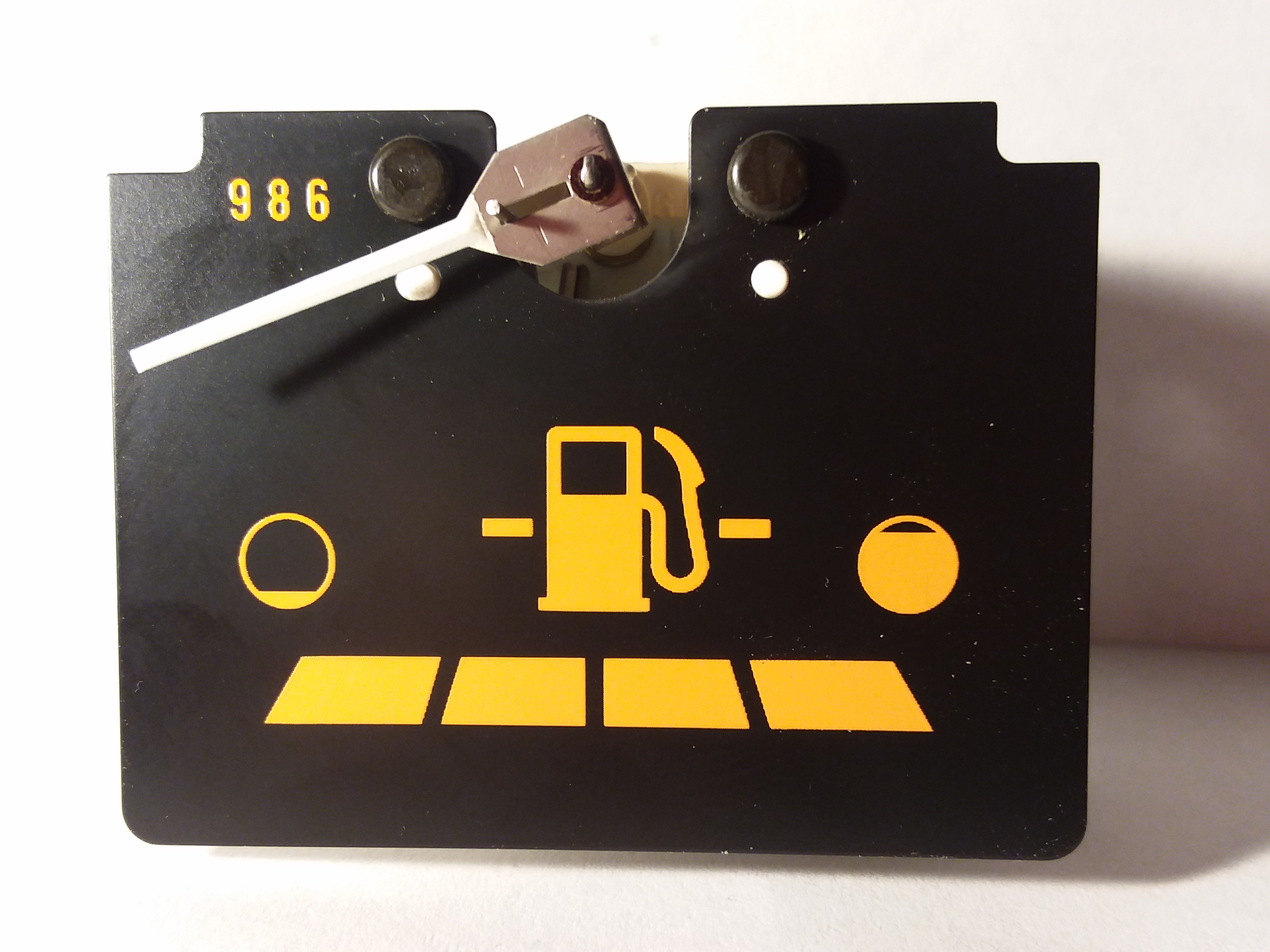

The middle picture in the second row shows the broken wire and the copper winding that is black. The front view of the gauge shows the needle pegged past empty. The other pics show different views of the scorching.
I don't want to buy a gauge until I resolve the underlying problem. As I stated my electrical troubleshooting skills are not very good, so I'm asking for any advice or guidance on how to determine what caused the gauge to get fried. All help much appreciated. Thank you.

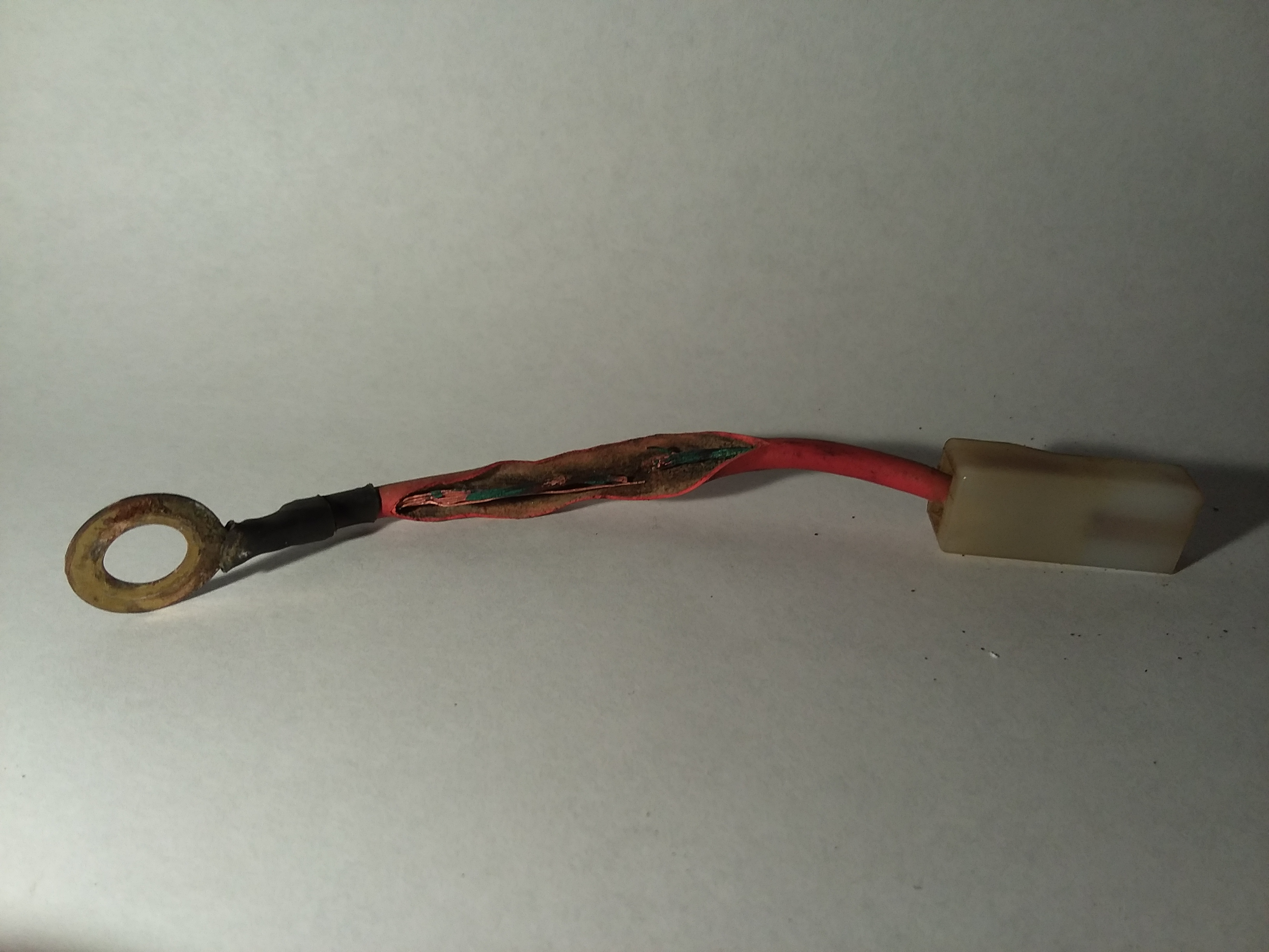

Rick, I checked the continuity of the grounds, they all were good. While tracing wires, I noticed the fusible link was being held together by 2 strands of copper. As I mentioned I struggle with my electrical diagnostic skills so I have a few questions.
Would the fusible link have an effect on the gauges in question?
What does the fusible link protect?
It doesn't appear to be chewed. What would cause it to "blow"?
The last remaining strands of copper broke when I was removing it.
Thank you

   / Need guidance on why my fuel gauge got scorched #4
Yes.
Everything electrical except the starter motor.
High amperage draw and /or a short circuit.
   / Need guidance on why my fuel gauge got scorched #5
Without being able to see the circuit we have use logic. Obviously too much current passed through the gauge, which to me means the rats shorted the lead to the tank gauge sender. So you need to measure resistance sender from empty to full like 80-230 ohms. Replace the gauge and the fuse link.
