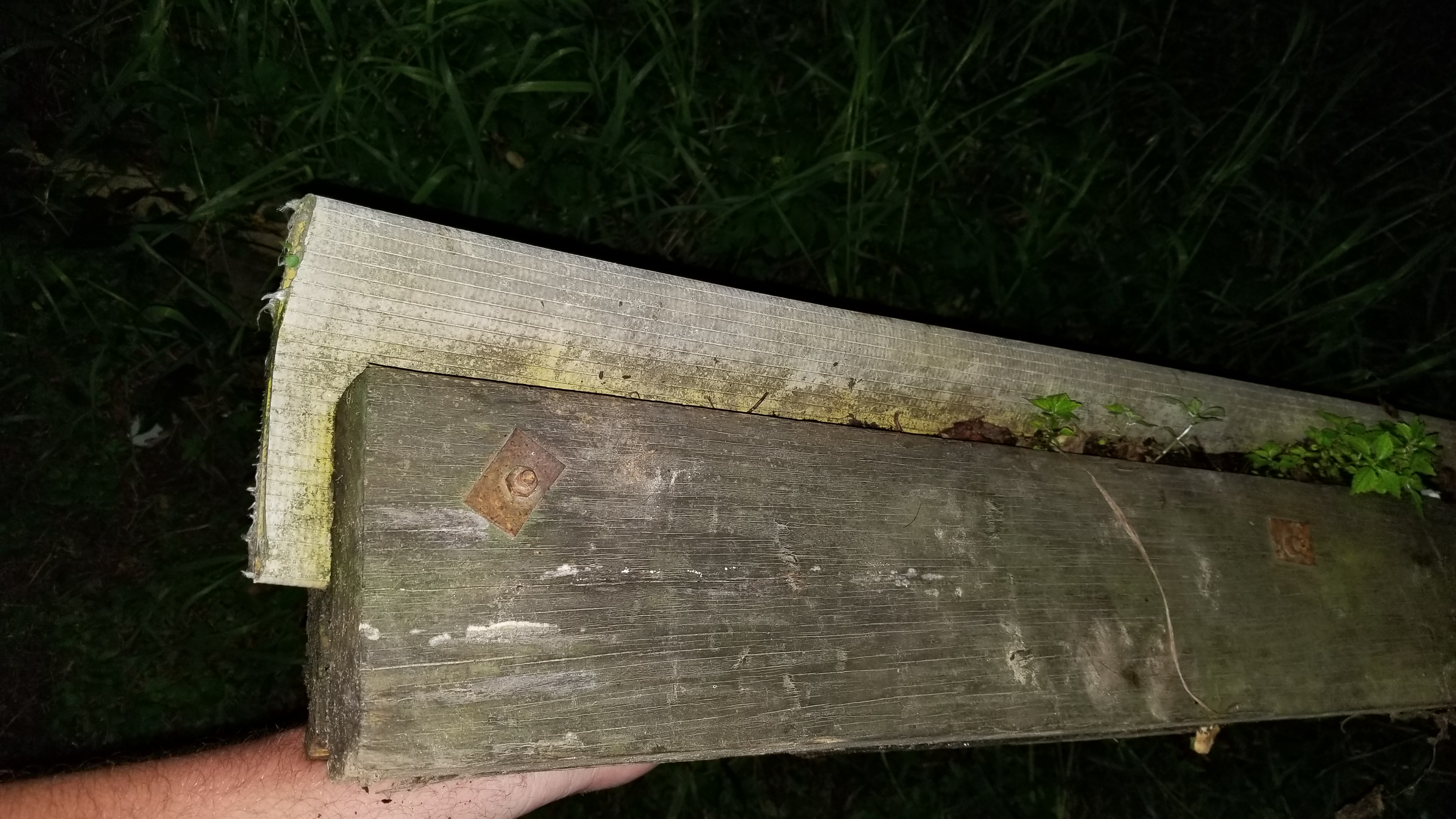

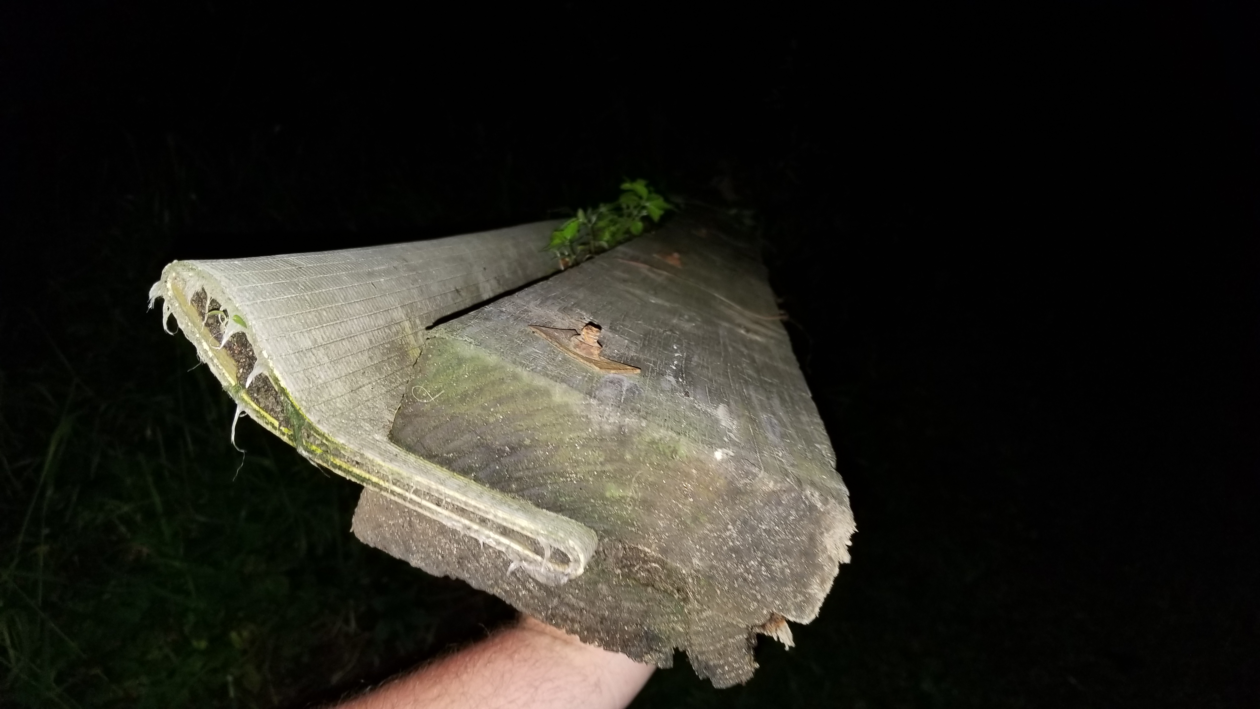

Avivii you got pictures of your water bars?
This is an old one I took out when we were starting to re-grade the driveway
Sorry for the bad pics, but I didn't get home until late tonight. Theres not much too them, so you probably get the idea.

I would love to hear thoughts on what I see are issues with the water bars / troughs... For me, there is no way to grade the road once installed, nor add any top material, and with the troughs, it looks like it would be fllled up in a matter of weeks with material.
I have a potato pllow and I just cut trenches in the road once a year in the fall, by the springe material has filled them up and I grade the road smooth. Our driveway is very steep (20 degree grade) and water is an issue as we get 70" a year or so.

I only see troughs working if the driveway traversed a slope and there was water constantly needing to cross.
The water bars I made work well enough, but they do take some mx. The point really was to slow the water down and keep material from washing down the driveway. If there was a heavy rain, I'd have to clean the material off of the uphill side as it would build up and wash over. We put in a drainage ditch with 4" perforated pine and crushed stone that crosses the top of the hill and drains parallel with the driveway, so the water bars are there mostly for any water that falls on the driveway downhill from the trench.
For the OP, water bars would be a cheap experiment, but the area you are trying to keep dry is just too low it seems.
