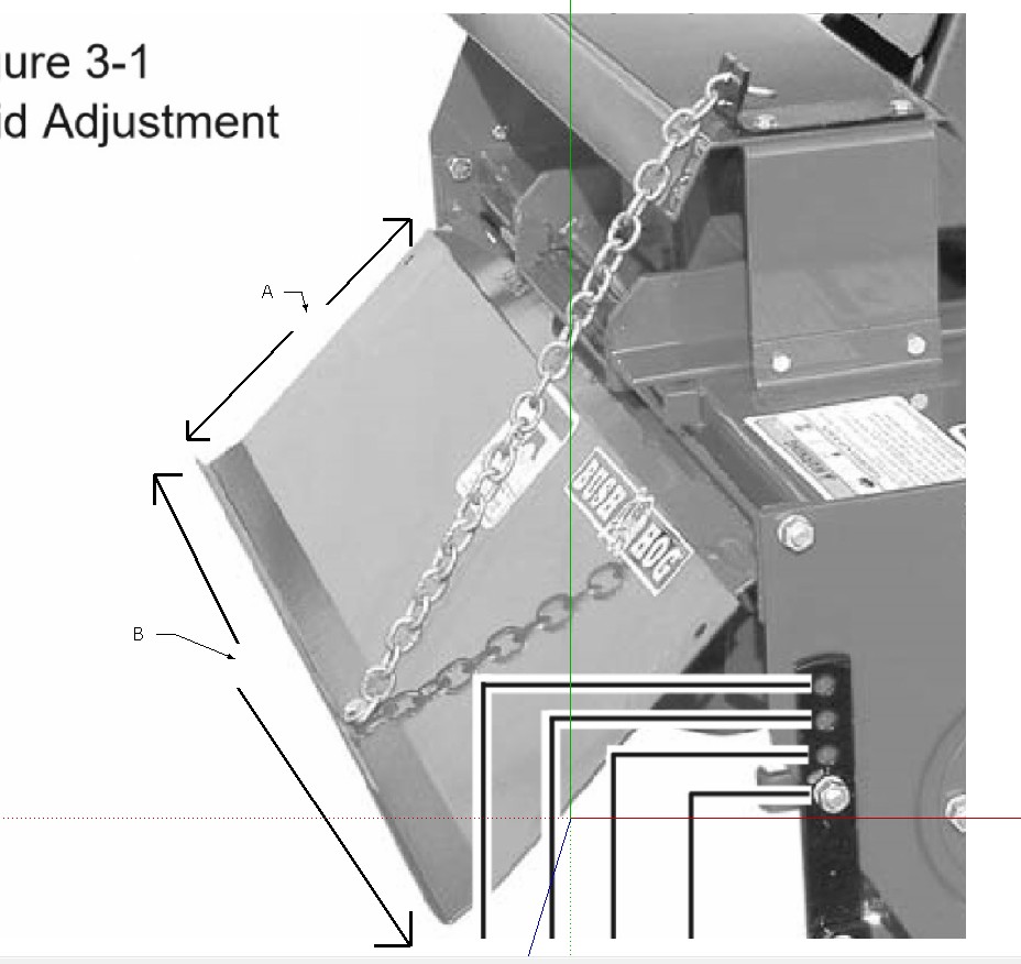

I picked up a used Bush Hog tiller but it's missing the back deflector shield. These are no longer available from Bush Hog so I would like to try to make one. Can someone please provide the rough dimensions if you have that available? Thanks in advance. ScreenHunter_02 Dec. 24 14.40.jpg
   / Need Dimensions for Back Sheild of RTS62-04 Bush Hog Tiller #2
Don't have one to measure but it can't be that hard if you own a tape measure. B=distance between side panels. A=distance from hinge to ground or from hinge to end of chain. About a five minute job--Including the bends.

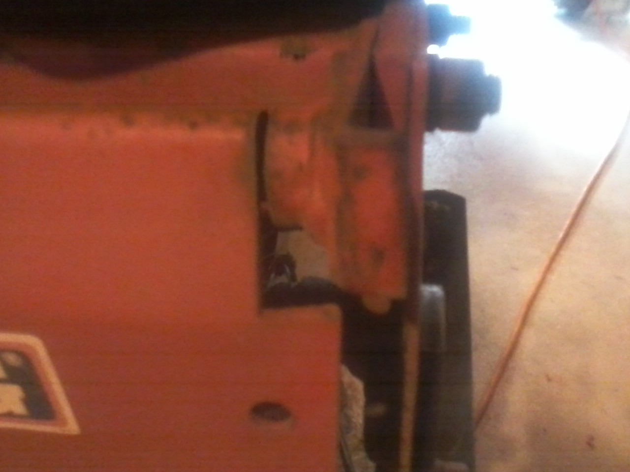

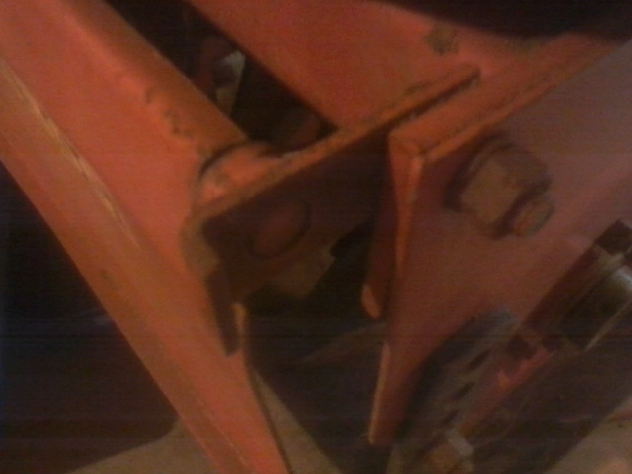

I have a 50 inch BH RTS tiller and has 1/4" x 1 1/4" steel pieces to mount the shield hinge (steel rod runs across the entire top width)
The BH photo doesn't really show that detail at least not very clearly. I think they are in there but facing down along the sides
Mine are set straight out horizontal to the back. And have always run it that way. That puts the shield farther back from the tines. As it is now the shield sometimes can still swing and bang off the tines if its raised with the PTO is running. The brackets are 3.25 long and the 1/2 dia. mounting holes are 2" O.C.
So can't really say if they are all the same :confused2:
My "A" dimension is 13" and the "B" (bottom edge) is an inch shorter than the total inside measurement
Here are couple of pics though
Maybe it can help some...then again maybe not :D

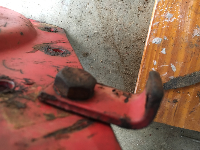

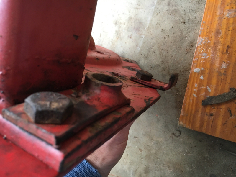

DFB, you are actually missing some pieces on the back of your tiller. They prevent the back shield from hitting the tines. I'll post a picture later.
   / Need Dimensions for Back Sheild of RTS62-04 Bush Hog Tiller #7
Well that should be interesting to note :shocked:
Didn't think I was :confused:
Check out the pics and let me know if you have any questions.
#9
Sorry I had some issues uploading both pictures at one time. Here's a 2nd up close one.
