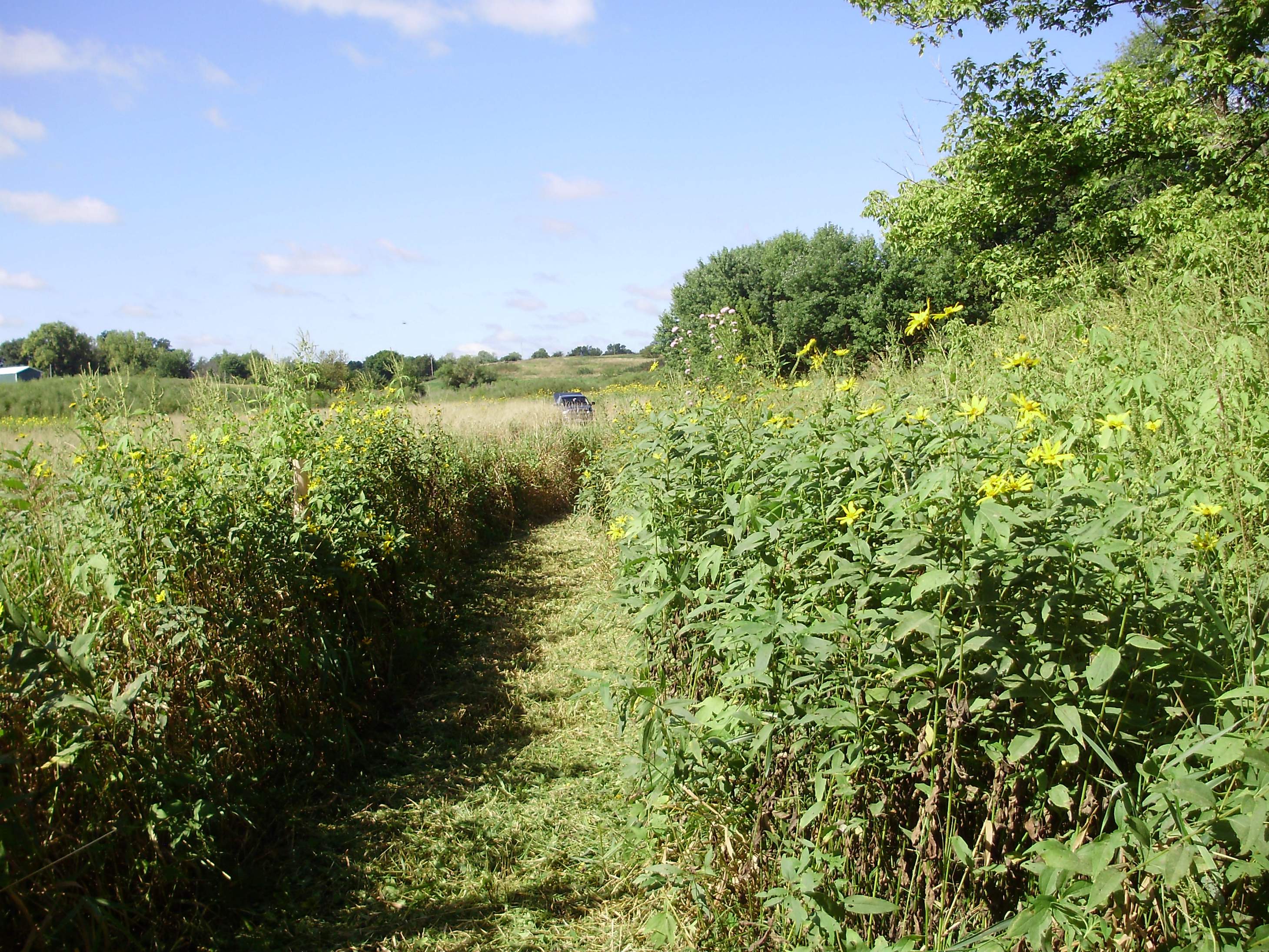

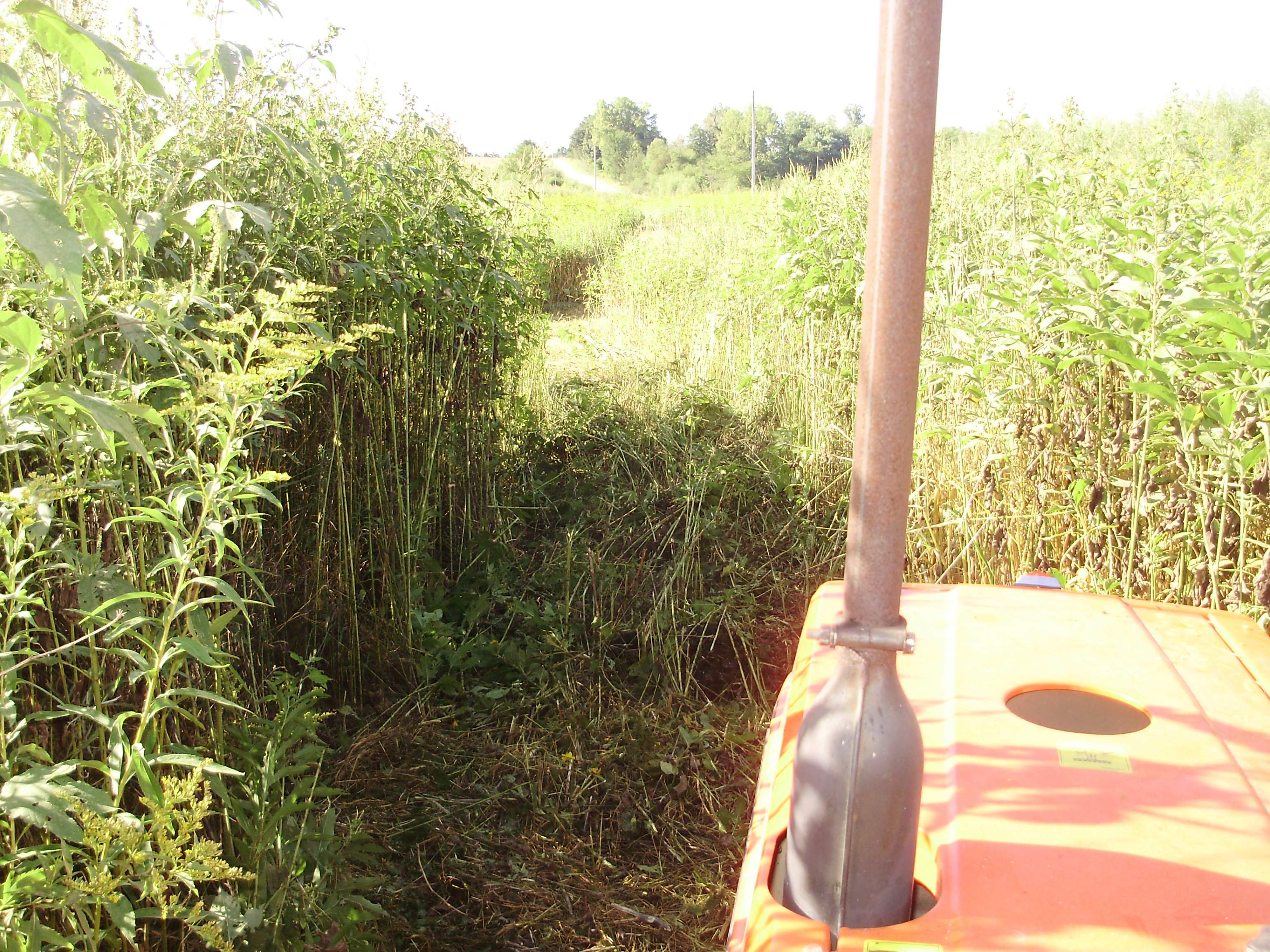

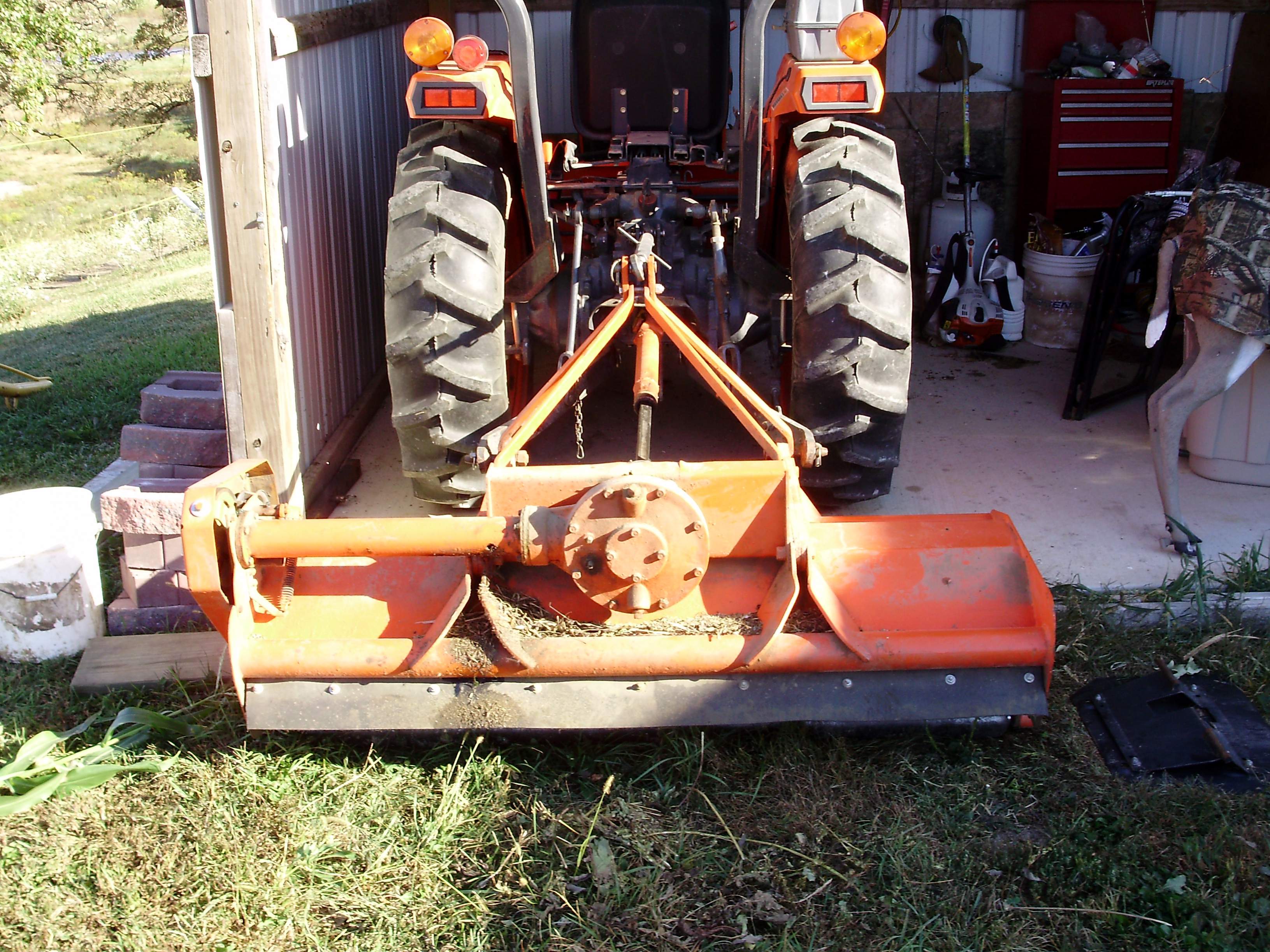

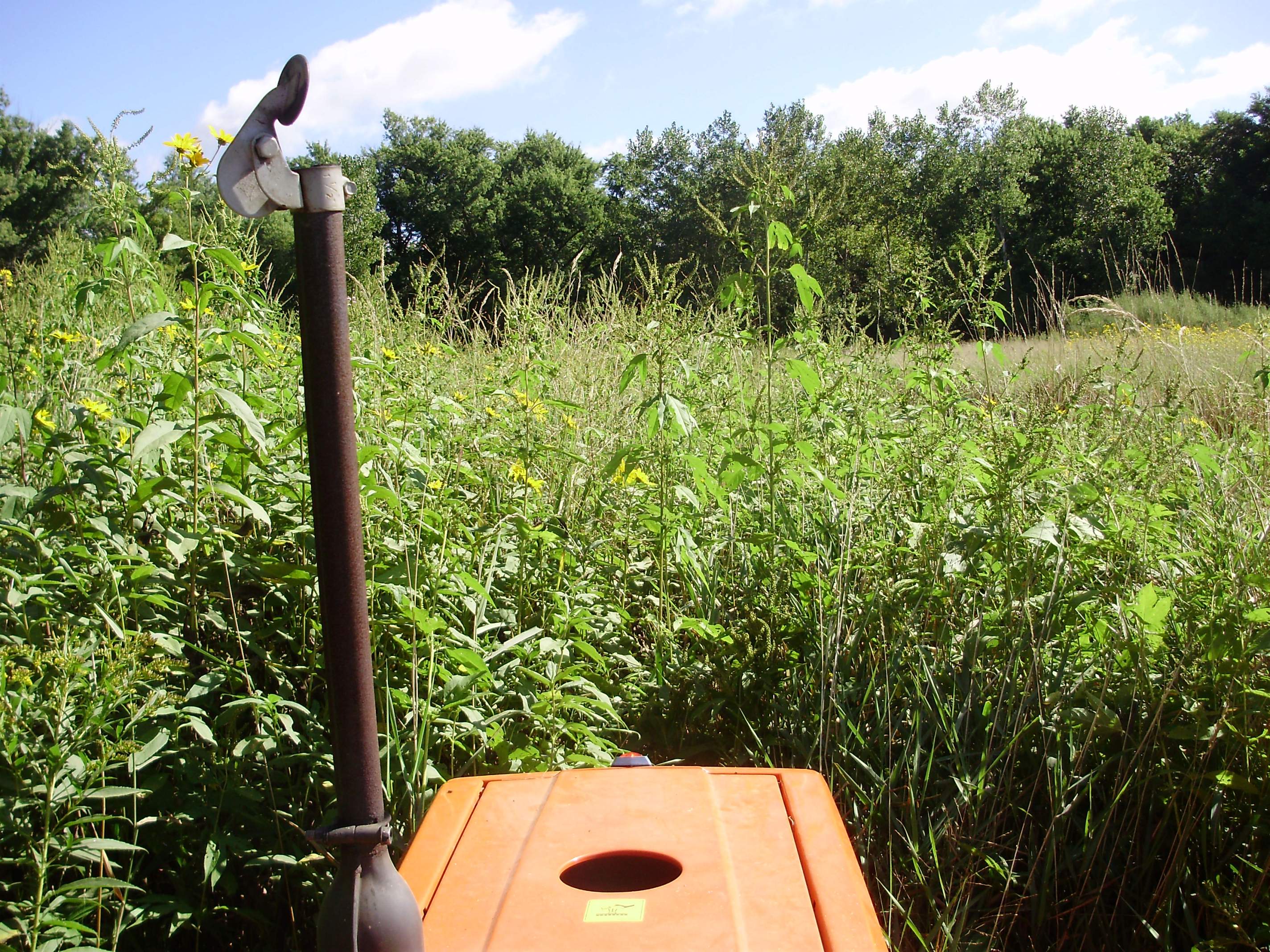

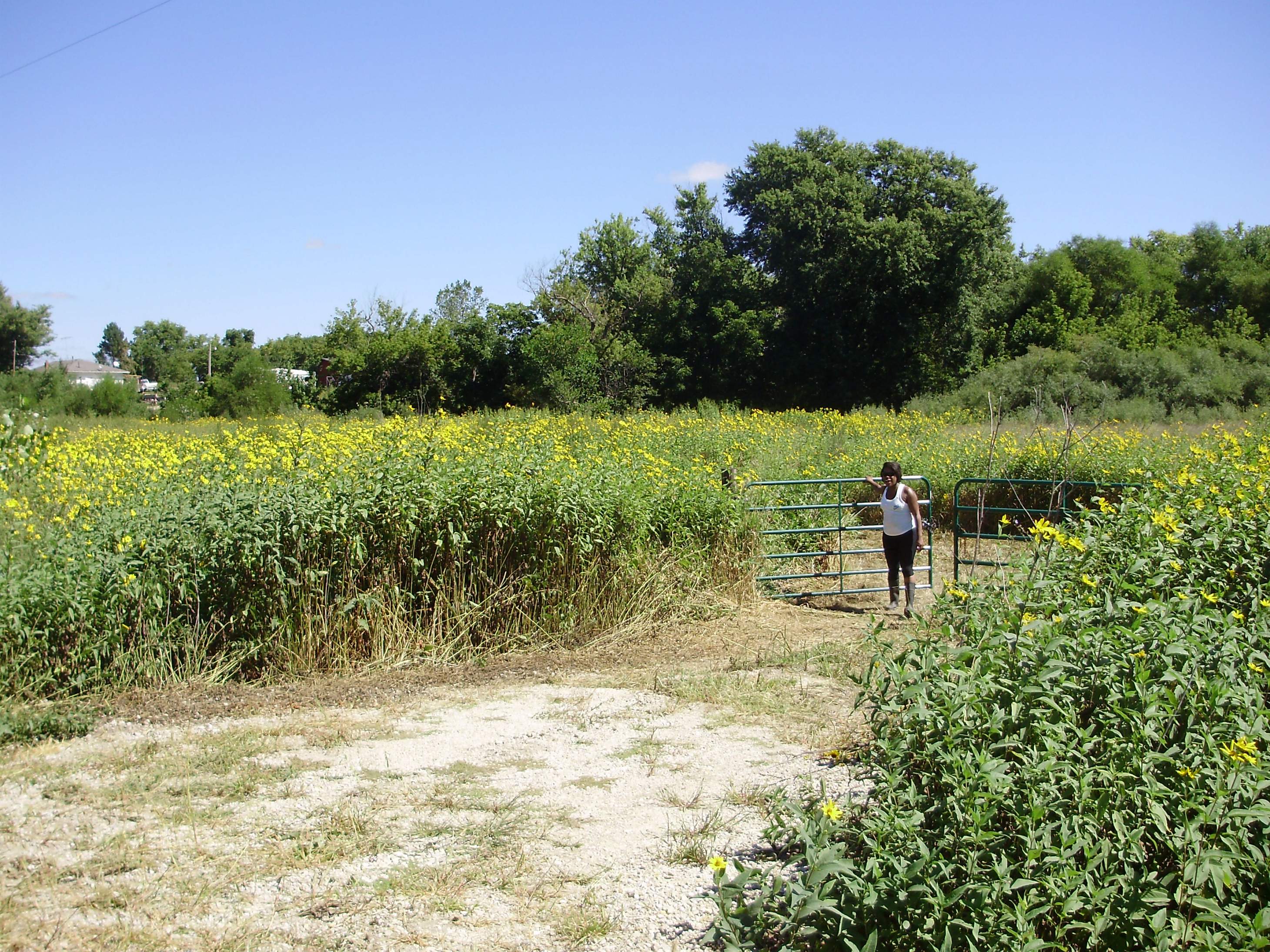

My wife has given me permission to buy a new rotary cutter and I need advise on which model to choose from. I want to buy the most heavy duty mower my tractor can handle. I have a Kubota L3000 DT and I have it narrowed down to two brands because that is what the nearest dealer to my property has. I really like the Woods BB 600X for 3,300.00 delivered because it seems very heavy duty. My concern is it weighs 1069lbs and was wondering if I might regret buying such a heavy mower. The other one I am thinking about is the Land Pride RCF 2060 for only 2400.00 delivered. It weighs only 690lbs. I have lots of brush and small 1 1/2 to 2 inch willow trees on my land and this land is in Iowa with some pasture on some hills.
I have an 5 ft Old Mott Flail mower now that I use and it does the job but the brush and trees knock off some of the blades sometimes. What mower should I buy for this tractor? I have pictures below of what I have to cut. P4140006.jpgP4140016.jpgP4140017.jpgP4140023.jpgfarm pictures 010.jpg

My Kubota B3300SU almost mirrors the stats of your L3000DT.
Tractor Data shows the L3000 to be 51" wide, so I presume you are shopping 60" Rotary Cutters.
With 27.5-HP/PTO when new, less now, I doubt if your tractor has the power to spin up a 1,069 pound cutter.
I expect the Land Pride at 690 pounds will work better for you.
It is pointless to have a Rotary Cutter that you cannot spin at optimal speed.
Land Pride and Woods are both well known for Rotary Cutters.
I cut up to 1-1/4" saplings with my 48" King Kutter Standard Duty L48-40.
I would think the Land Pride R/C would handle 2" soft willows fine with tractor covering the ground at slow speed.
Does your L3000DT have Position Control on the 3-Pt.? If not, you will need to consider Limit Chains such as Zercos, which would be another reason to favor a 690 pound R/C over a 1,069 pound R/C.
What advice did the dealer give?
You may want to call Tech Support at Woods and Land Pride for their recommendations.

As you already own a Mott flailmowe;
You also should consider a Caroni rough cut flail mower.
Their two row flailmowers have hardened side slicers and we have many
happy owners of this model on the forum.
The Caroni TM1600BSC model has a 63 inch cutting width and has 2 row flail mower rotor
with 24 mounting stations using shackles to attach the 48 hardened side slicer knives.
This model wieghs in at 628 pounds.
