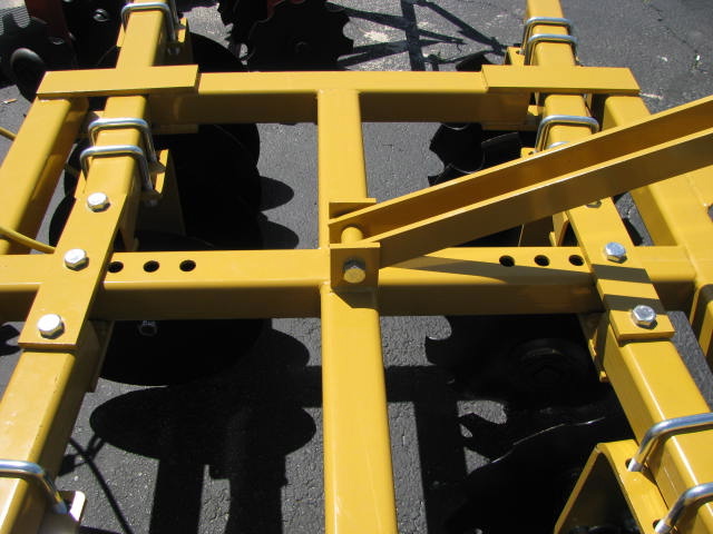

I have a notched disc question. What is the best tool to sharpen inside the notch itself?
I have never honed Disc Harrow pans myself, but I suppose a readily available cone-shape abrasive fitting in a battery drill would work fine. The scallops are the weakest part of the pan. If you remove much metal you increase the risk of deforming or snapping off one of the scallops when encountering a boulder ~~~~risk increases if the Disc Harrow owner adds weight to the frame.
My unscientific rule of thumb is that notched/scalloped pans cut like smooth pans one size larger. i.e.: 18" scalloped pans cut like (almost nonexistent) 20" smooth pans, 20" scalloped pans cut like 22" smooth pans. This is why manufacturers usually offer only notched pans until 22" or 24" size, when the pans are so heavy that smooth configuration penetrates adequately.
"Nothing whatsoever bad about a Leinbach Disc Harrow."
Having gang adjustment holes in the lever, rather than holes in the disc frame like my old Howse (Photo #1) and Tarter/TSC CountyLine (Photo #2), is a stronger design and makes gang adjustment faster. My current Monroe Tufline 20" disc shares the Leinbach design, holes in the lever.
Check the axle nuts for tightness regularly. On my Howse 16/18" the axle nuts worked loose for quite a while. A big, LONG wrench for tightening the axle nuts is worth buying from eBay, with a little patience you can buy BLW for $15 delivered. Loose axle nuts will allow a pan to round out in the hub (bad) or abrade the axle until the pan is loose (worse).
I will definitely try your idea running front heavy and rear light. I will have to watch depth and resistance as my WM40 could bury it.
Light Disc Harrow + owner added weight + heavy tractor = busted frame.
