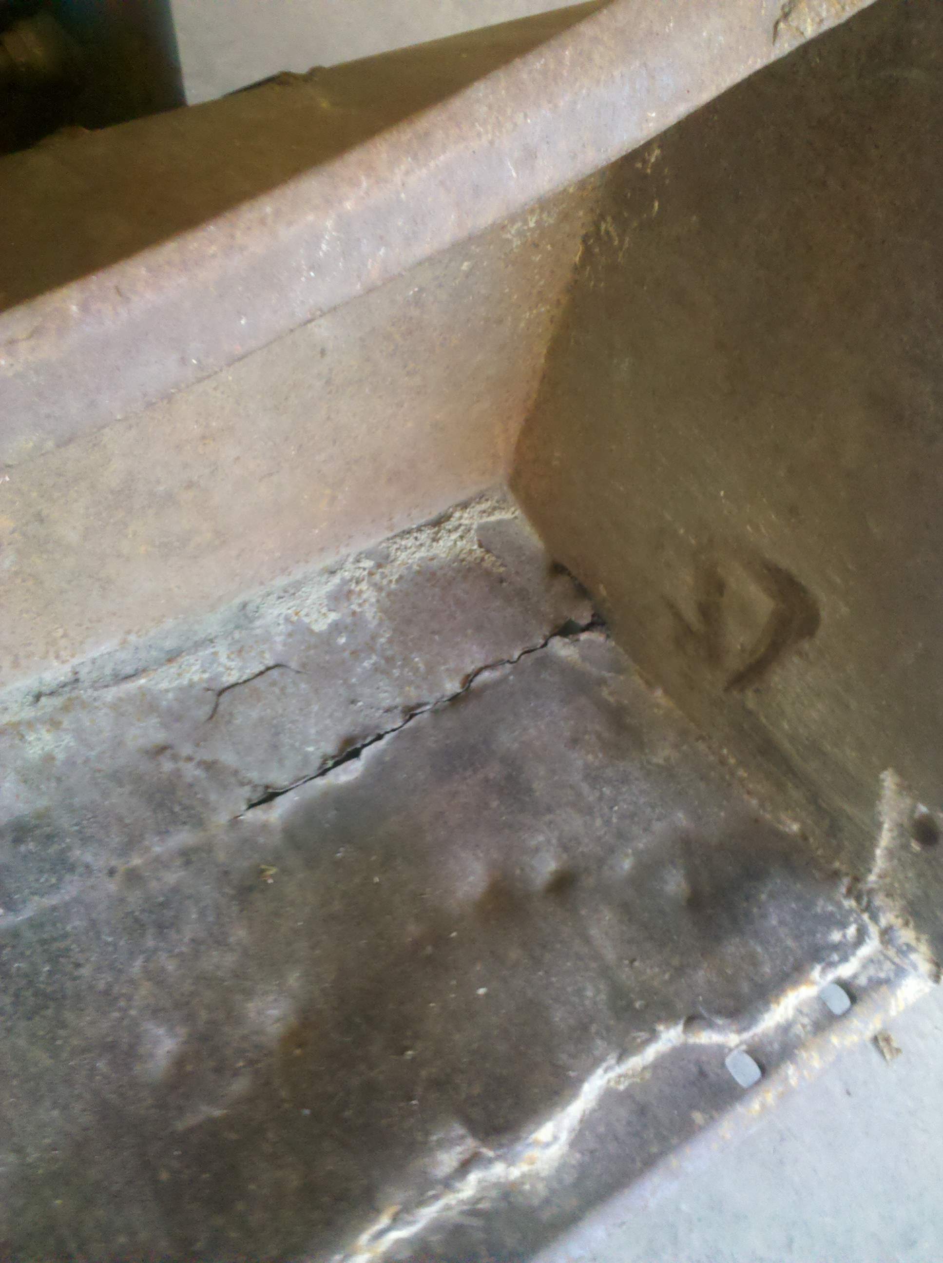

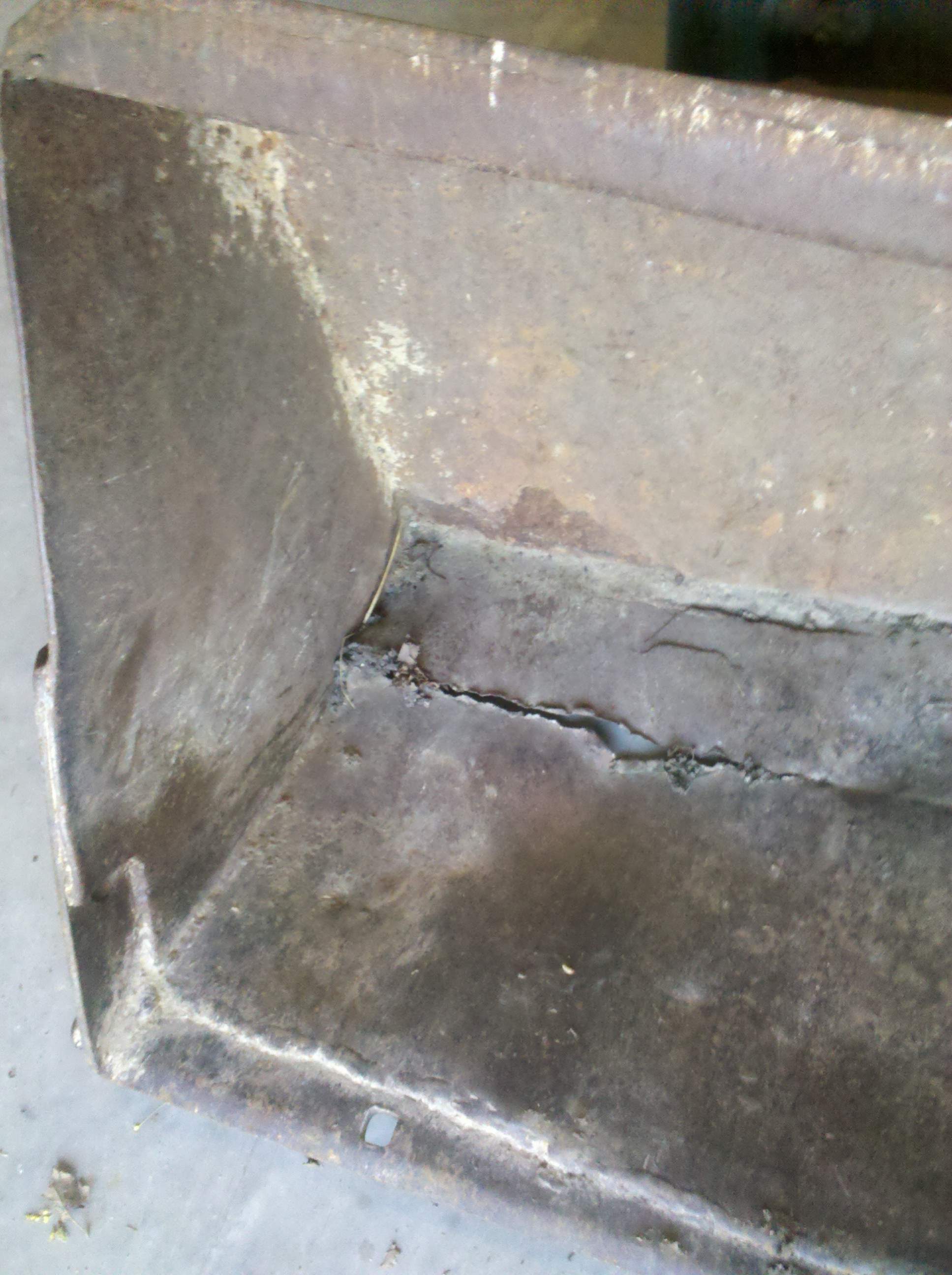

Hello again,
I am just looking for some advice. I have a Ford 7108 Quick Attach loader with a 60" bucket on it that I use on my Ford 1720 tractor. When I got the tractor I noticed the bucket was worn through and is now starting to crack. I would like to repair it and just wondered if anyone has had any experience with this type of repair. I thought about cutting out the bad section and welding in a replacement section or getting a 3/16 piece of sheet steel creased to fit the profile and weld in over the top of the current plate. Does anyone have any suggestions here? The bucket itself is dented in places so it may be a bit of a challenge to perfectly line up the sheet steel. I don't have a cutting torch but might be able to get use of one. I appreciate any advice.
Thanks!

i think either option would work, altho with the wear in the bucket I would lean to the removal of the metal and replacement. Your going to need a cutting torch; plasma cutter or a lot of grinding wheels...
/ Need advice on welding a loader bucket #3
cut out and replace, to make the repair easier you'll want to remove the bucket. A simple way to make a clean cut (cheap) is to use a skill saw with a metal cutting blade. You can buy them at Harbor freight. I have cut metal this way for years, it's not the fastest but it is clean and the equipment needed is simple(low cost).
/ Need advice on welding a loader bucket #4
I vote cut the whole bottom out and replace it.

Looking at your repair this what I would do if this is not a rust problem. If it is rust then I would cut it out. I would hammer the crack down to tighten up the crack then I would run a three bead pass of 7018 tie one bead into the other then grand it somewhat flat. Place a 1/4"or 3/16" piece of flat plate and place it all the way up into the corner of the bucket and stick weld with 7018 all the way around the plate. This would be the fastest to repair and if you do it right it will last for years. The 3 bead pass would be like stringer beads one bead just overlapping the other just a slight overlap.The crack on the left side of the bucket might require a backer plate also. I would sleep on it do what you think you would be happiest with. Although the way I told you would work.
/ Need advice on welding a loader bucket #8
I vote to cut it out and replace too. Without the use of a torch or plasma, a sawzall will make quick work of 3/16 inch material.
/ Need advice on welding a loader bucket #9
I'll defer to the experts here but I suspect part of the question is how wide (front to back) of an area is worn thin? If it's just a stress crack with thick metal all around, that's different than if an area 6" (front to back) is worn thin. There is no patching across paper thin metal, you need to get to good solid steel.

I had the same problem with a Kubota B7100 bucket.
The Fellow's at the welding shop covered the outside bottom of the bucket with a sheet of 1/4 in. steel plate. Worked very well for me.:thumbsup::thumbsup:
Covering on the outside makes it easier to form the sheet to the bucket.:)

One thing that many may not realize is that between the two cracked spots is a hollow spot between the back of the bucket and where the front crack is. The crack toward the front edge of the bucket is single thickness where the two pieced of metal join. The back of the bucket on the outside is rounded whereas the interior is flat. I think this is just a transition to keep dirt from sticking into the bucket so bad. The easiest fix would be to just cut a new piece of flat bar and lay it in the bucket overlapping the cracked edges and weld it in by skip weld working from both ends toward the middle after tacking the whole thing in. Leave the old metal in as it isnt that much weight to worry about. I recently fixed a bucket on a NH that was cracked similar but not as severe buy just welding up the cracked seam but I had a lot more metal to work with than what is apparent here, even then, I burned several holes in that that I had to fill and grind down on the outside. If you put too much weld metal on it, the likely hood of bowing the cutting edge increased incrementally since you are only welding on the top side it tends to warp the bottom to where the middle is higher than the edges. Dont ask me how I know that.
/ Need advice on welding a loader bucket #13
I might add that since it is worn thru, you will need to scab on some plate to the back side of the bucket also. Original thickness of this material is likely not more than 1/8" thick. You could drill a hole and check the thickness and replace with in kind material.
Your design may not imitate the NH bucket where it was flat on the inside and round on the outside. If it is round, you may have to have the replacement plate rolled or at least bent to mimick the original contour.
Unless you do all the work yourself, a welding shop might charge you more than a new bucket would cost so get some prices first rather than just telling them to fix it.
/ Need advice on welding a loader bucket #14
No question that you should cut the whole bottom out and replace with new material. It seems to me that the cutting edge on there is not original either. I'm curious. How many hours and what kind of use wore that bucket out to this point?

Thanks all for all the advice. While deciding what route to take on this, I stumbled across a party that had a 60" bucket for sale. Currently, I own a Ford 1720 with a Ford 7108 series loader on it so I was hoping to find a bucket that might fit it without me having to do many modifcations. Four pin buckets aren't as easy to come by now-a-days since everything has gone to quick-attach setups.
Well, after making a quick phone call on the bucket for sale, I found out that the bucket was brand new and originally came with a Ford 7108 Series loader (which is what I have on my tractor). Apparently the fellow that bought the loader new back in 1990 did not want the bucket and replaced it with a different one so here the dang thing was - brand new, never used, and sitting in a shed for the past 22 years. The paint was faded a bit and it had some surface rust in a few spots but otherwise it was in great shape.
So long story short, I ended up buying the bucket at a very reasonable price and now have a brand new (from 1990) Ford factory bucket back on the loader for which it was orginally made for. Go figure. Apparently timing is everything! :thumbsup:
