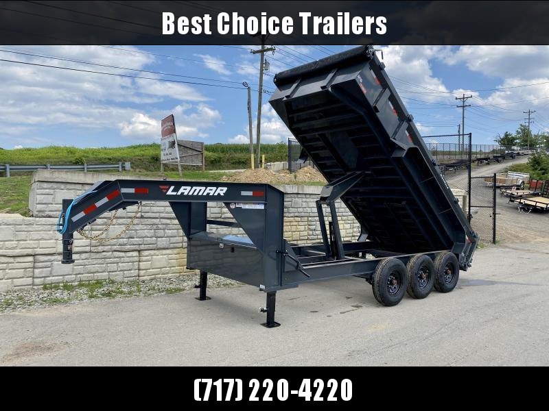

There are 7k oil baths. Just saw a Lamar dump with triple 7's-oil baths.
   / Need advice on trailer purchase #77
My dump trailer with 8k axels has oil bath caps but the spindles are greased. If I knew the back seals would handle it it I’d dump oil in them.
   / Need advice on trailer purchase #78
You can even get oil bath hubs for 3500lb axles if you want. Pluses and minuses to both. For my uses I think 8k axles either greased or oil would work, I just like oil because I hate packing bearings.
