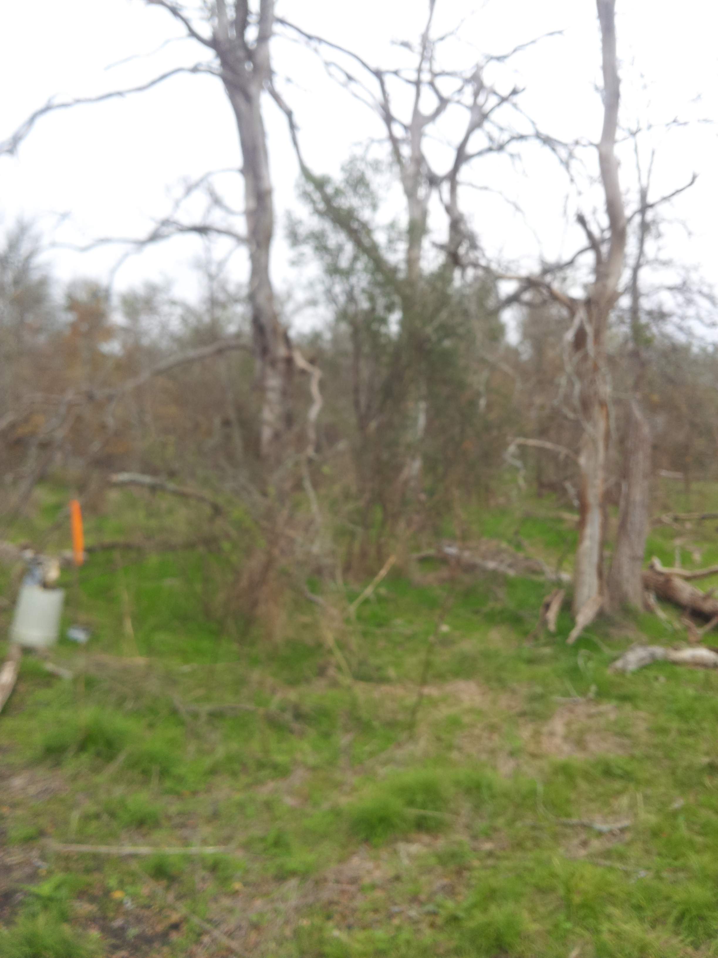

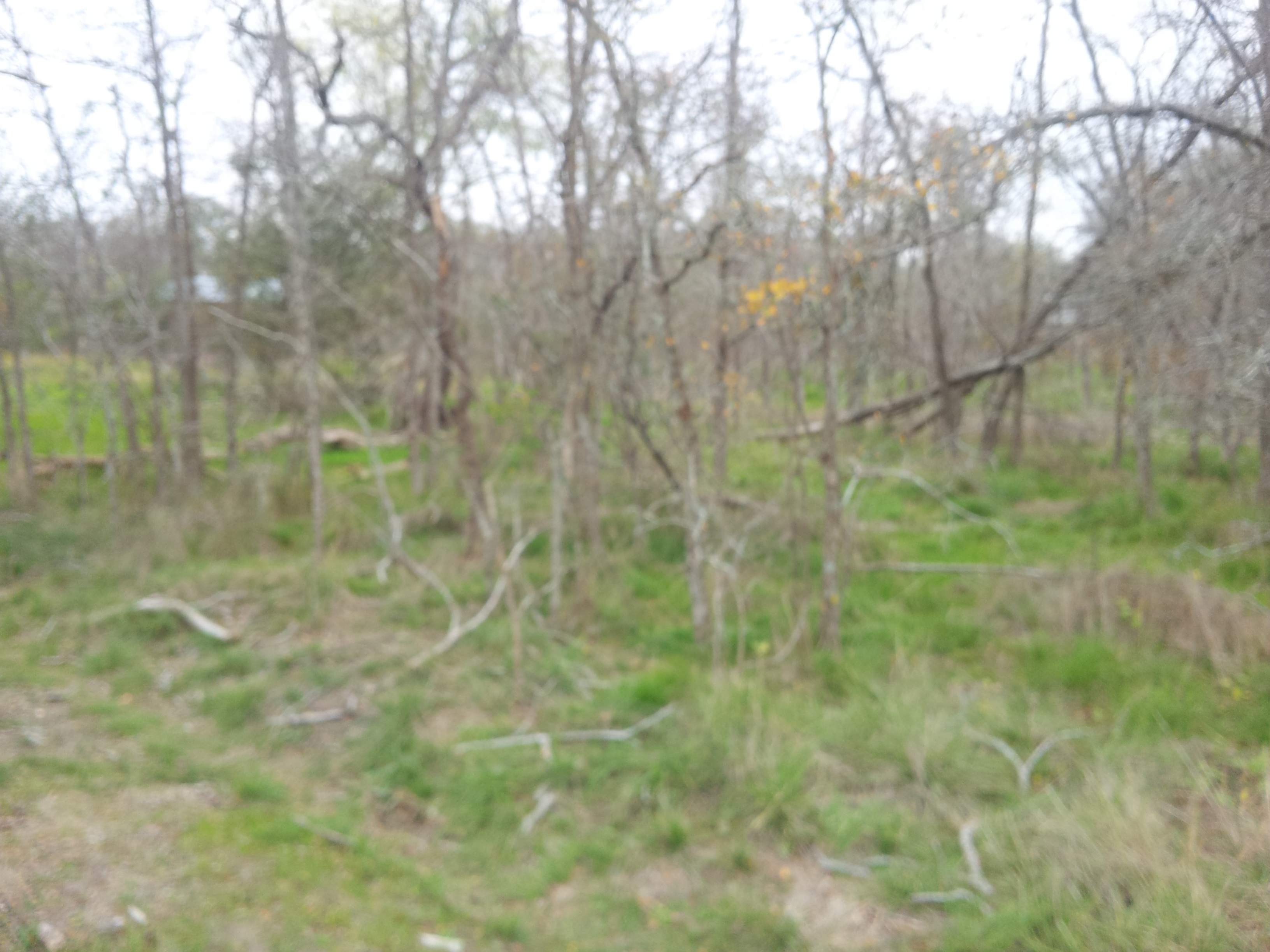

You're thinking too much. I see a wall of green. I'm using the BXpanded bolt on toothblade exactly the way it is supposed to be used on 2" and smaller material. Right before I made the video, as a test I sheared off a 3" pine like it wasn't even there. The stuff you see me hitting repeatedly is a stand of thick poplar. The loader has a breakout force approaching 5,000 pounds and can lift 2900 pounds all the way up. It is a much heavier loader than what is featured on smaller tractors. The whole point of the BXpanded piranha tooth bar is that it has a hardened, serrated, sharpened edge for cutting through material as demonstrated in the final section of their own demo video.

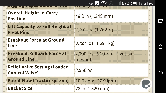

Just a quick correction on your loader specs ...
And, I have no problem with how you're using your tractor. If you damaged your FEL by doing what folks are complaining about in your video, then my tractor should be broken into several pieces by now.

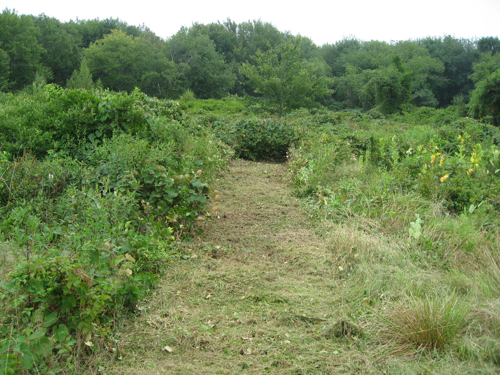

On that line of thinking, you walk every inch of every field with weeds higher than your calves before you brush hog it, right?
   / Need advice on the size of tractor to look for #85

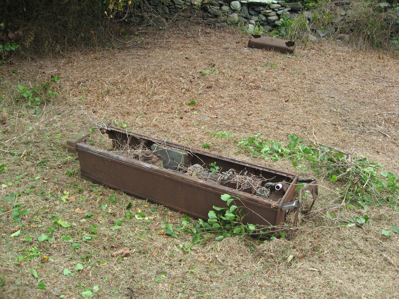

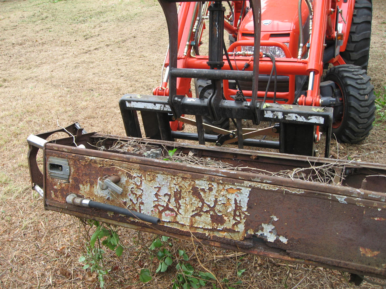

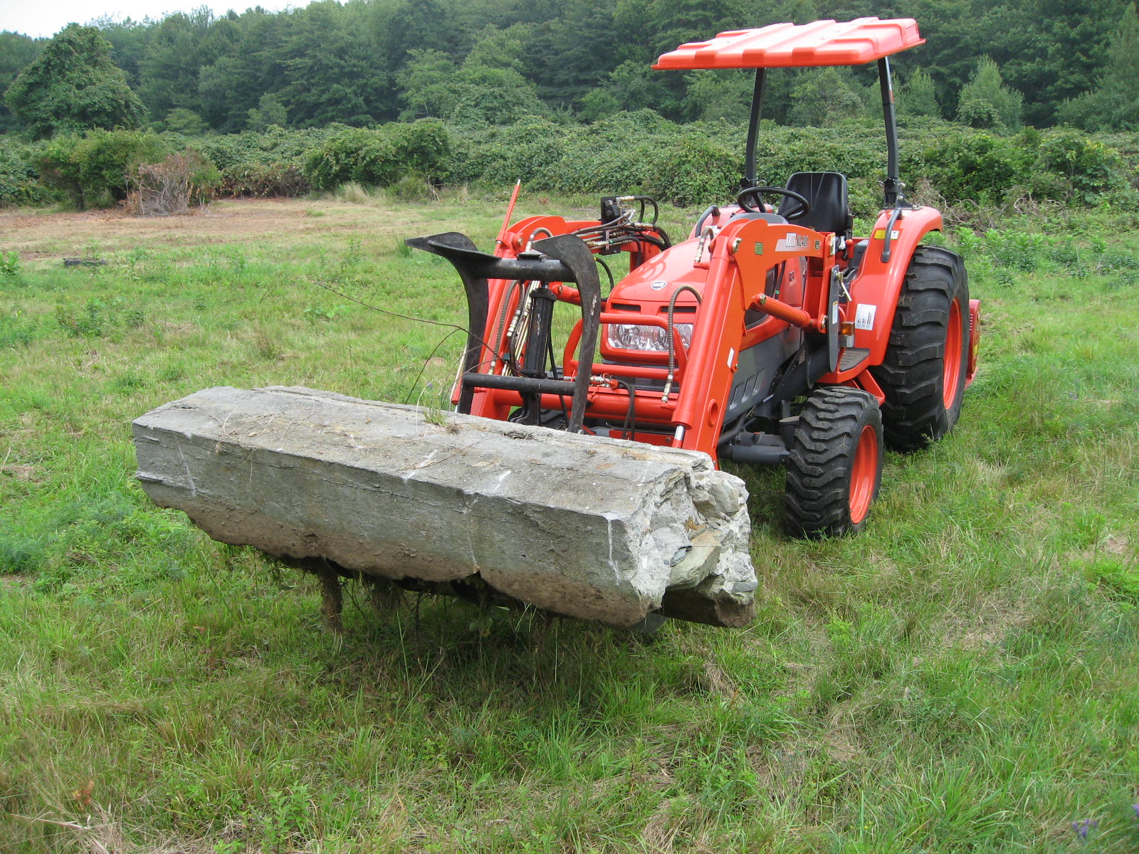

Nope, but I do keep a bucket or grapple curled/tilted up and riding about six inches off the ground when I mow tall weeds/grass. My best "finds" using this technique were a complete service station gas pump lying in the weeds and a jersey barrier sized chunk of concrete. I don't walk the fields because I'd need a machete to move more than two feet so I do the next best thing which is to use the upturned grapple as a shield as I drive the tractor. The grapple rides up on the obstructions and gives me plenty of warning to slow down.
Why not take reasonable precautions? I think this is especially true when pushing the limits of what CUTs are designed to do. As noted many times in the this thread, a CUT can clear land if used properly but nobody thinks that is what CUTs were primarily designed to do. It's understandable that having all that grunt available makes you want to push with a CUT but remember these machines have evolved from pulling devices and that is what their main strength is. Pushing is for bulldozers. If you do it with a CUT, you are stretching the design limits and should be conservative. Chuckling away as you ram your $35,000 piece of equipment into brush is foolhardy and will surely end up breaking something. I know Eric hasn't broken his loader yet but then again his tractor is only six months old. To paraphrase an old saying about pilots, "there are old tractors and bold tractors, but no old bold tractors".
Same here. I mow with the loader just off the ground, thinking I'd rather hit a rock once with the loader a 2 or 3 mph (or whatever speed) than with the mower. Although running over items like IT pictured would probably give sufficent warning, there are plenty of rocks that won't.
One look at the loader arms on any CUT shows they are meant to lift, there is no support behind the bucket where the majority of the force from pushing is going, so far below the lifting force of the loader, it will give somewhere. FEL are not even meant for serious digging below grade. much less pushing heavy loads horizantally. If Eric continues to use his tractor as he does currently, there is a very good chance that he will have a reincarnation of the CK loader problem on his NX.
