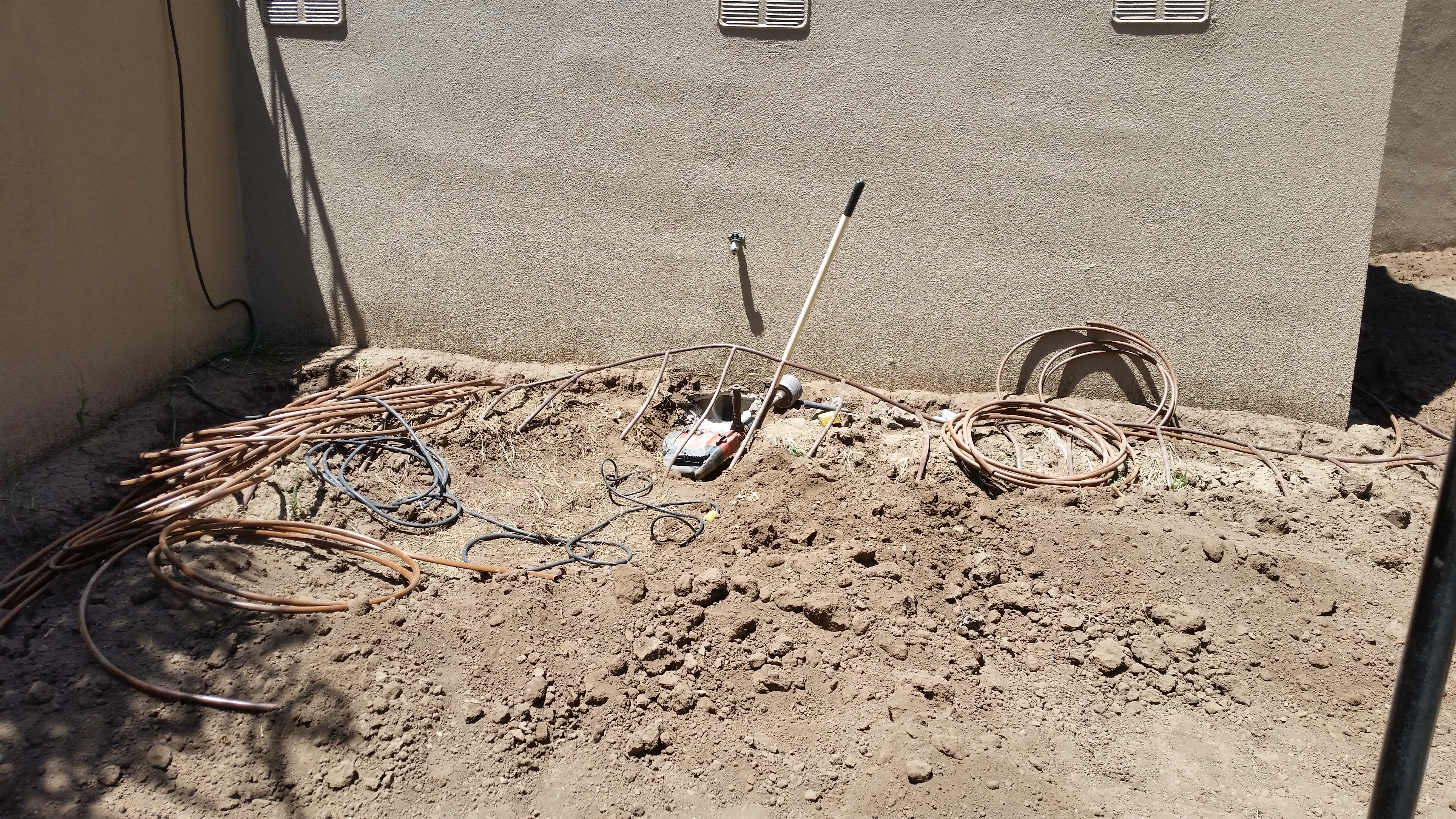

I installed drip irrigation tubing in a customer lawn this year and had 10 zones with 10 corresponding pieces of 1/2" drip to run through the concrete block wall. I used a 5" core bit with my Hilti to drill a hole to put in a 4" pvc pipe sleeve. For deep holes we usually will drill about 3" then remove the drill and bust the core with a steel form pin. You can get about as deep as you want three inches or so at a time. These cores break out quick and easy.
