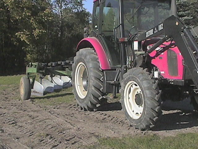

My tractor is 55 pto and 10K lbs, pulls a 4x18 on-land thru clay/sod easily. Only trouble is with large roots & boulders.
I also have an old 3 bottom 3pt JD that will ball up & pop out of the ground when trying to plow trash. Be aware that plows are designed to pull a certain centerline offset from the tractor, adding or subtracting moldboards will shift the centerline.
A small 3pt plow will not have much problem with the centerline like you are talking about. A semi-mount plow that is designed for adding or removing bottoms will have adjustments for the centerline as well. Just buy a manual and set the plow up properly as well as the tractor pulling it.

Off course you can. Many ploughs have a bolt-on 3rd, 4th or 5th share, which can be taken off in heavy soil or poor traction conditions.
There is some misunderstanding about the centerline of ploughs: The side forces of the ploughshares tipping over the "beam" of soil they cut loose, are pushed against the side of the furrow by the longitudinal strip of metal, i think its called the landslide. This keeps your plough from pushing the front axle of the tractor into the ploughed part of the field. The straight ahead stability comes from the landslides, and the centerpoint from where it is pulled, as a marginal difference.
However, to achieve this, the landslides should be perfectly parallel to the direction of travel. If you change the lower link arm stabilisers to get the first share plough as wide as the other 2 or 3, the landslides are no longer parallel to the direction of travel, and it will begin pushing you out of the furrow.
To solve this problem (working width of the 1st share without misaligning by lower link arm stabilisers) you'd need to either adapt the trackwidth of the tractor, or move the headstock of the plough aside. Not all ploughs have the option of changeing the headstock, so mostly you'll need to change the trackwidth of the tractor, to keep 1 wheel in the furrow.
I use a 3 furrow 16" reversible, and i prefer to plough with no lower link arm stabilisers at all: The plough and tractor match up perfectly and the plough can find its own way, the landslides keeping it straight.
When we had another tractor on 18.4-34 tires we did have to countersteer with the same plough, our current is on 16.9-30 so it can drive its centerline 1 inch further away from the side of the furrow, because the tires are this inch more narrow.
