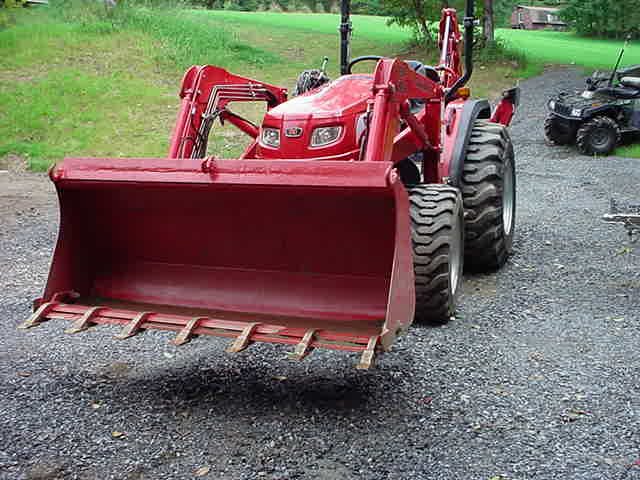

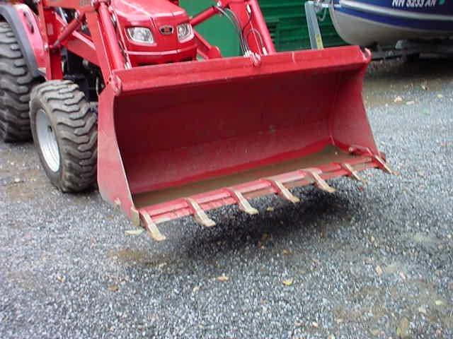

I install two pieces of angle iron on the top to give strength to the top of the bucket, then I install two large hooks on the outside for straps and a close hook in the center for chains.
It works well for me

and a second picture
