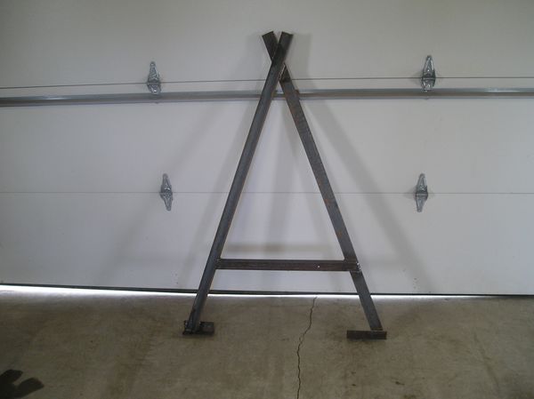

To make it easier to pull the roots out with the bush/tree, use an "A" frame. Wrap the chain around the trunk so it will slip tight, then over the top of the "A" frame and then down to the drawbar.
It will lift the roots up and then out of the ground.
I made this 4ft tall one but a 6ft tall one would work better. Better as in a longer arc and more leverage.
