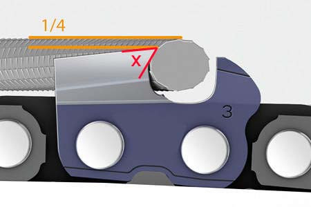

One thing I learned very young as a beginning feller was that those grabbing teeth on a chain saw aren't there to really be used. If you have to use the teeth for more than simple - light - leverage, your chain is dull. If you have to use teeth when bucking, you are either doing it wrong or your chain is dull. Please don't get me wrong, I have no issues with folks that use the teeth, I was just taught a different way of logging.

I haven't seen that post..all I can say is that cutting for over 40 years...nothing beats carbide, hands down best chain for all hardwoods
A sharp steel chain will cut circles around a carbide chain. Cutting stuff besides wood will quickly destroy either chain and the carbide takes special equipment to sharpen.

Actually that is a valid question that no one here can answer and maybe I can't either. I sharpen the chain regularly as mentioned. But is my technique good? I don't know. The Stihl jig makes it hard to get wrong and I was decent with a just a file in years past. The electric sharpener is all set up in a fixed position and it does no better than the Stihl sharpener.
When I start sawing it cuts like a champ. Fast, clean and straight. But even after those three pines it was getting slower.
So maybe I know enough to get it sharp but not enough to put an edge on it that will stay on it? I doubt it but it might be possible.
