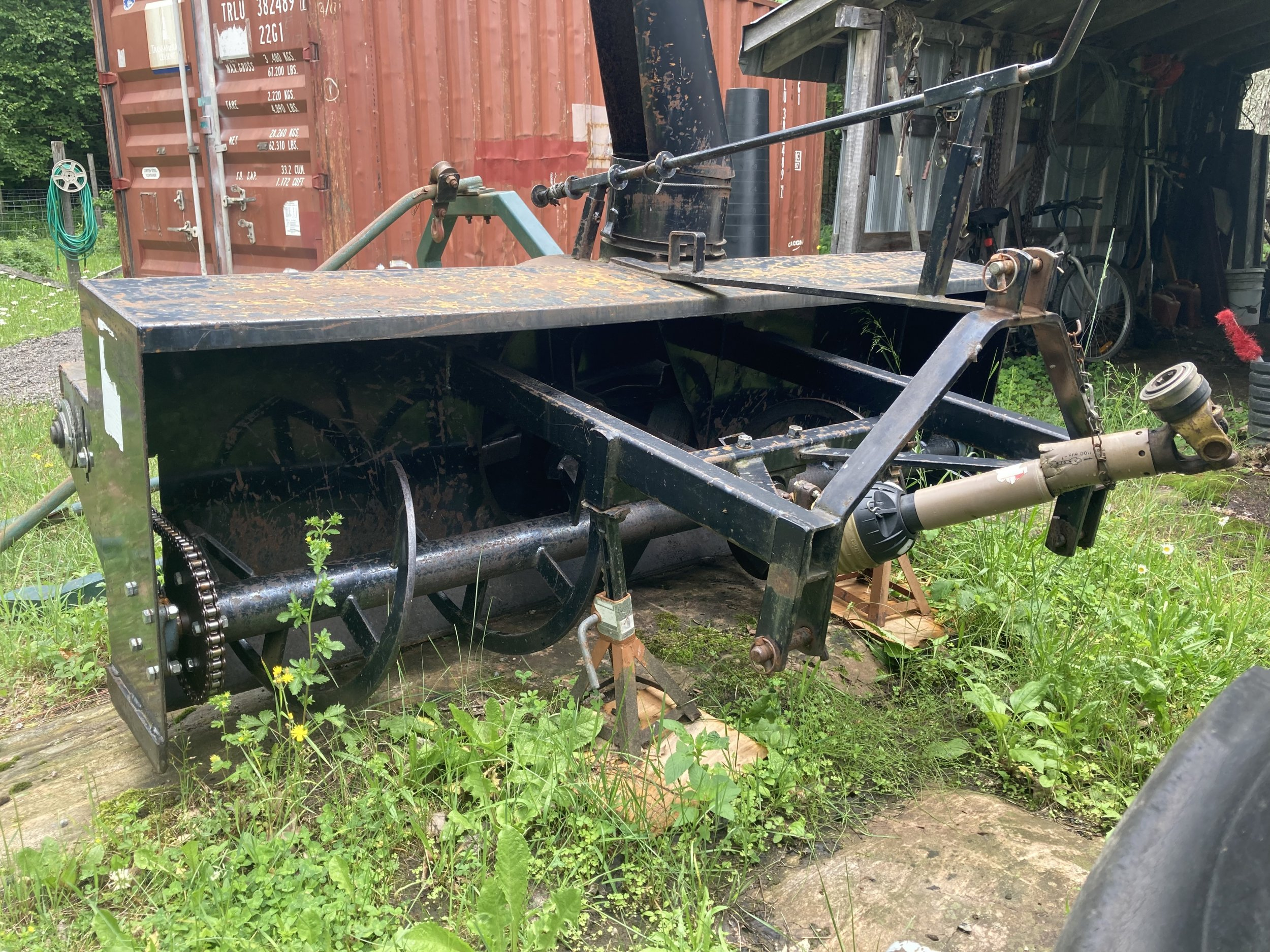

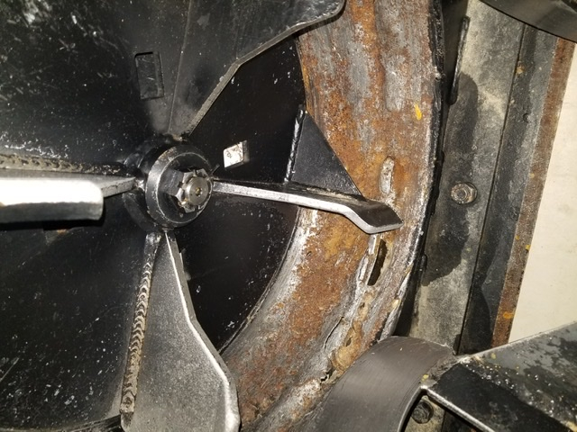

I had to reline mine this year. I used 8 ga steel, which is thicker than factory. Hope it will last awhile. I used scrap metal and rolled it myself. Had to pull the impeller out to do it. Took a few hours.

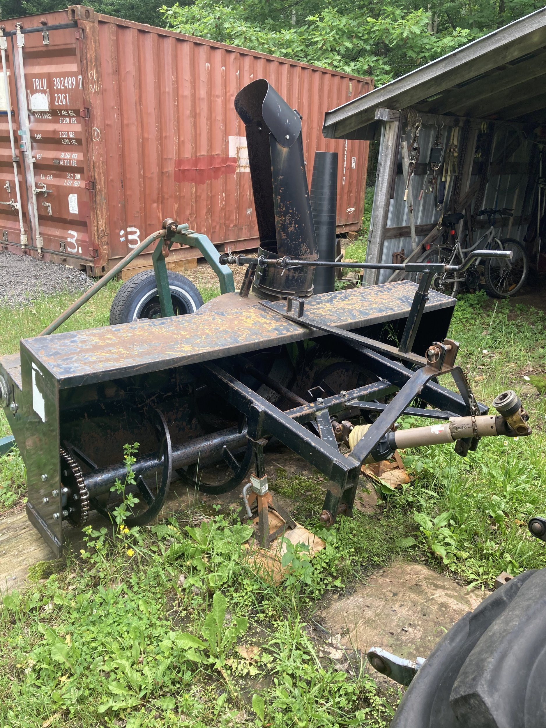

I have a‘drive ahead’ 78” blower with auger feed. I would say that the only down side is that you can’t blow right up to a garage. I end up staying about 2’ away.
Stay away from the back up type unless you’re married to a chiropractor.
Mine has a manual turning chute but they are available with hydraulic turning.
They are easy on and easy off and you can still use the loader for pushing back banks etc.
