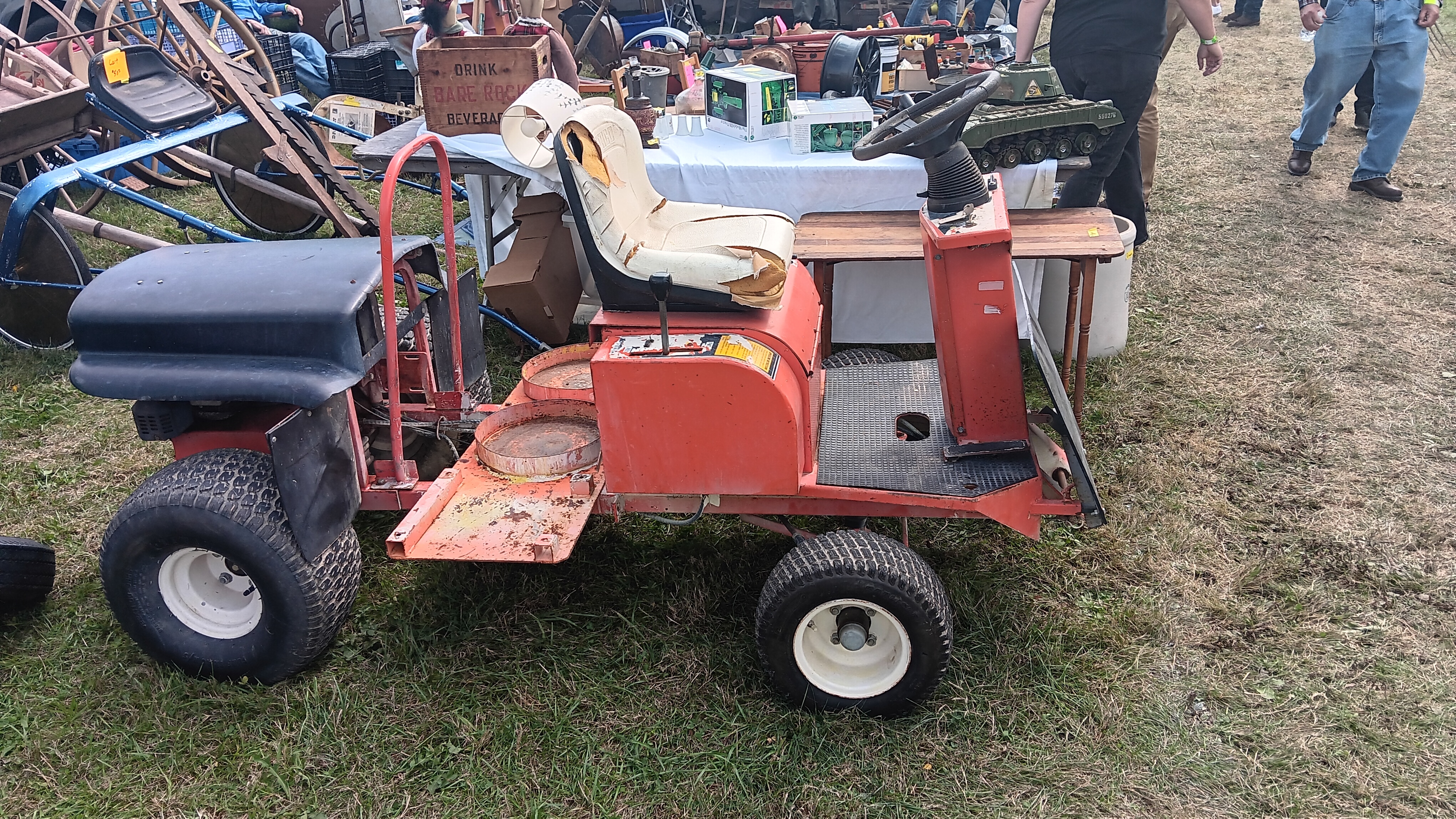

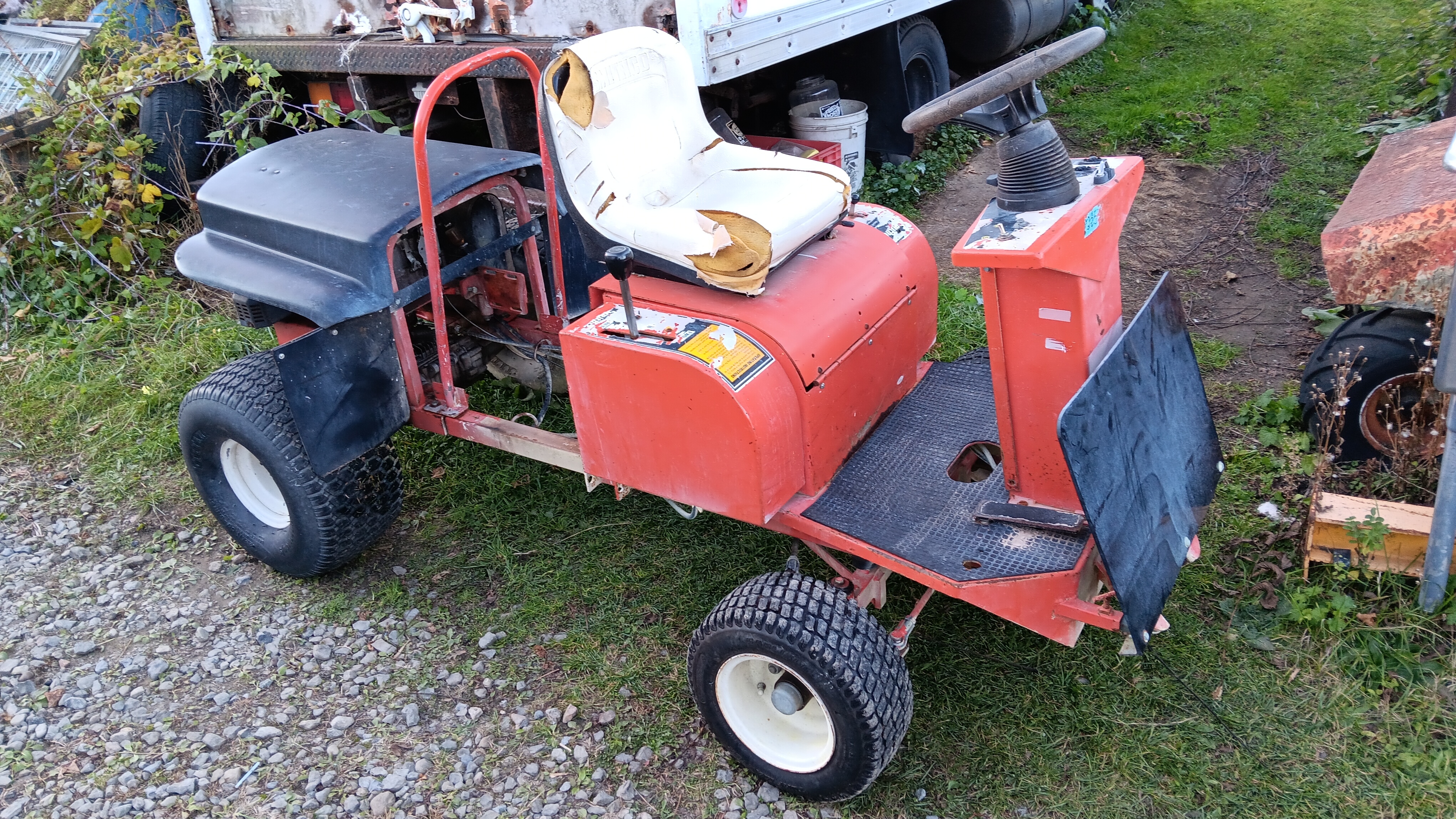

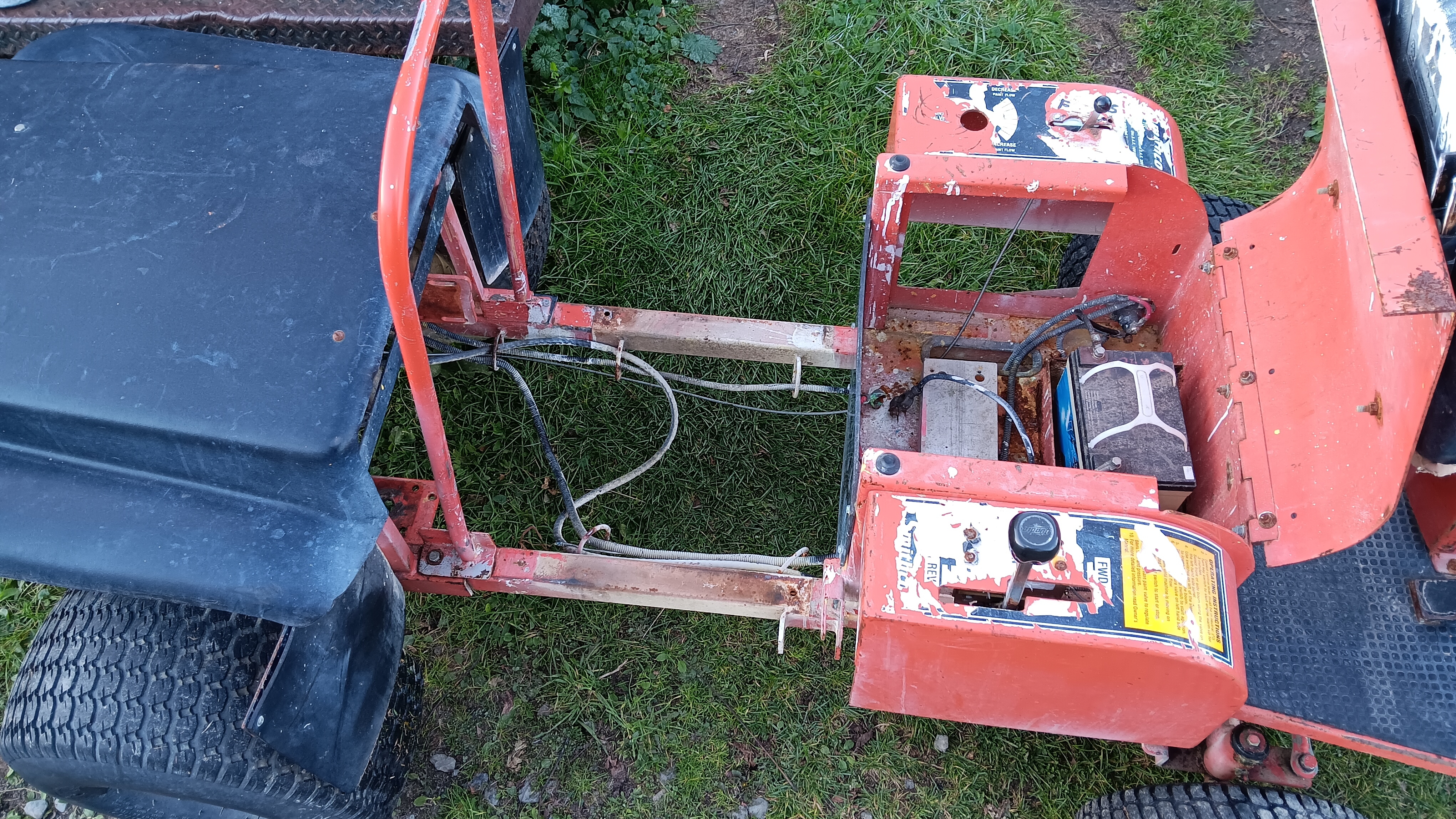

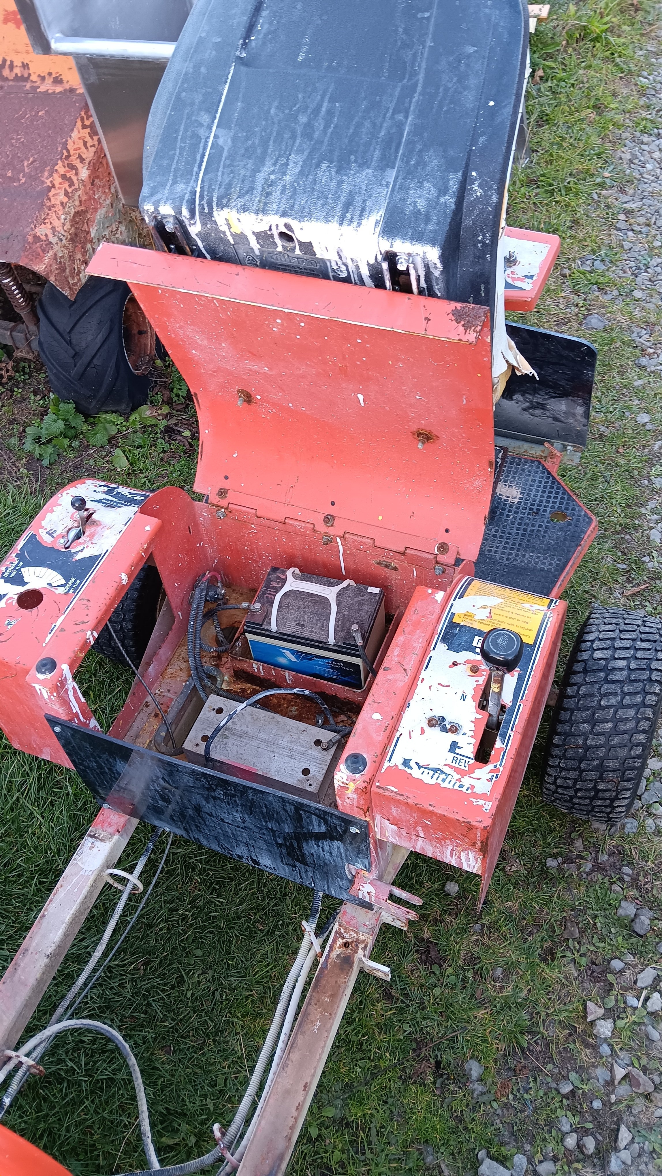

Well, I think that's really cool! Especially since this past august I picked up this Smithco Line Striper at a tractor show
flea market. It runs quite well, and the Eaton hydro trans axle is quite smooth and controllable even at idle. My intentions are to add another seat, either side by side or front & back and hopefully some sort of 'bed' to haul items. We do have a golf cart, but most all the shows now require insurance on them which is about $75/year. However, "Buggies", riding lawn mowers with wider seats, tractors, any contraption, etc, are not required to have insurance......yet. Thus, my plan. Plus I think it's quite quirky and cool.
Looking for ideas and suggestions on how to build it out....

Love it! I would build a crossbed toolbox to go behind the seat up to seat level, then build a dump bed going from about 6" behind the rear wheels up to the back of the seat and about a foot deep with stake pockets on the sides/front.

Great suggestions, thanks!
Yes, that's something like the visions I've had rolling around in my head. The seller pointed out, the middle could
be cut in half, and cross pieces of square tubing added with a pivot to make "yaw" side to side, whatever the term is.
Conform to ground contours I guess. The front axle does that now, but only has about 1" of travel. I've got the gears turning in my head on designs for over the winter now....

Me? First install a new seat...it's worn out and probably full of gas!
The space behind the seat would be good for a tank sprayer.
A hitch on back and tow a dump trailer. I have an electric 12VDC recliner actuator that has lots of force. I'd rig that up on dump cart which would be neat...dirt, gravel, etc. just push a button.

Seats been rode hard and blown apart.
It was built for spraying paint lines on ball fields, with paint tanks behind the seat just as you mention. The tanks, booms, and pump were gone when I got it. I started out dreaming big, upper observation deck with a bar, etc. I've since scaled back to just 1 lower level.
:D
Whatever gets built above the engine will have to tilt or come off easily for access and maintenance. The steering is quite rudimentary, bump steer galore. I wish it was power. But the thing was built just to operate on flat-level-smooth playing fields, so.... As long as it can tour the tractor show grounds at 1-5 MPH comfortably, it'll serve it's re-purpose.

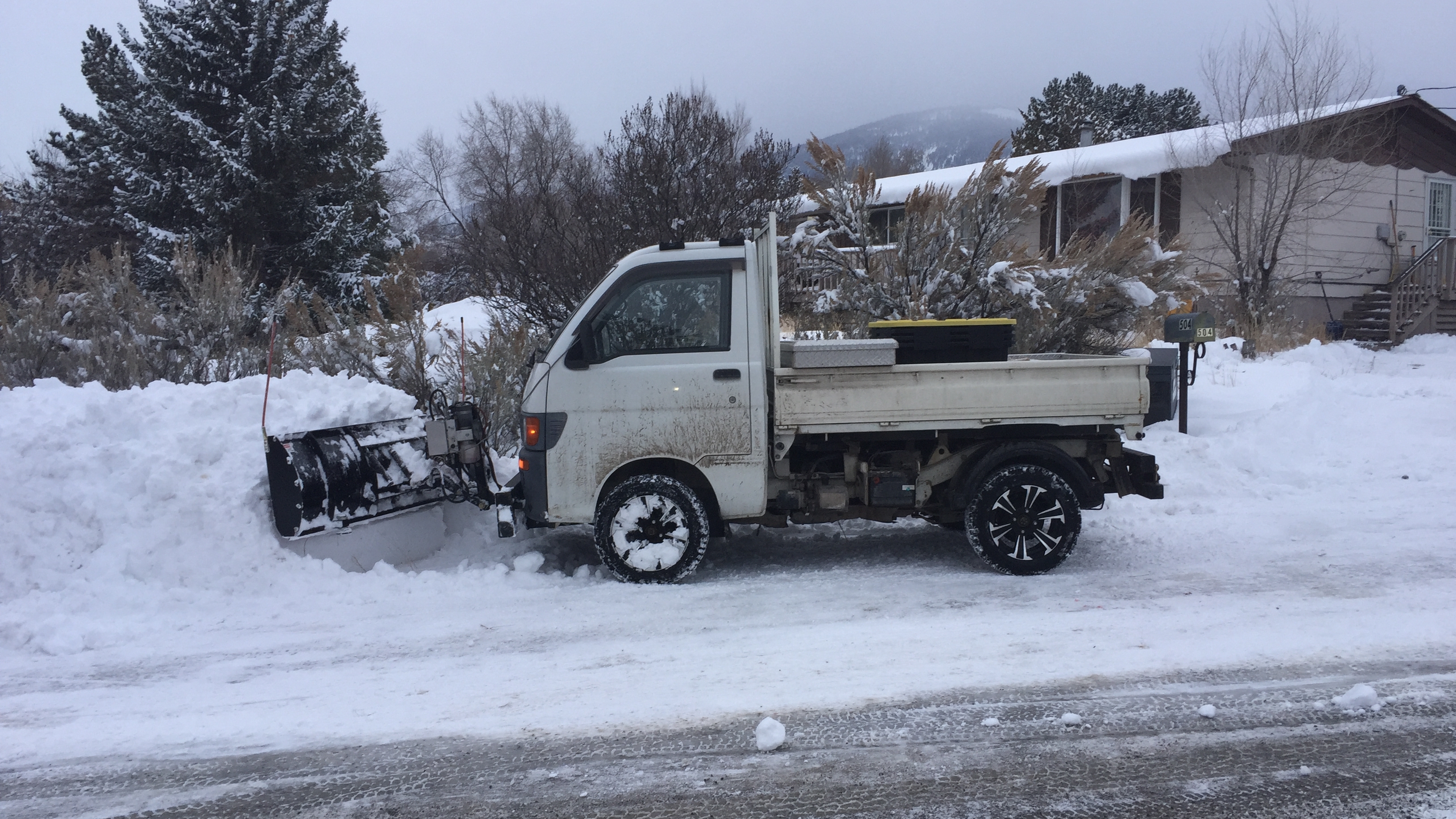

I'll stay with the JDM Minitruck. Enclosed cab with heat and AC, hi-lo range 4wd, full locking differentials. And the clincher a scissors lift/dump bed. Perfect match up for the FELs on my tractors.

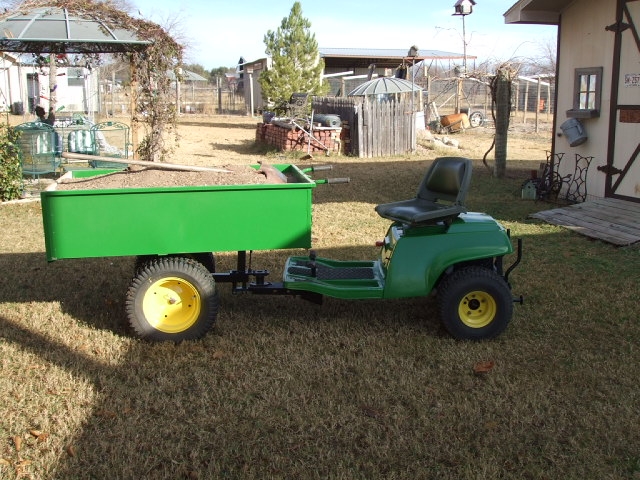

This is the 'new to me' yard cart. Great in tight spaces where the tractor won't fit. 1100 lb. capacity and hydraulic dump. Scoots along pretty good in 'Road Gear'

I want one of those to drive on the street, but still can't figure out how or if they can be legal to drive on-road in MO. I have seen a couple, but I dunno'.....
/ Need a yard truck? #32
I have seen them out and about too. Highly doubt they meet the fed crash standards, people dont bother with such things much anymore (traffic stds/rules). Guess the biggie is will your insurance carrier cover it?

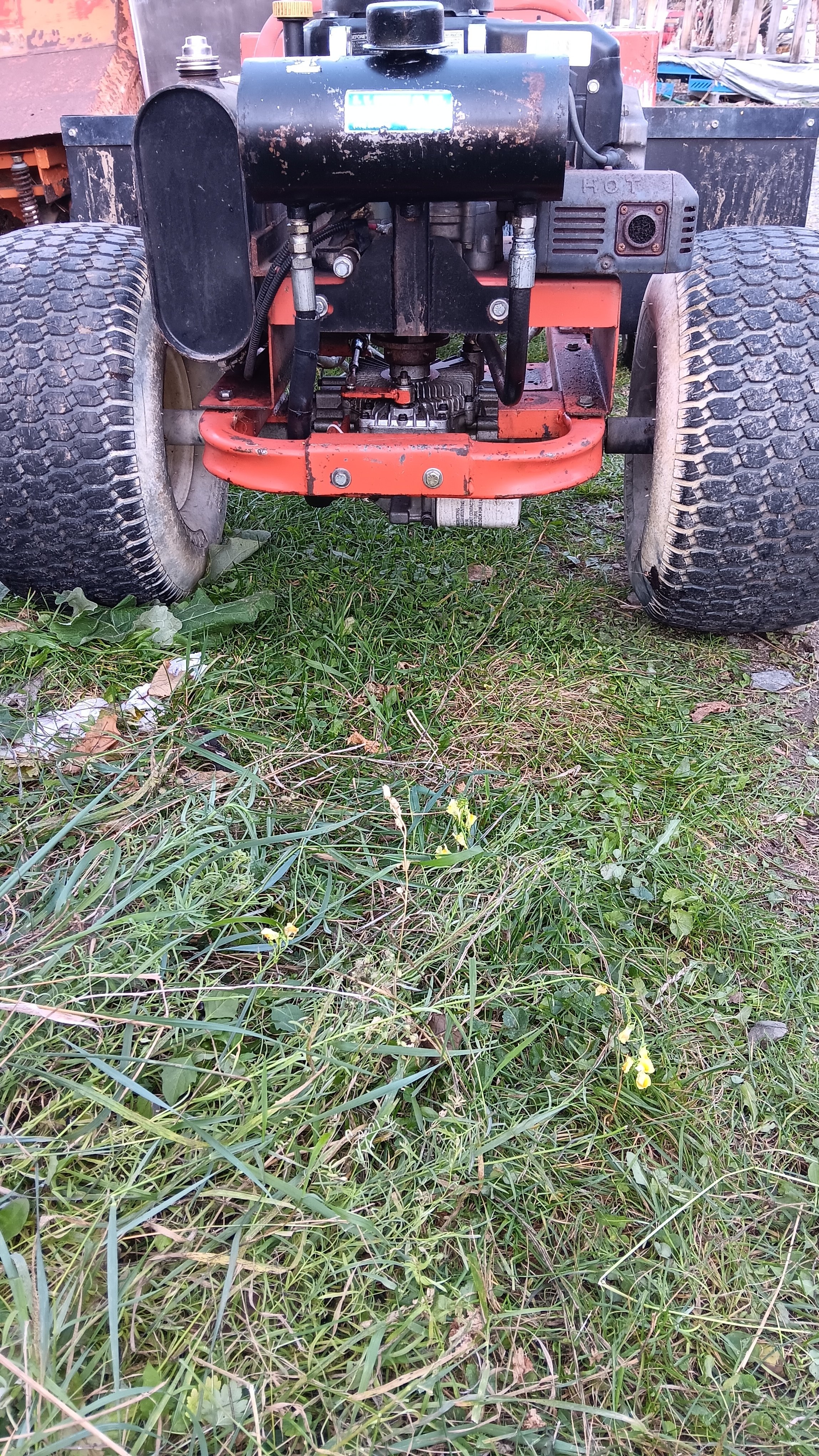

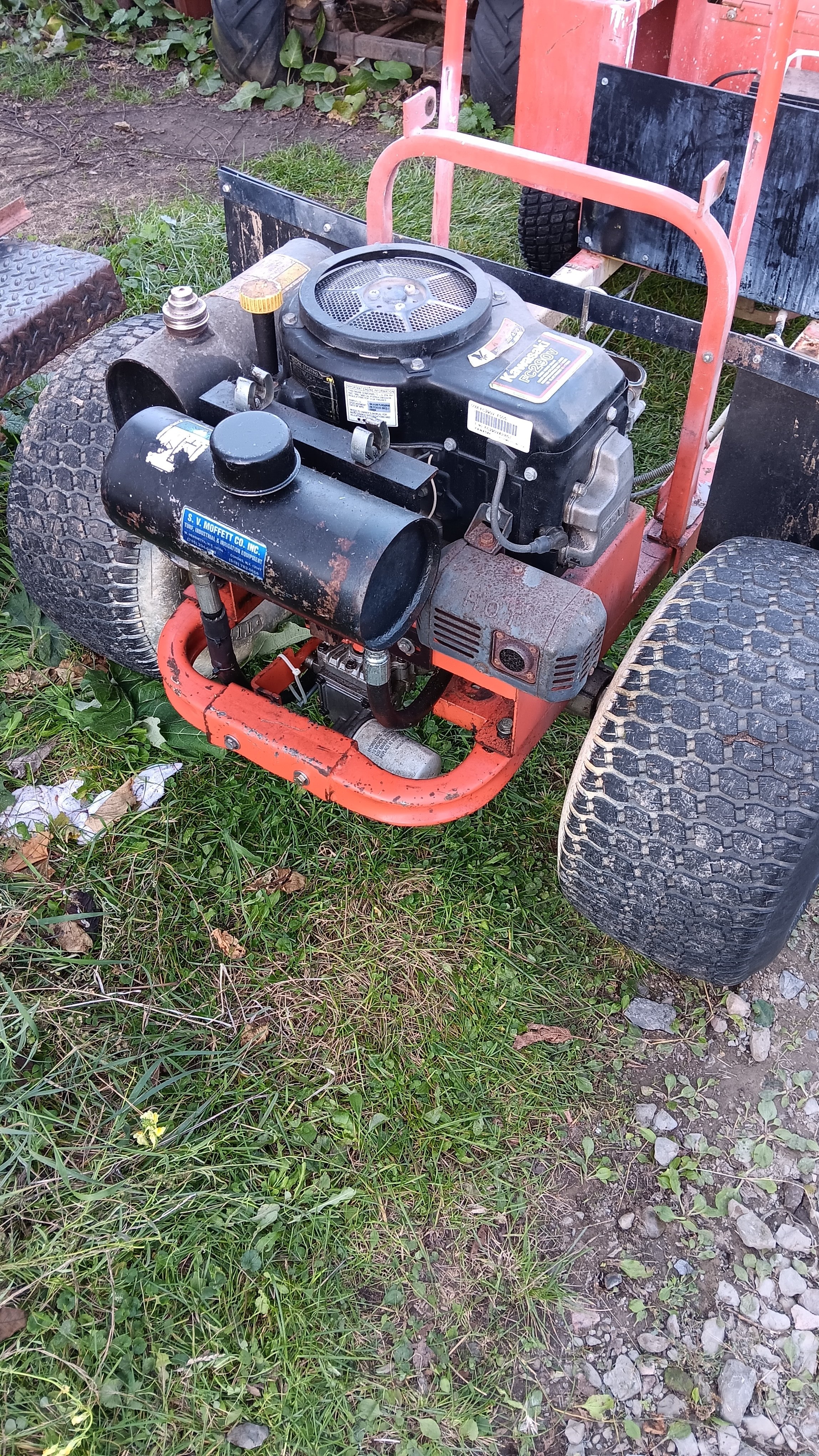

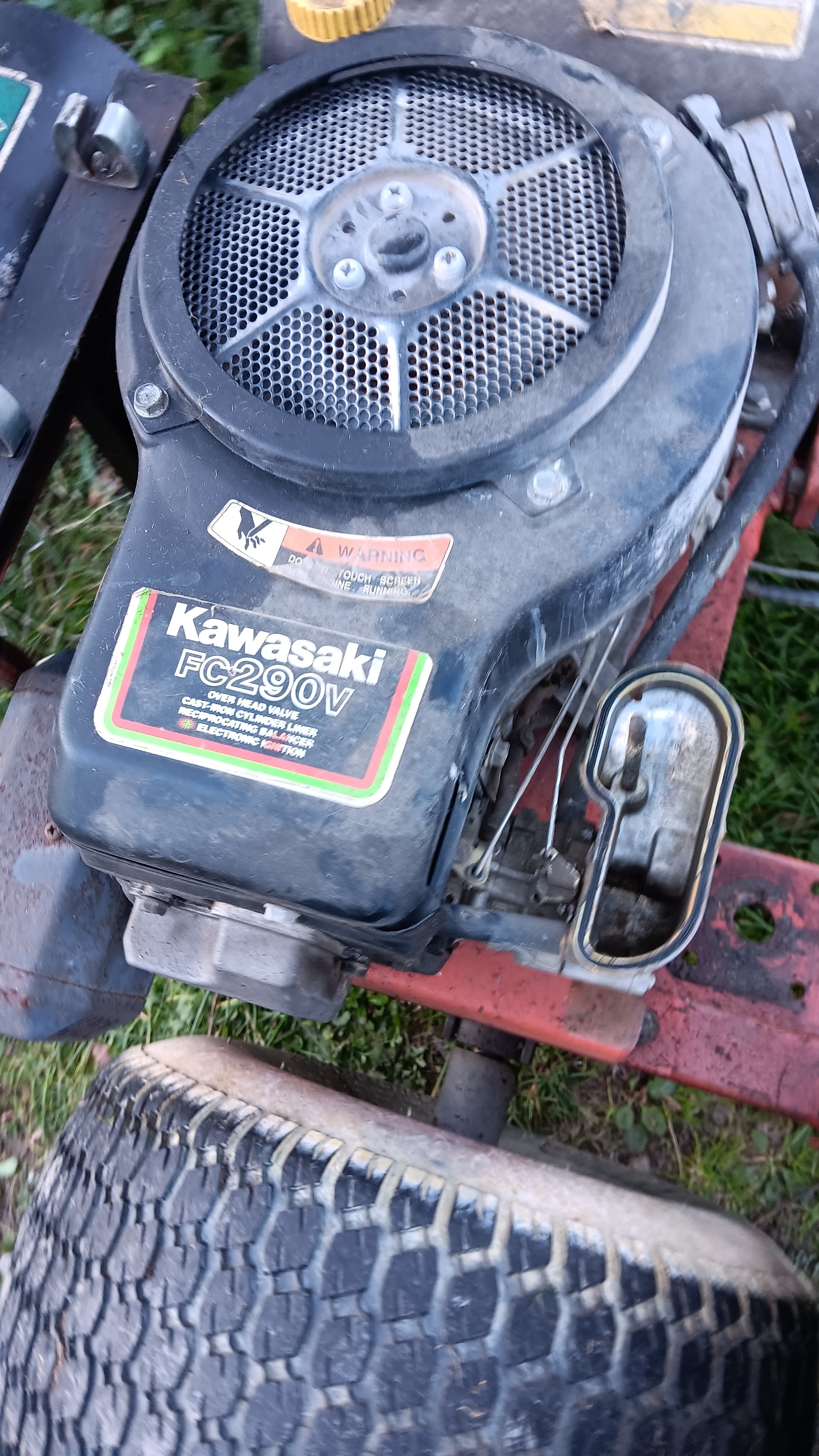

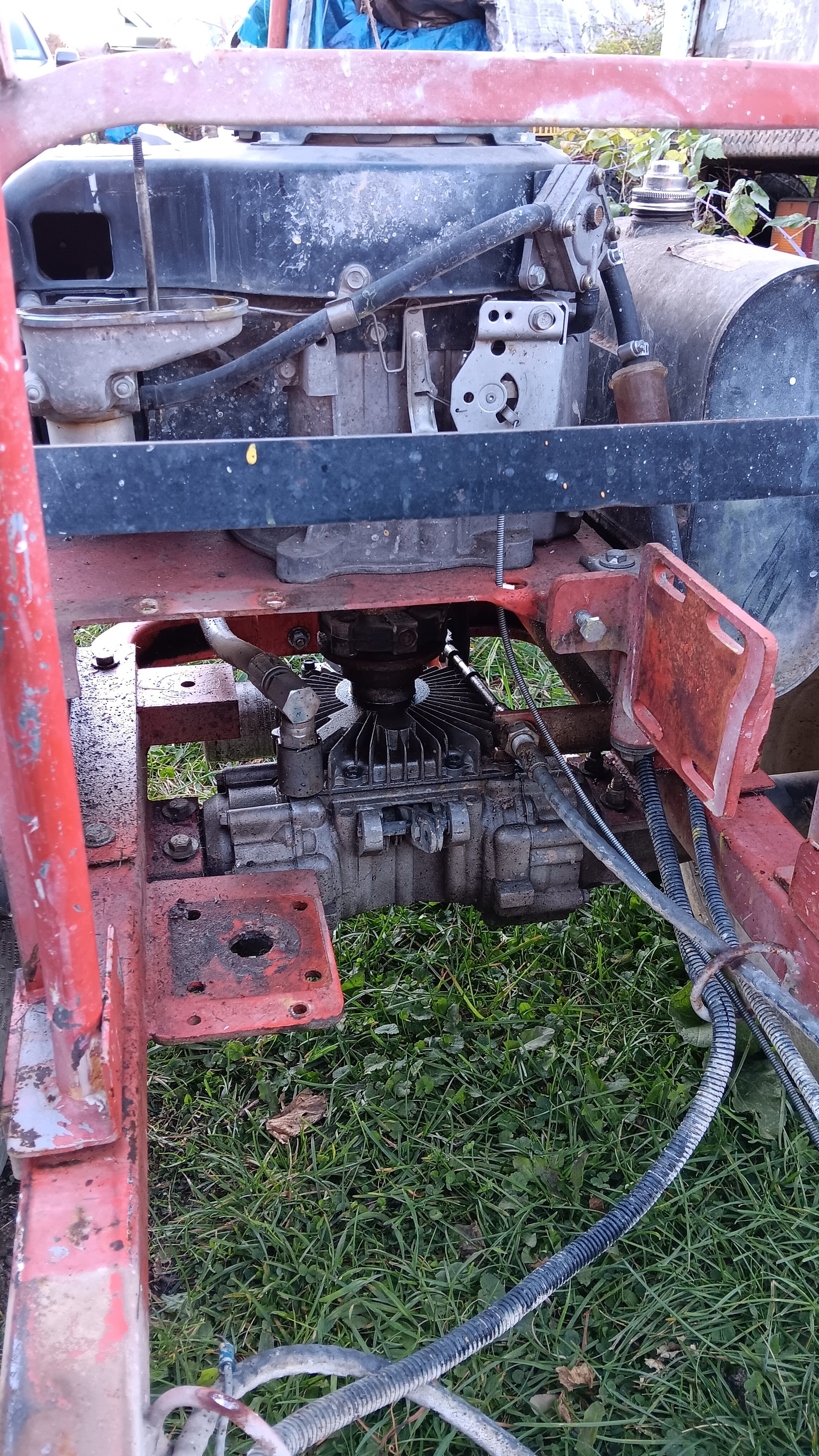

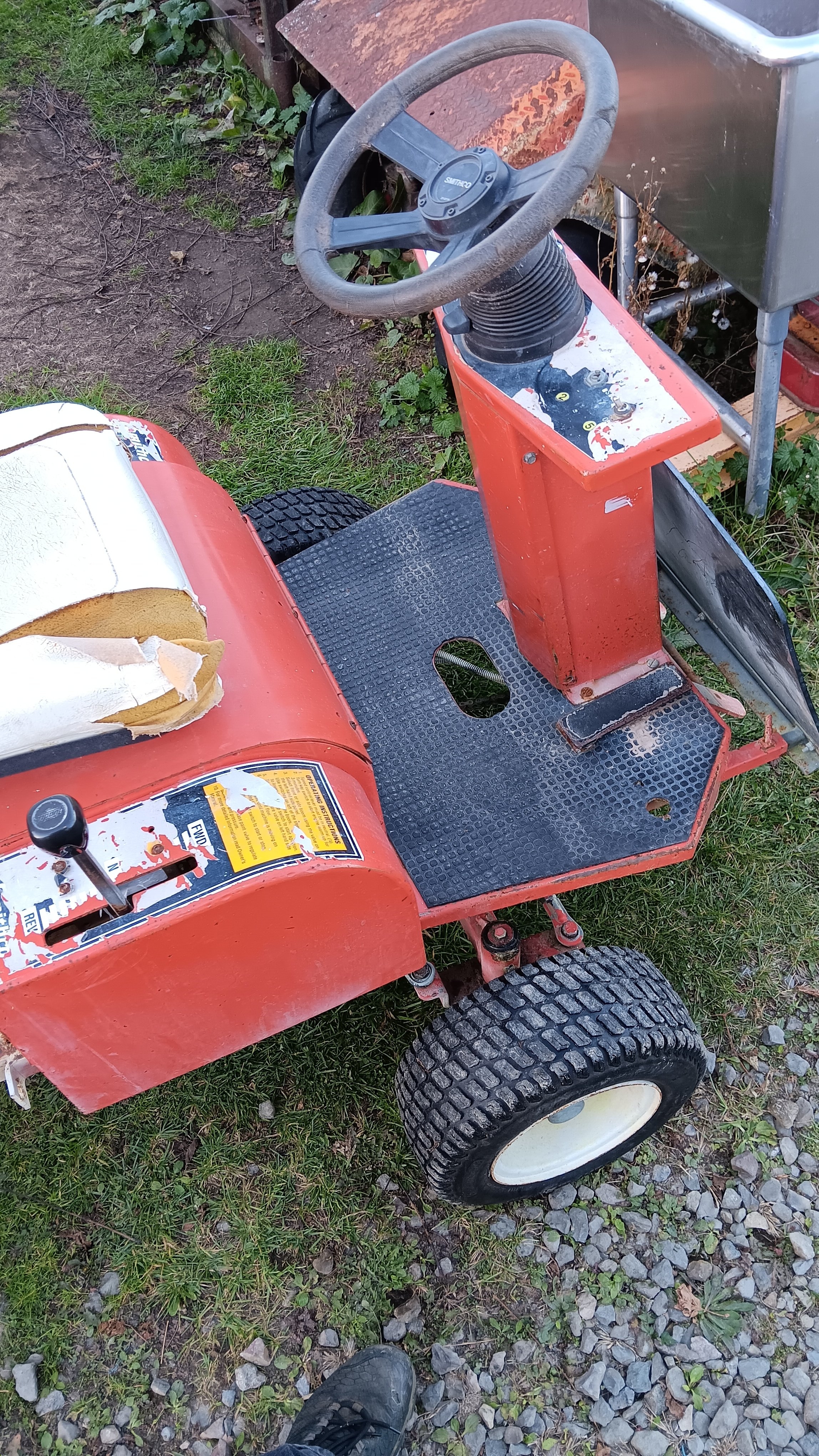

Some more pictures of the Smithco Line Stripe-er
The 9hp Kawasaki vertical shaft engine is very similar to the horizontal shaft engines used in Club Car golf carts.
It has an internal balance shaft. Drive is an Eaton 851 trans axle. It's got an internal wet brake (which Smithco
never used) and a bypass valve for towing. The way it is right now, there is no safety devices of any kind. Not
sure it even ever had a seat shut off switch. You can move the F-N-R lever and it will go, operator or not.
The pedal that's there was used to activate the spray booms. I plan on connecting it to the brake so it has
to be depressed to release the brake, spring return to brake on position.
