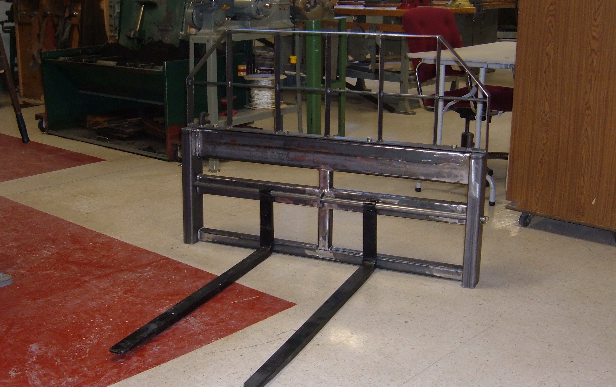

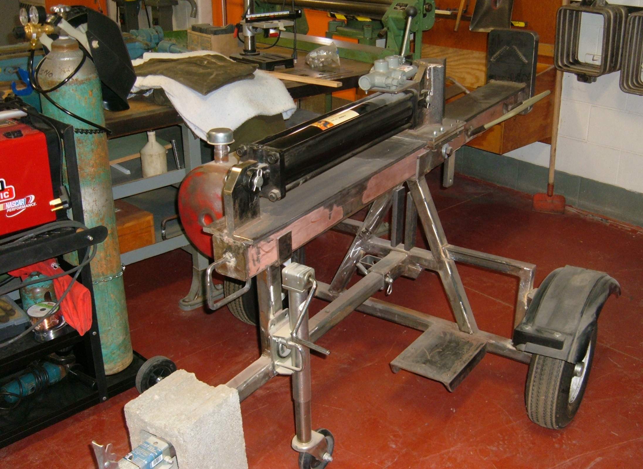

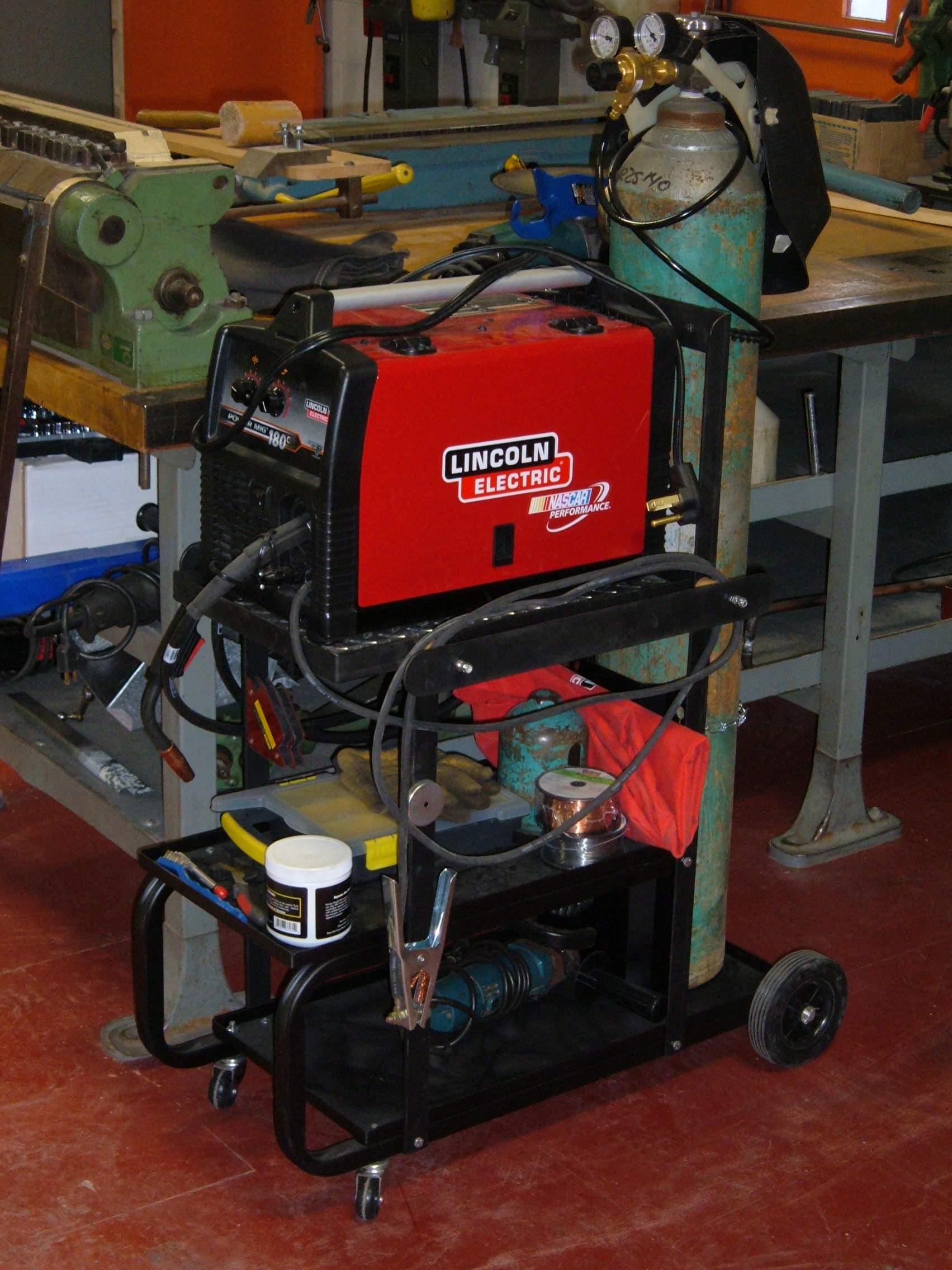

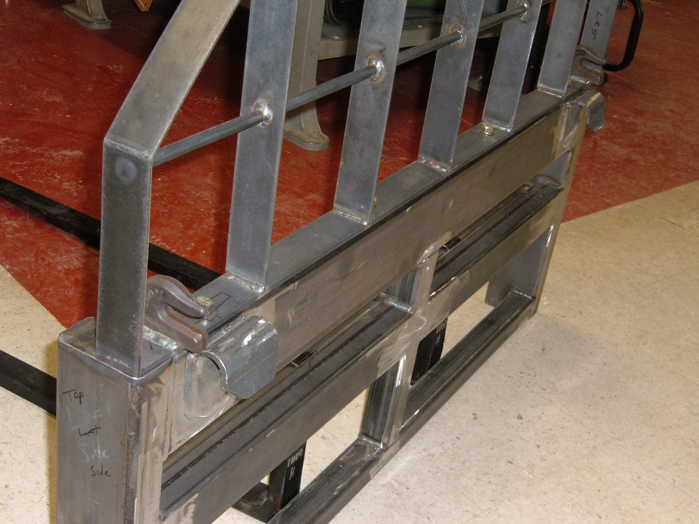

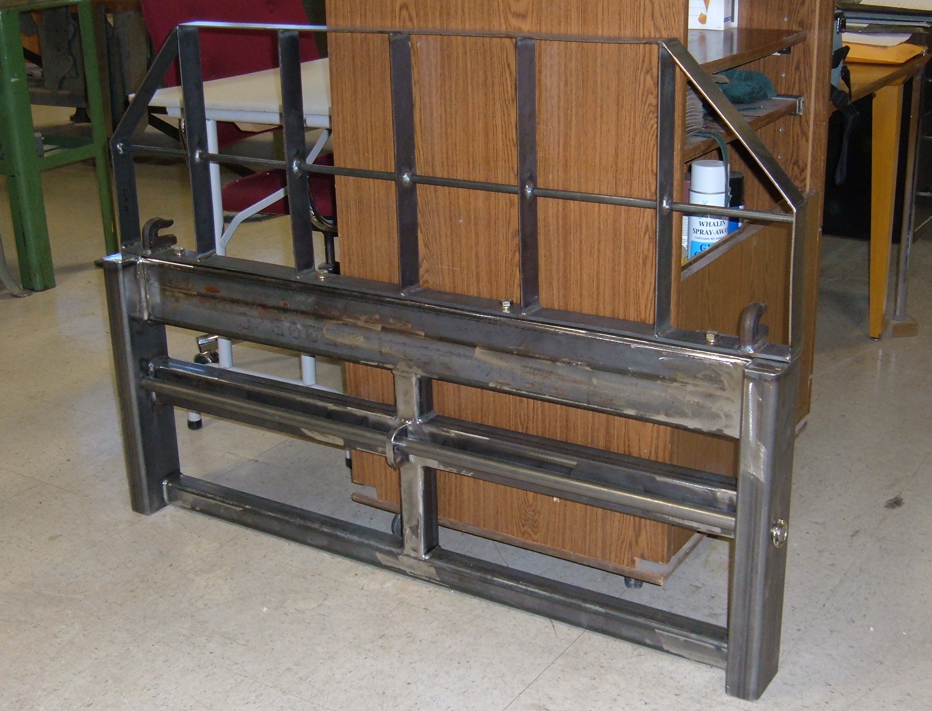

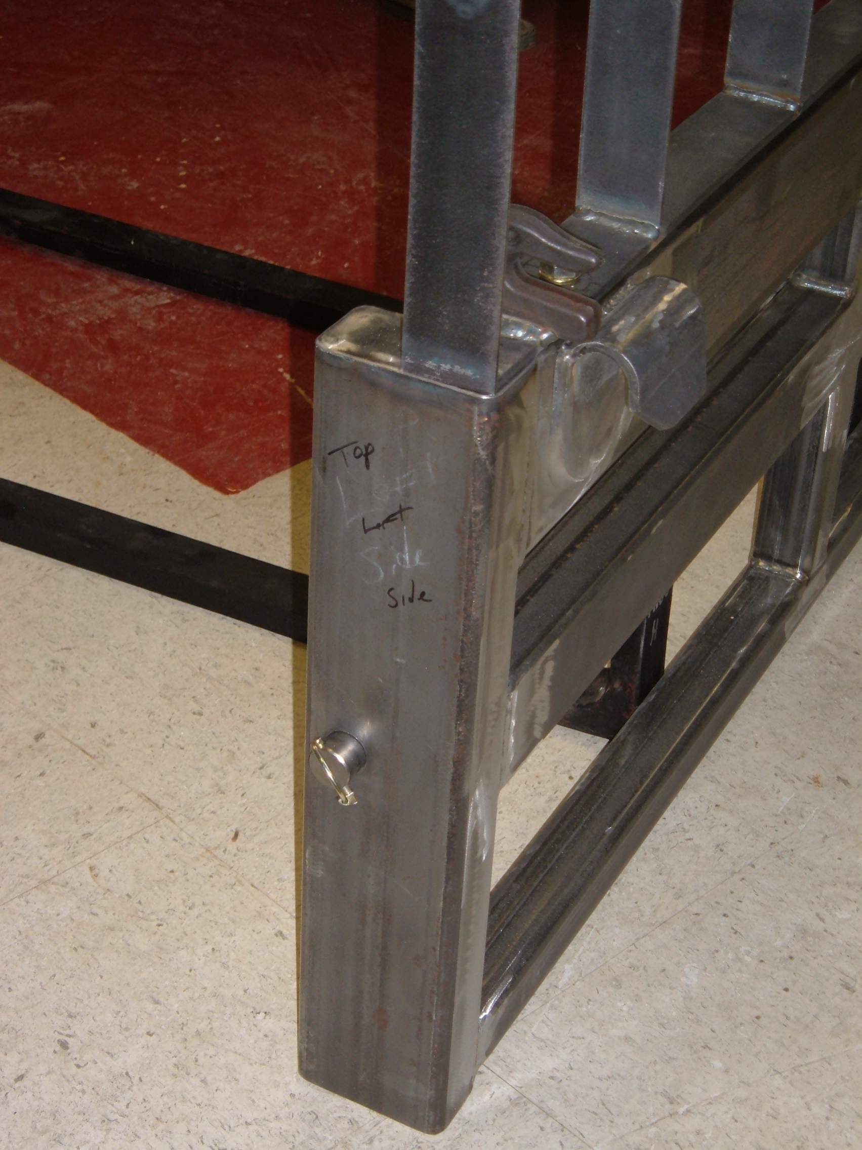

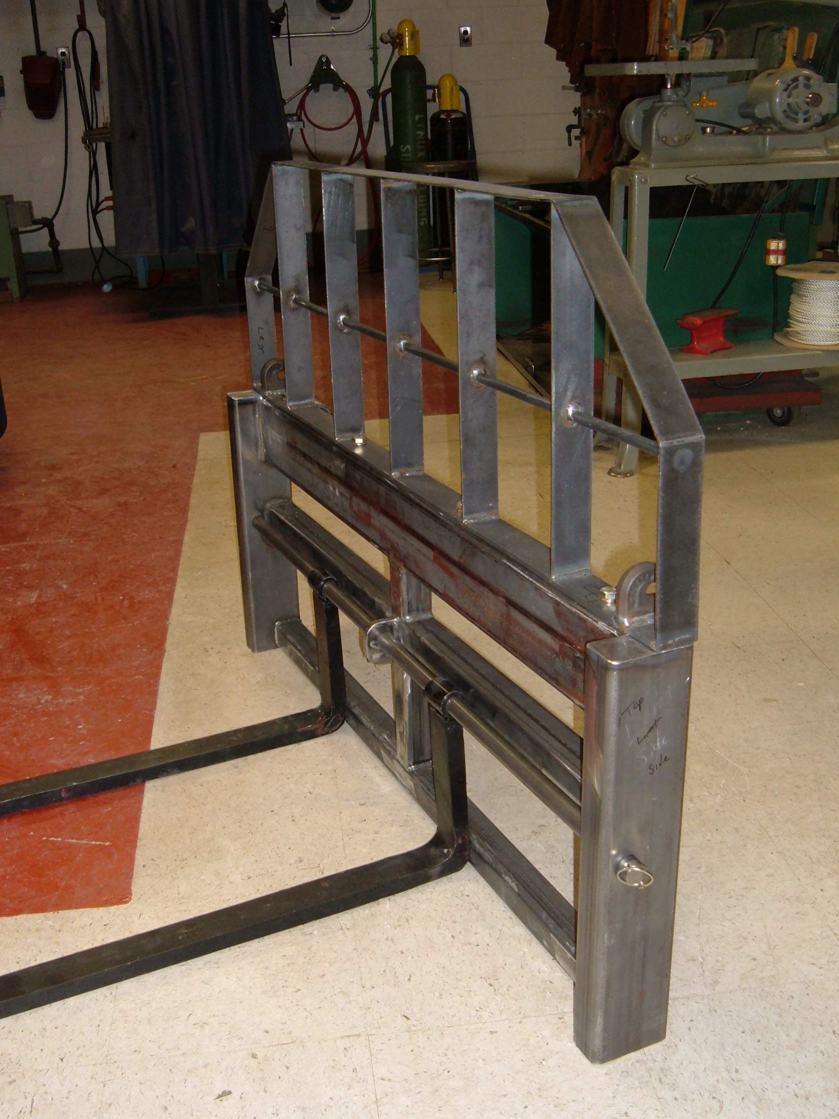

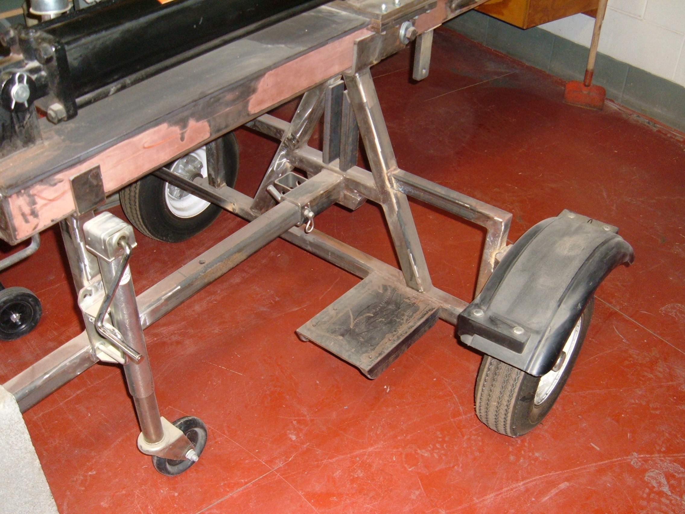

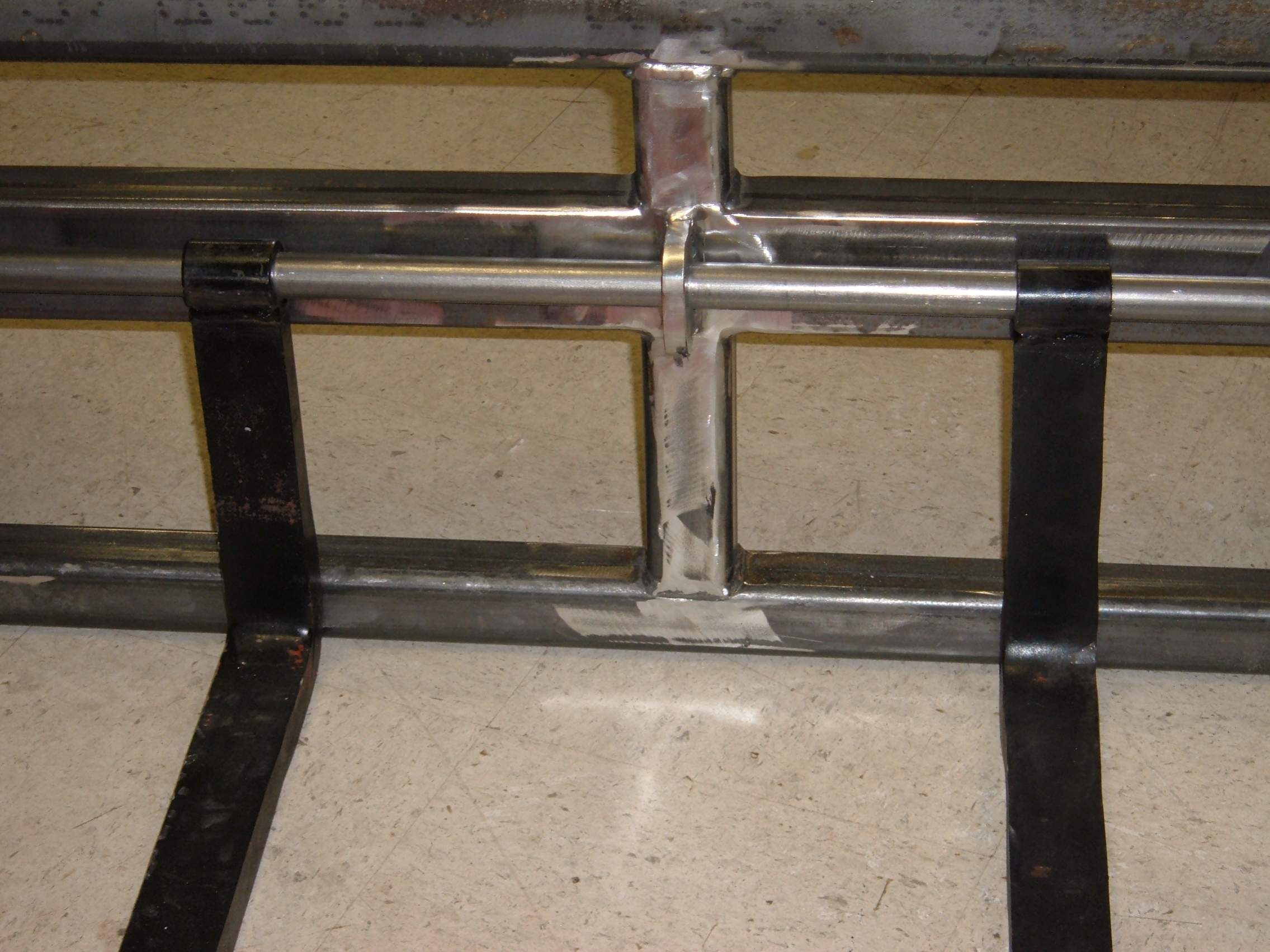

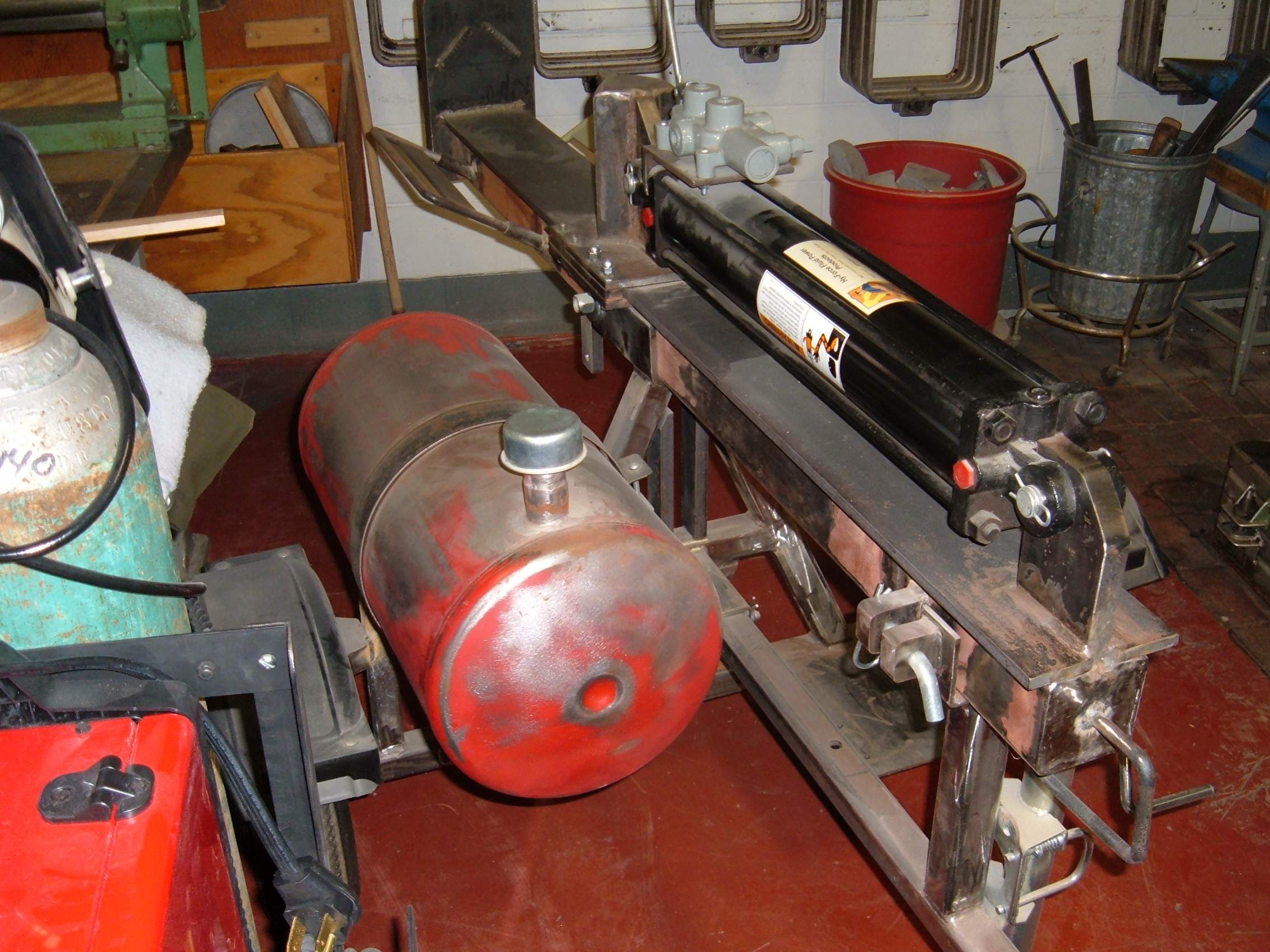

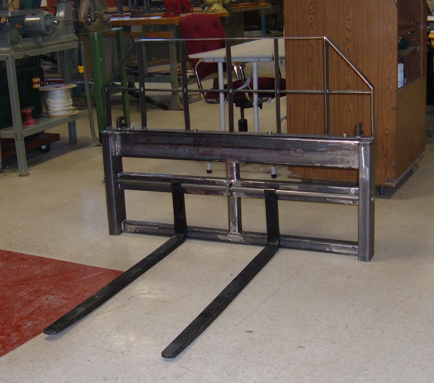

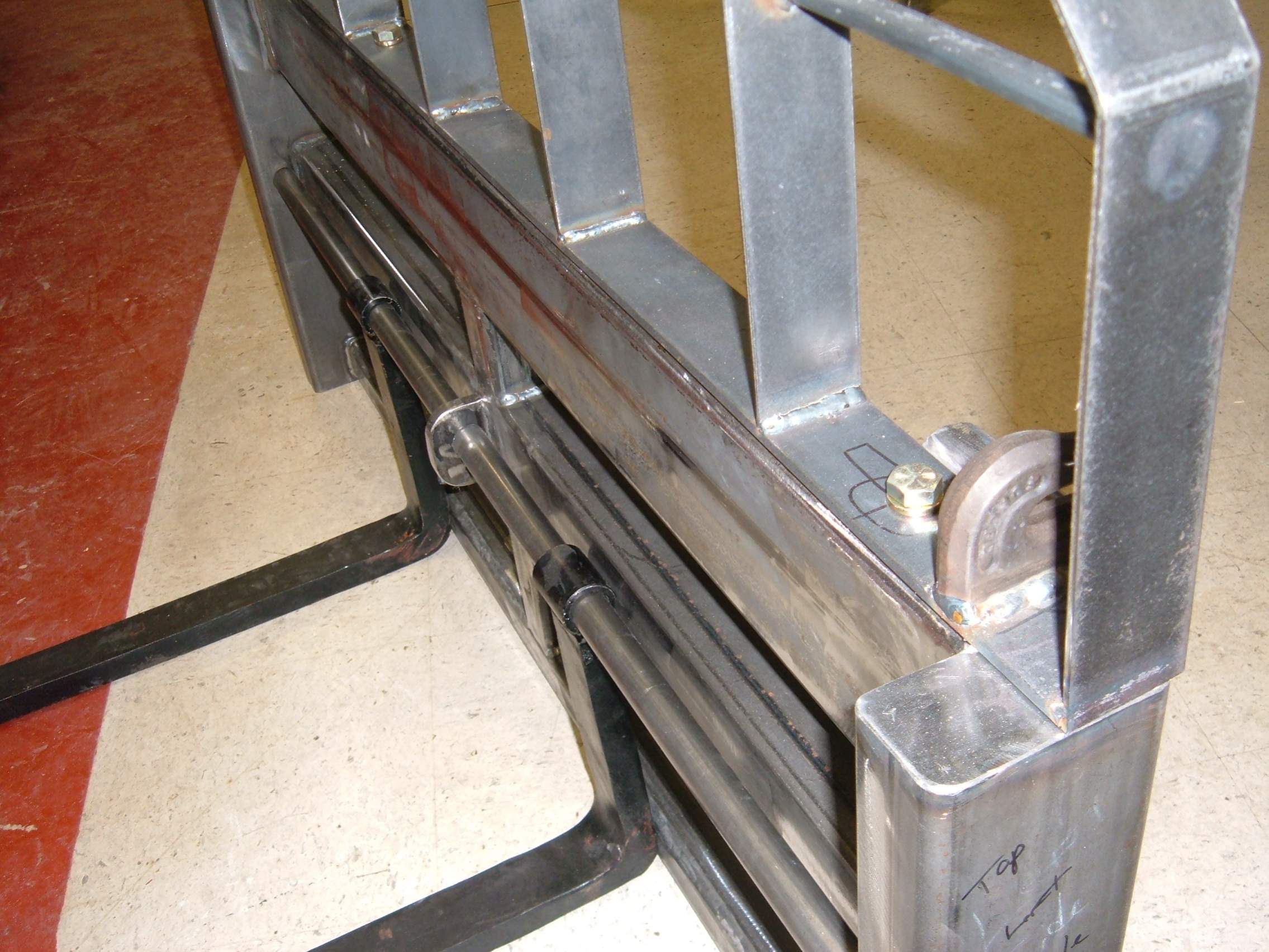

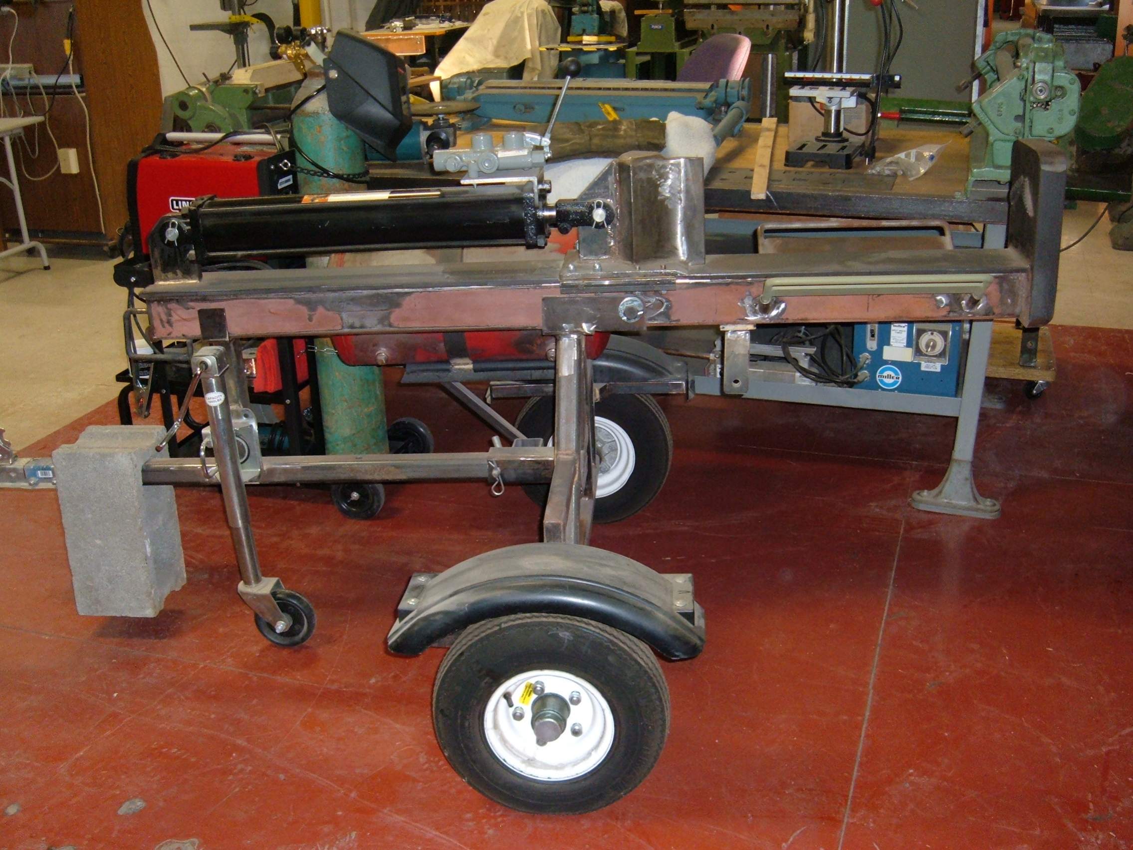

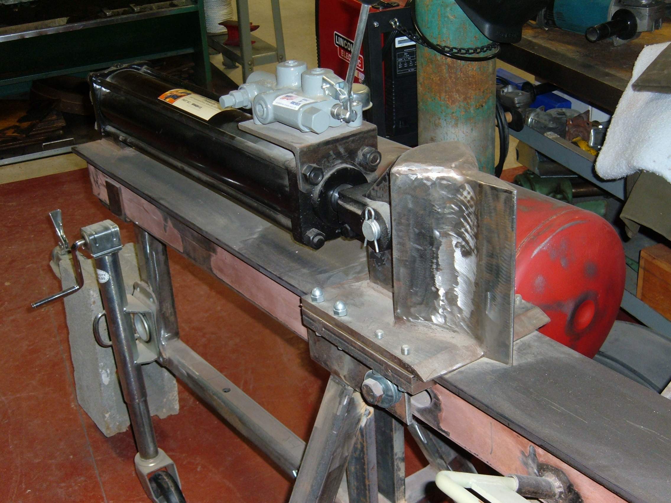

Those of you who are looking for a set of forks may want to build something like I did, I have a 200cx loader and John deere wanted close to $950 for a set of Frontier forks, I did not want to have such a heavy-duty set that was so heavy to lift. My loader has a capacity of about 1000 lbs, so I ordered a set of forks from www.budgetforks.com they were real nice to deal with, cost me about $150 for the pair plus a cross shaft for them. Then I set out to build something strong but lightweight, plus a few other modification such as a removable top guard, welded chain hooks, and easy to remove fork tines so I could store it in very limited space. I did alot of drawing on paper, and this is what I ended up with, I purchased the quick attach hooks and pins from John deere, I am still waiting to weld on the pins, (my loader is stored for the winter) With the money I saved I purchased a lincoln power-mig welder :D, so now I can build other attachments. I have about $275.00 in these and they will lift more than my tractor can! I can't wait to get them painted. I am also building a log splitter and have that all ready for paint. This is a hortizontal and vertical splitter. These have been fun projects to build in my off time. I am a middle school shop teacher and have access to many tools, and a nice warm place to work in the winter.....:)

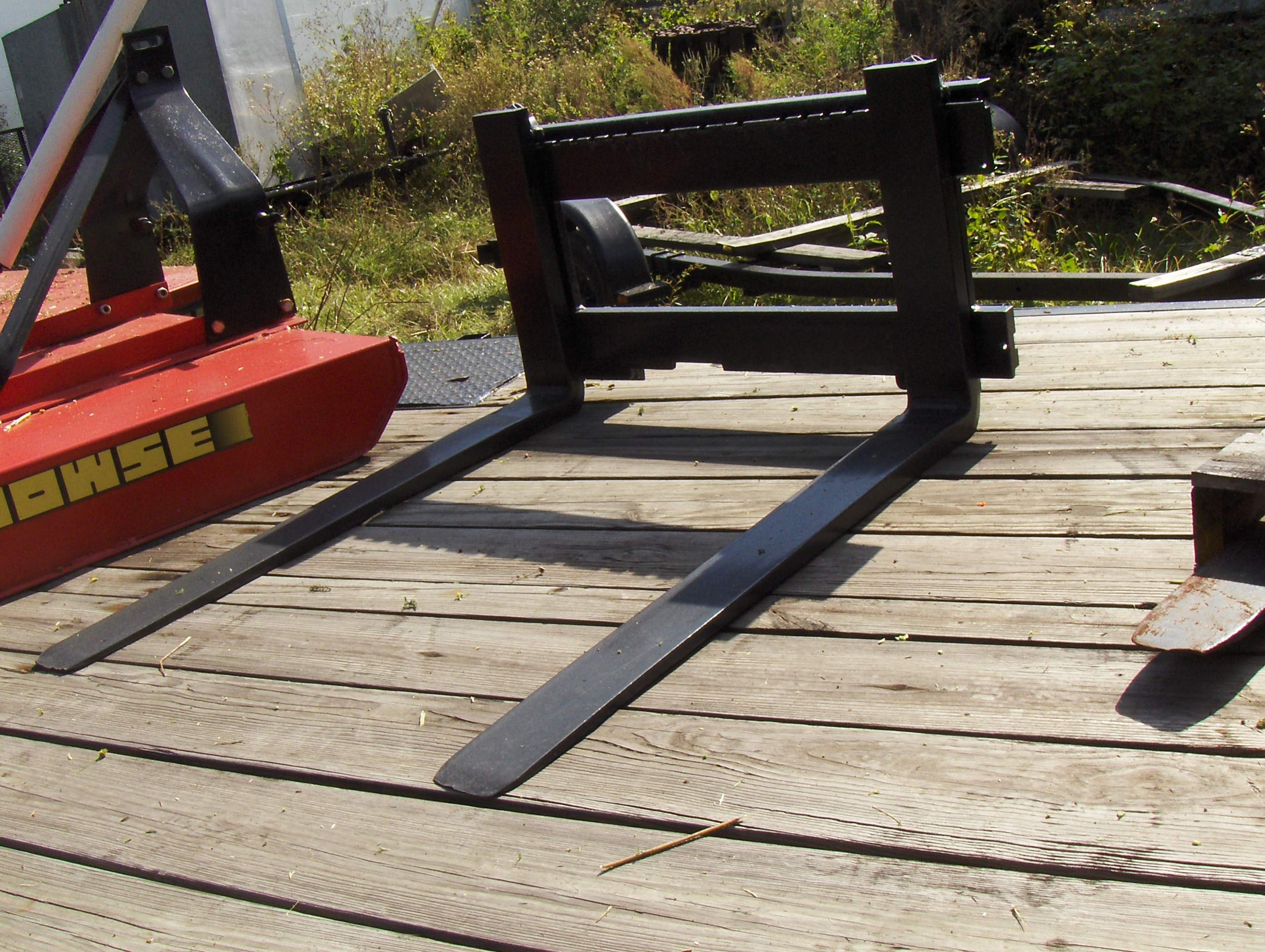

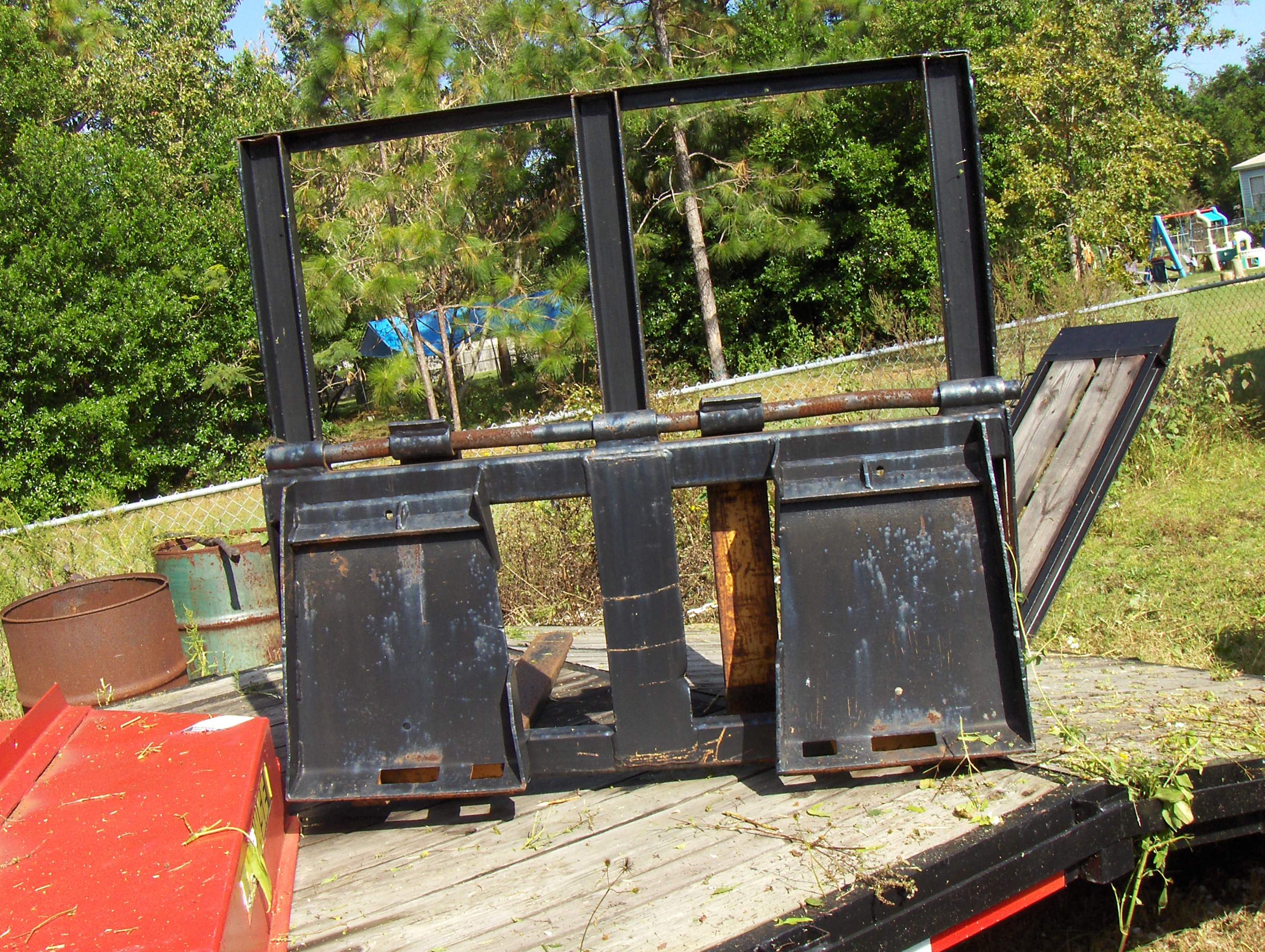

I have two sets of forks for sale, but they are in Florida. One set is the rod on top and the forks will fold. the other set looks like it came off of a fork lift slider.
