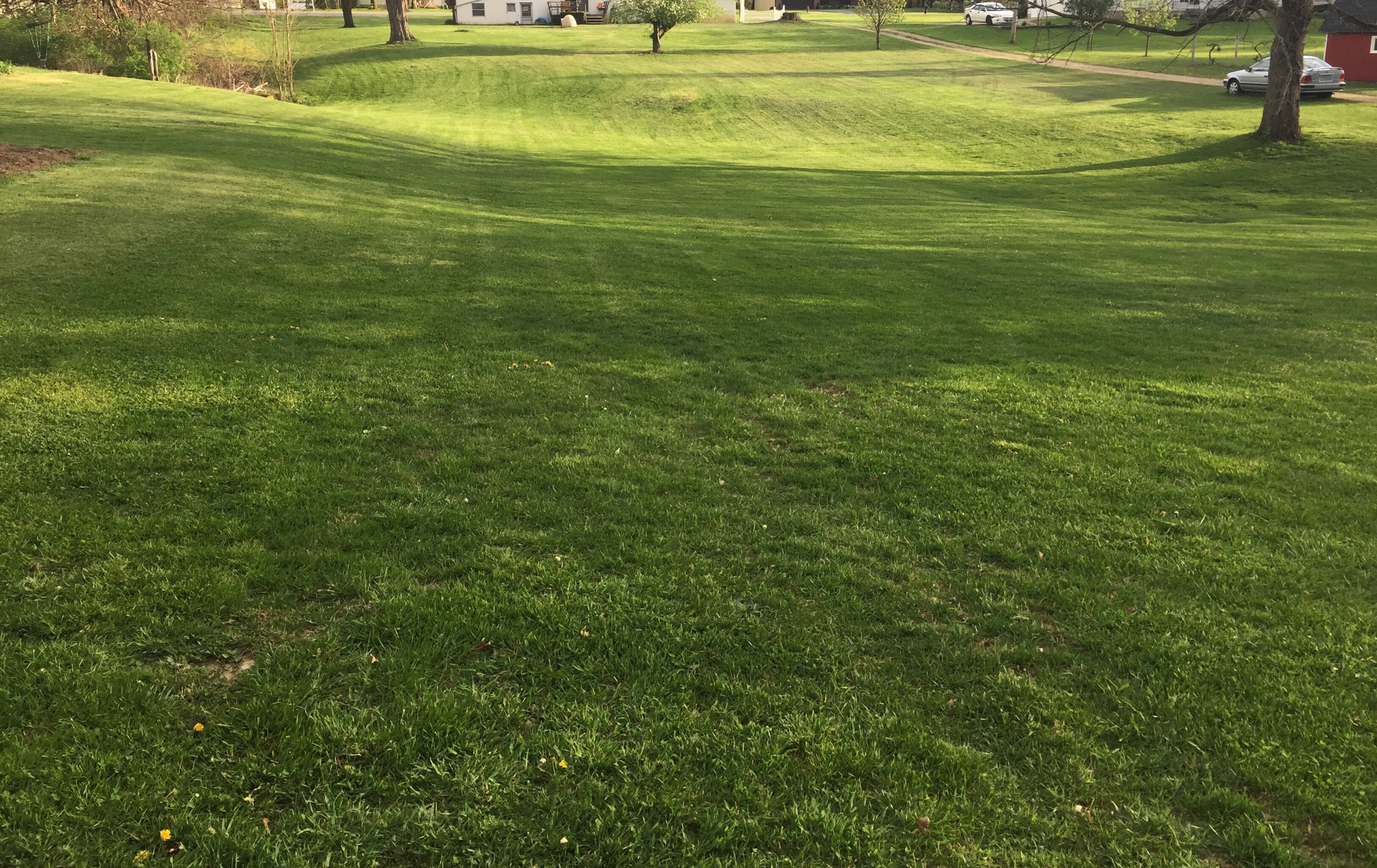

My 42" Craftsman HST was purchased in 2003 and has been used to cut grass at three properties all year and every year since new; it has almost 800 hours on it... One is small, a quarter acre. Other two are almost two acres each. All have hills.
Got a cut completed on two of the properties this year, then when engaging the blades, the idler pulley pulled out of the deck due to age/rust. Everything else on the tractor is solid and runs well. A new deck was just delivered for a bit over $200.
Take it as a recommendation if you want. This one has treated me well, I like it, and I would buy another like it if available and needed.

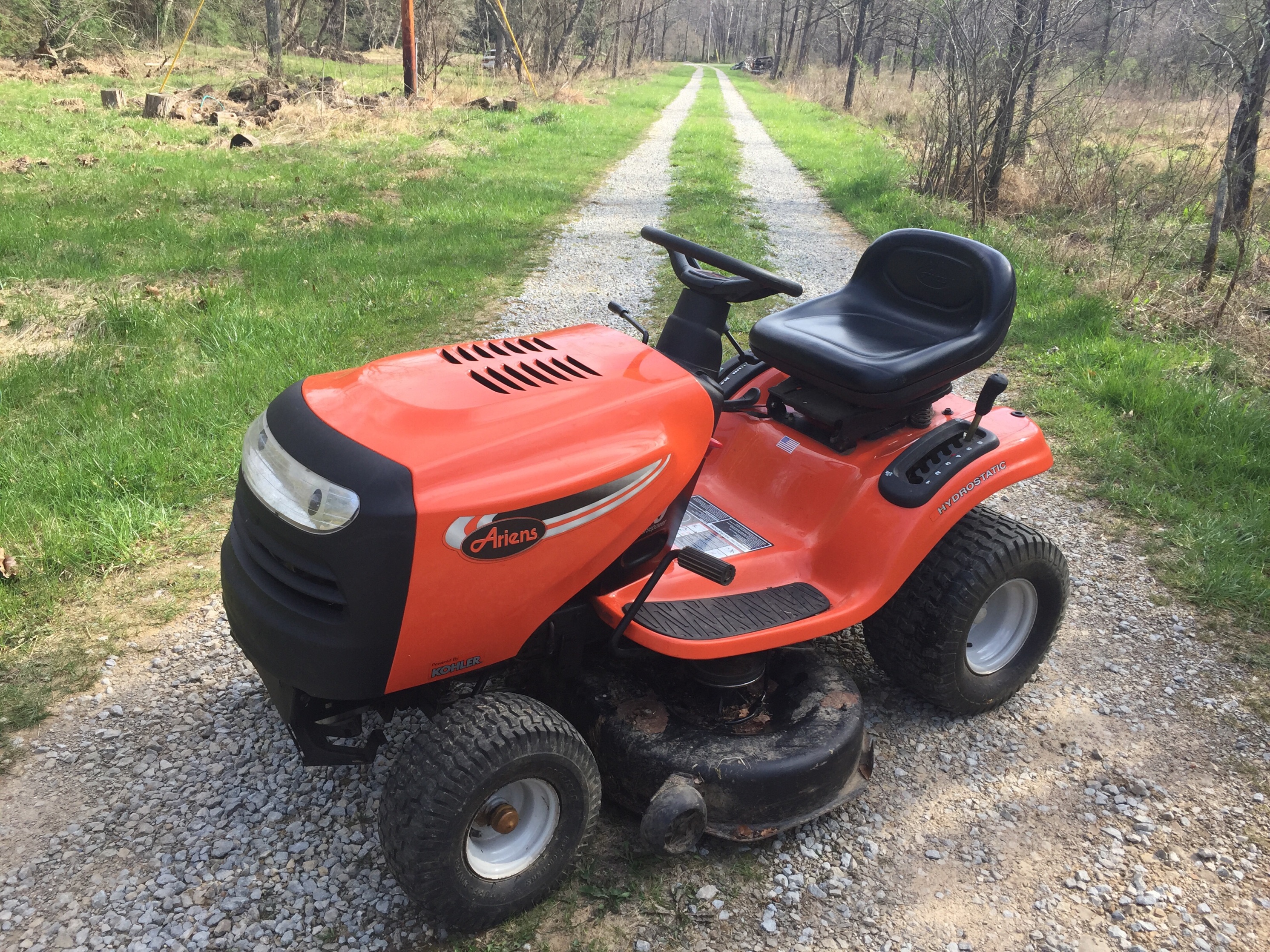

I have had really good luck with Husqvarna products, I bought an Ariens HST for my mother back in 2010 from HD and it's going very strong. IMG_7350.JPG

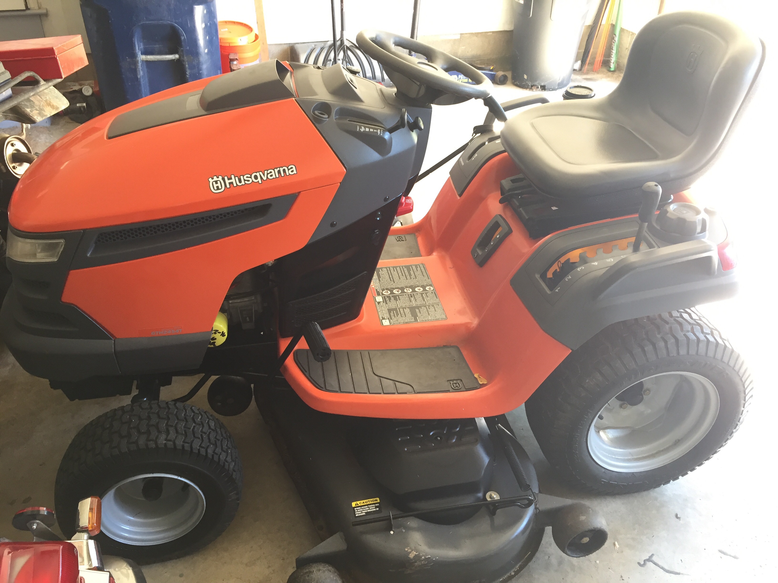

I personally have a Husqvarna older GT 24hp with 54in deck, it cuts great.
Husqvarna makes lawn tractors for many companies and I like them a lot, the steering gears have a zerks as well as the outer hubs, inner spindles on the front suspension and all the spindles on the deck has a grease zerk, the Ariens has 7 zerks being it's a 2 blade and mine has 8 with 3 deck blades.
Also I just bought a new set of blades for my husky off Amazon for $32 delivered to my front door and there made in the USA. The Ariens has lifetime blades, they send my mother a new set of blades every two years and I throw them on, usually by that time the blades aren't worth sharpening, she sucks up a lot of rocks and sticks down there.
For an acre I would look at something like that Ariens, I'm a fan of the Kholer over the B&S like what's in my GT but there both decent.
