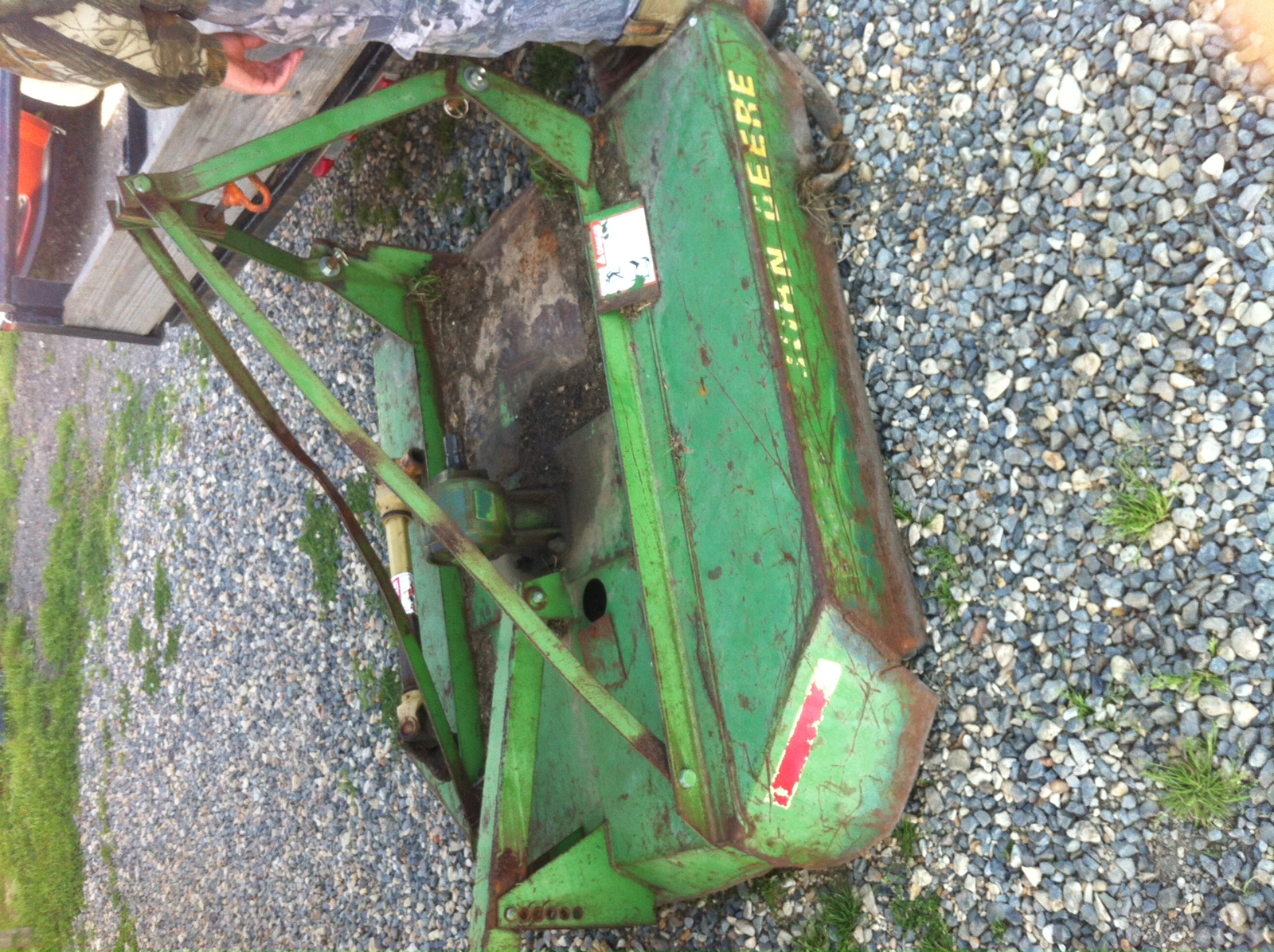

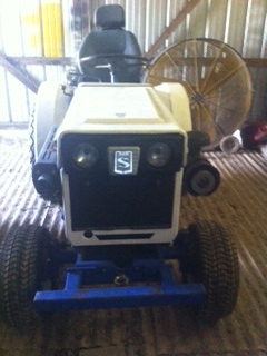

got this little tractor last week, trying to fine out what year it is any idea where i can locate the serial # at, also would any body know what model this bush hog would be i think it might be a 413 IMG_1051.JPGlil beaver.jpg :confused::confused:

There should be a number stamped on the left side of the tube just in front of the transmission. There should also be an aluminum sticker plate on the left front of the sheet metal near the radiator. I don't think there are records for the serial numbers and year of manufacture. You can search the Mitsubishi/Satoh group here and read for days. These 370 tractors were made mostly in the 70s. At this age, the year it was made is not very important.

If cutter is 4' then either a 403 or 413. Look for the SN tag on the frame rail.

only thing i can make out on the sticker is s370.
if i am correct they were made from 1977 to 1980
do you know if parts were all the same in those years ???
it needs a little TLC and from web search might be hard to fine parts for it.
i did fine the air filter cap and baffle new form kubota there B4200 has the same air filter set up.
also thinking of putting a cat 1 quick hitch on it but not to sure on how to adapt it on the cat 0 set up,
   / need a little help #5
According to tractordata.com you have a Satoh Beaver S370 made from 1977-1984 with a Mitsubishi engine.
