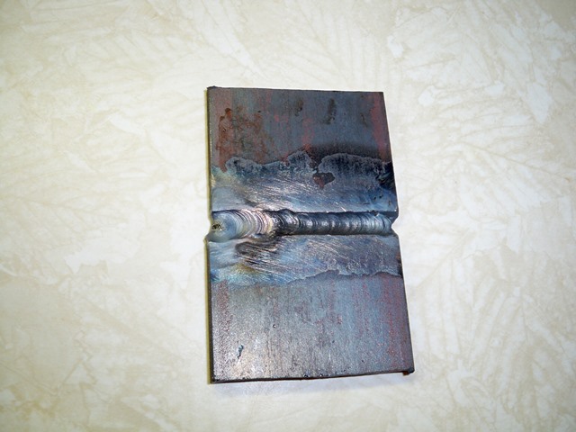

I am still trying to get an acceptable weld on 3/16 mild steel. I can make the top side look really good. the bottom is not an acceptable 100%. there is a little suck back. This is an open root weld. Roughly 37 degree bevel. I have gaped it 1/8 and 3/32 used 3/32 filler and 1/8 filler. The 3/32 filler seems to work the best, wit a 1/8 gap but still not an acceptable 100% weld. I have yet to see a key hole some may call a fish eye. anyone have an idea as to what I am doing wrong.
/ Need a few tig tips #2
Do you use the lay wire technique, or dip the filler rod?
I like 37 1/2 degree bevels. 3/32-inch gap, and use 1/8-inch filler rod. I run around 90 to 95 amps. For the hot pass I only go up 10-amps, and switch to 3/32-inch filler this helps prevent suck back.

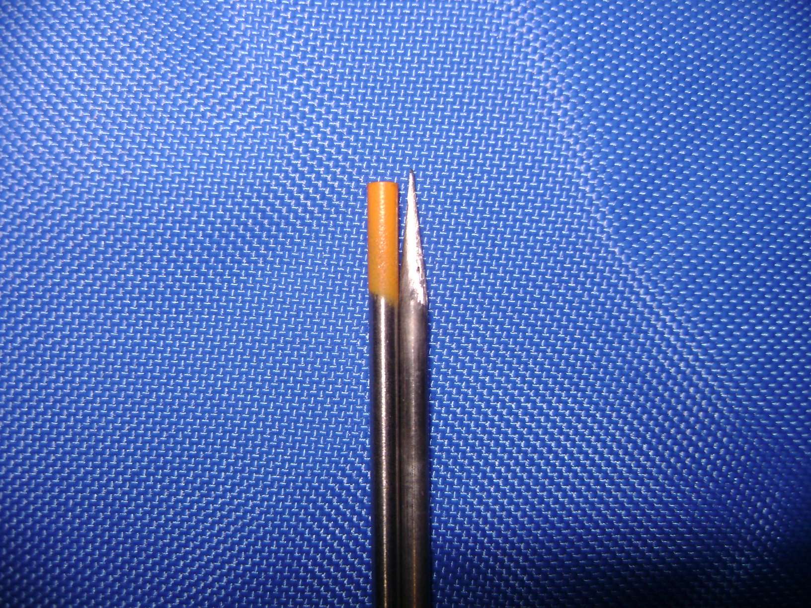

Couple thoughts:
How are you sharpening your tungsten? For open root welding I like a real long taper.

The tungsten is sharpened fairly long maybe not as long as the one you show. I will try a little longer. The distance between the two pipes is pretty narrow so I was trying to just go straight with no side to side movement. The pipe is eight joints of 2 1/2 inches and four will be 1 1/2 inches. The 1 1/2 pipe has a wall thickness of .130, a tad over 1/8 inch. I haven't tried the thin weld yet. I have yet to see a key hole, that is why I went to a 1/8 gap. And I still do not see a key hole. I am doing something wrong somewhere.

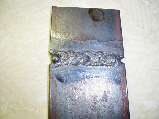

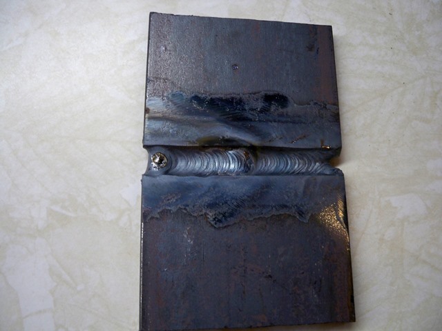

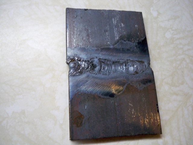

I went down to 3/16 material and turned the machine down to 65% of the 40 to 190 range The first coupon is 3/32 gap, and 3/32 filler rod. I never really saw a key hole, just fuzzed the two pieces together moving the torch back and forth a little, and added a little filler. Second picture is the under side it has a lot of suck back and is very wide. Why is the under side so wide. The third picture the pieces are at a 1/8 inch gap There I saw a small keyhole and added more filler the key hole disappeared though and I continued to add filler. The underside is still wide and still has a little suck. Why are the undersides so wide. I though I would get a 1/8 or so bead on the underside. You can see I stopped midway just to see what the underside looked like.

/ Need a few tig tips #10
Because you are cooking the plate. Too much heat, or too slow of travel speed.
Try a 37-degree bevel. 3/32-inch gap, and use 1/8-inch filler rod. Along with the lay wire technique. Push real hard on the filler rod. Like you are trying to push it through the plate. Also make sure the puddle is just a hair bigger than the width of the 1/8-inch filler rod.
I think you will a lot better results just starting out with open root welding.

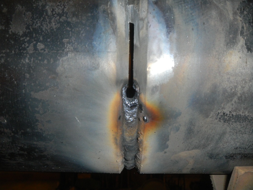

/ Need a few tig tips #11

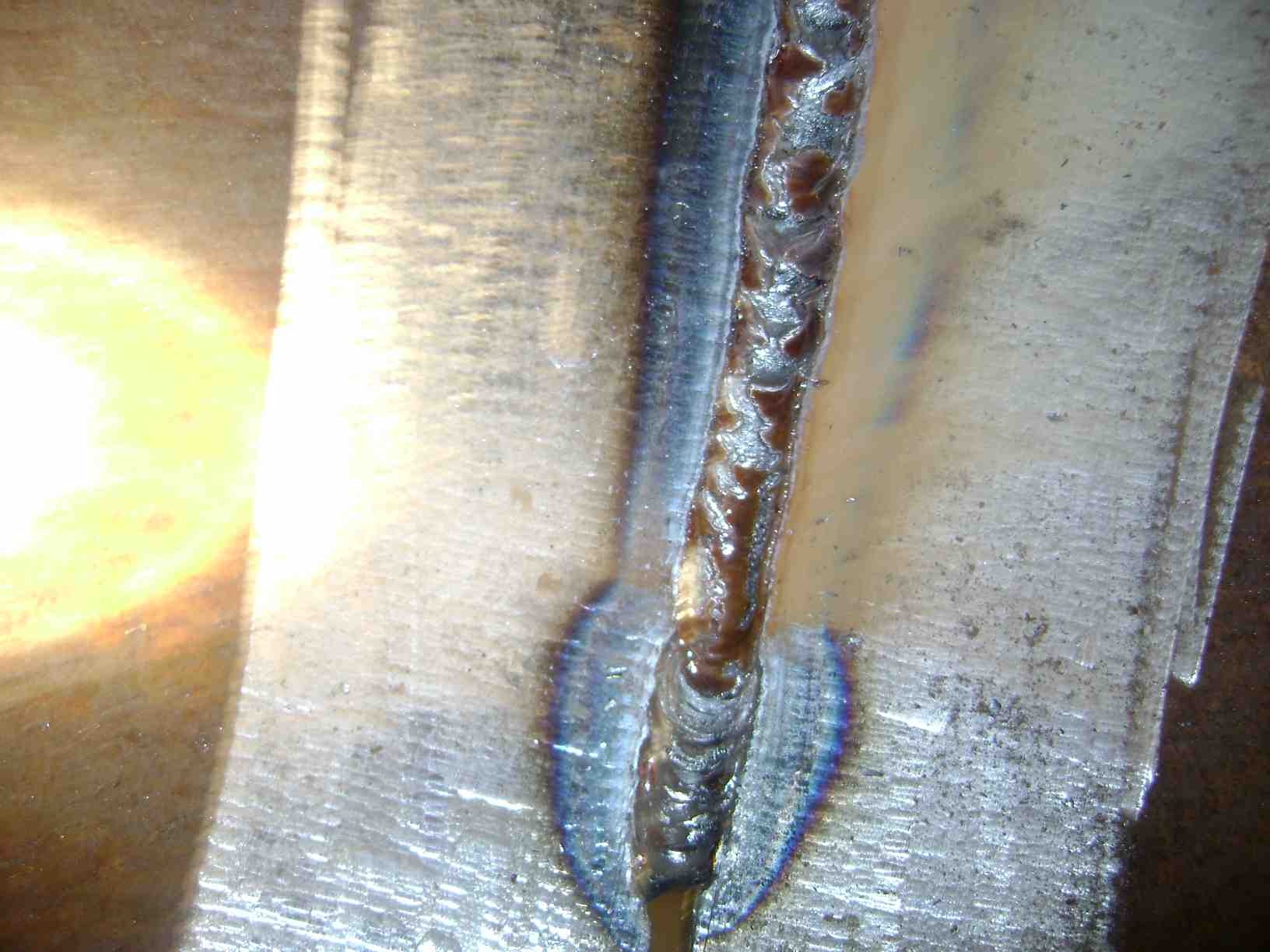

Here is a picture of open root welding with 6010. But it is a good picture of a key hole.

I was thinking along the lines of too much heat. I will cut some more coupons today and give what you suggested a try. I was going to try a bevel with no land also. And turn down the heat. Thanks
#13
Shield Arc, I have turned the machine so it just makes a puddle and still get a wide weld on the under side. On another post I have about this job someone suggest using 6010 root and 7018 rest of the way out. I don't have any 6010 on hand so I used 3/32 6011 on a coupon. by using a little more amperage than I was using with the tig I got an acceptable weld on the back side. The only problem is the flux on the back side. I can't get it off inside the pipe and as it breaks off over time it will destroy the pumps. I have a 110 wire machine I am tempted to use and see what I get. Can a guy get any different results with an inverter tig machine or would the end result be the same?

For TIG prep, I grind the bevel to 37 Degrees with feather edge landing. Depending on the size pipe or length of plate in your case, a gap of 1/8 to as much as 3/16" or more is set. The gap will close a bit during welding and if the weld is large enough like for instance a 24" or larger pipe, you may start with with 1/4" at the bottom and use a 1/8 or 5/32 rod then switch to 1/8 as the gap tightens and perhaps finish with a 3/32. I have had to take a grinder and widen the gap when it closed completely up.
In your case, I think you are running too many amps, not feeding enough wire and possibly travelling too fast. You need to keep the key hole open in order for the bead to be above flush on the inside. If it closes up due to travelling too fast, stop and grind the weld thin so you can burn thru it and then continue with keyhole welding.

Gary, I ran a couple of coupons on 3/16" hot rolled material with the 1/8" gap and ground to a point , no land, it looked pretty darn good. A few more of those coupons and I should be up to speed. I ran roughly the same amps as I did before with the land, But with the land and a 1/8" gap I could not get the key hole. So the problem was having the land.
