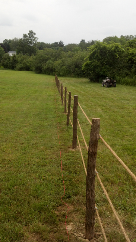

I just completed a fence project which entailed putting in 70 locust fence posts in rocky soil. I would recommend sizing the PHD to your tractor and either gat one with a slip clutch or have plenty of sheer bolts on hand. I went through about 50 sheer bolts for 70 holes. It helps to have a helper with a digging bar to get the larger stones while you stay on the tractor.

Woody65 - Nice fenceline ! Those are pretty straight locust posts. Do you have a good commercial source for these?......Gary
Haoleguy,
Thanks for the compliments. I got the posts from a local guy who goes into the woods and cuts all his own stuff. Found him on Craigslist.
