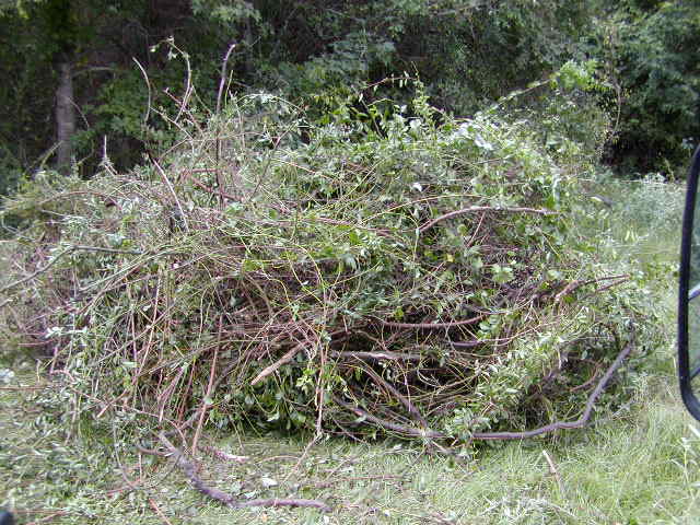

Re: Neal\'s Root Rake Grapple
same pile in grapple
Notice, the tree sticking out the front

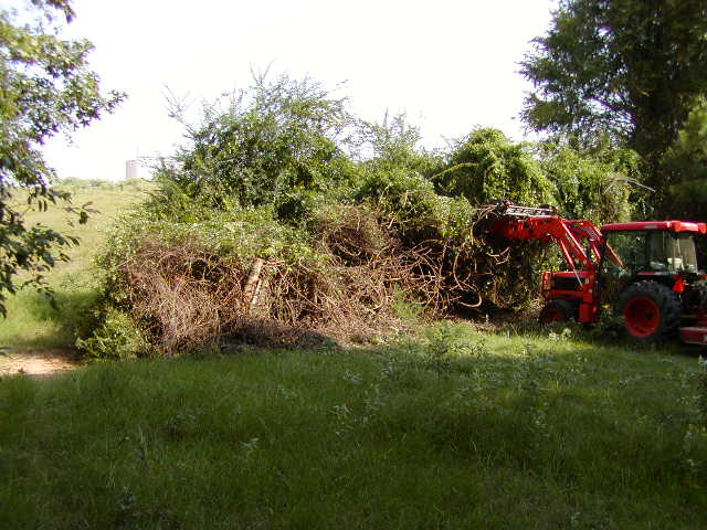

/ Neal's Root Rake Grapple
#22

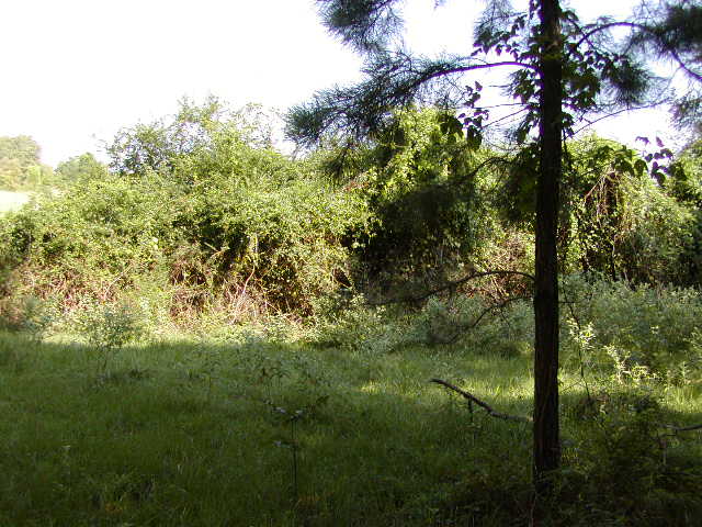

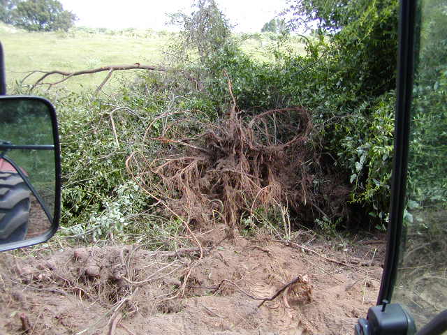

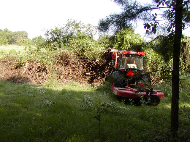

#23
One hour progress report.
I have only gotten out of the tractor to take a total of 18 pictures.
Have cleared over 50'.
Is not hauled off yet, but this is another nice feature of this grapple. You can move a load, set it down, and when you go back, it will have been crushed the first time to a smaller pile & the second time is normally easier, so you don't mind setting down a load.

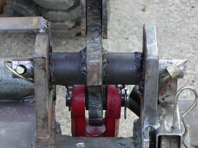

The claws are welded to 2"x1/4 wall x59" long sq tube. When something is only hitting the center teeth, it bows the sq tube. So far it has always returned. I try to watch it, because I am afraid it will bend it badly if I were to close too hard. I have been thinking about adding a truss to it with solid web so brush won't hang in it. This makes me wonder where the next weakest point might be.
It punches holes through air conditioner cabinets as if they were news paper or just crushes the whole thing if you don't get off of it.
Somewhere on tbn, I think I posted a picture where it was holding 3 pieces of concrete, in sandwich fashion, where only 1 grapple tooth was touching a maybe 200 lb piece of concrete. I couldn't believe it. Turned it down & it still stayed. Cut the tractor off, went for camera and then took picture.
I had to rebuild my hinge which was spanning about 5" with a 1" pin and it bent the 1" pins. Works good now though.

#38
Hi Hasmat,
My hinge hasn't given any more problems since I redid it.
No, instead of shortening the span, I took a sucker rod coupling, drilled it out to 1", installed 2 grease zerts on each arm & welded to either side of the grapple and made the hinge almost full width of the span.
I think that is one problem solved.
Attached is picture of the new hinge. Not shown, on the back side I put braces welded both to the center piece and the additional width of the hinge.
