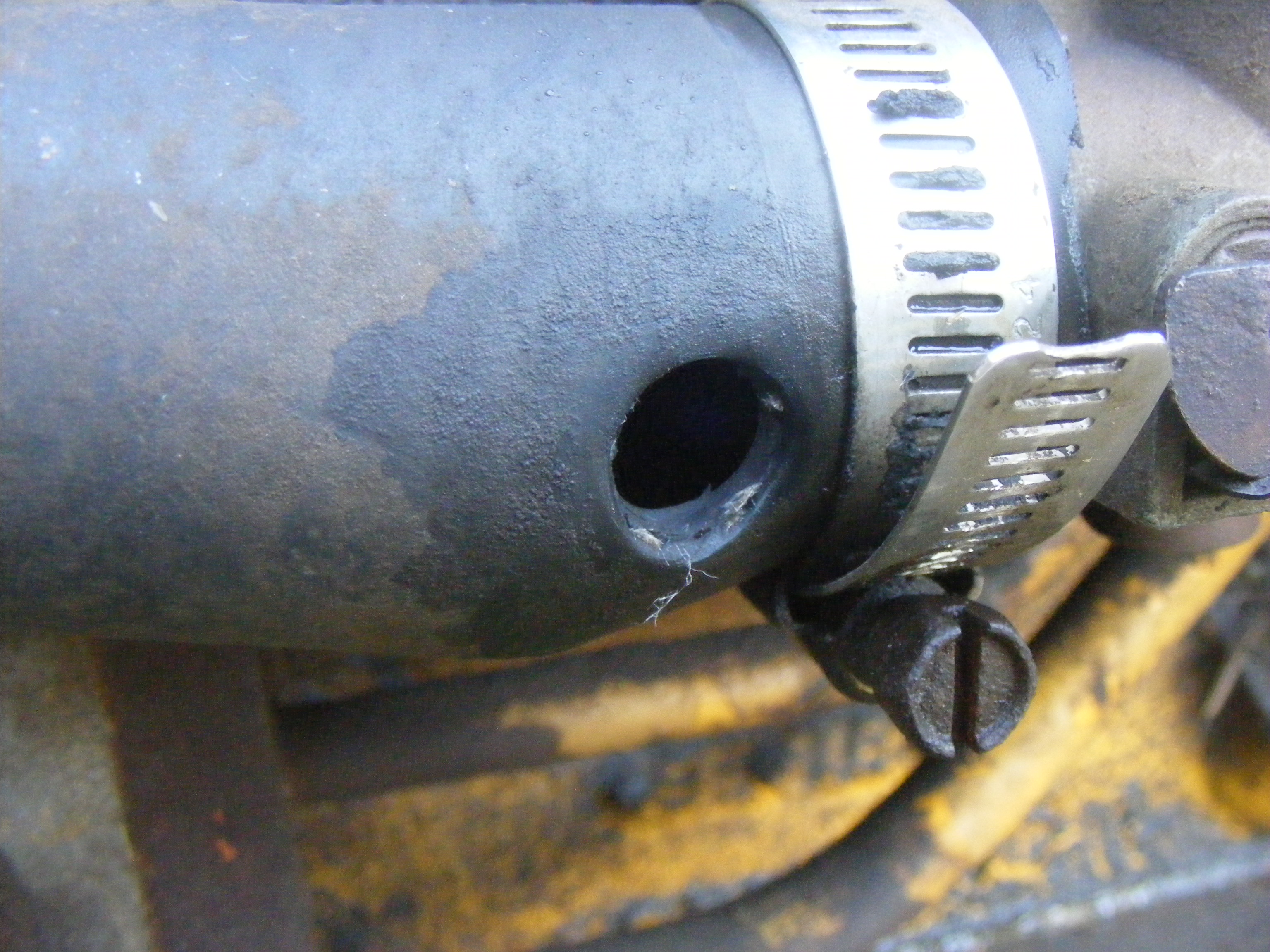

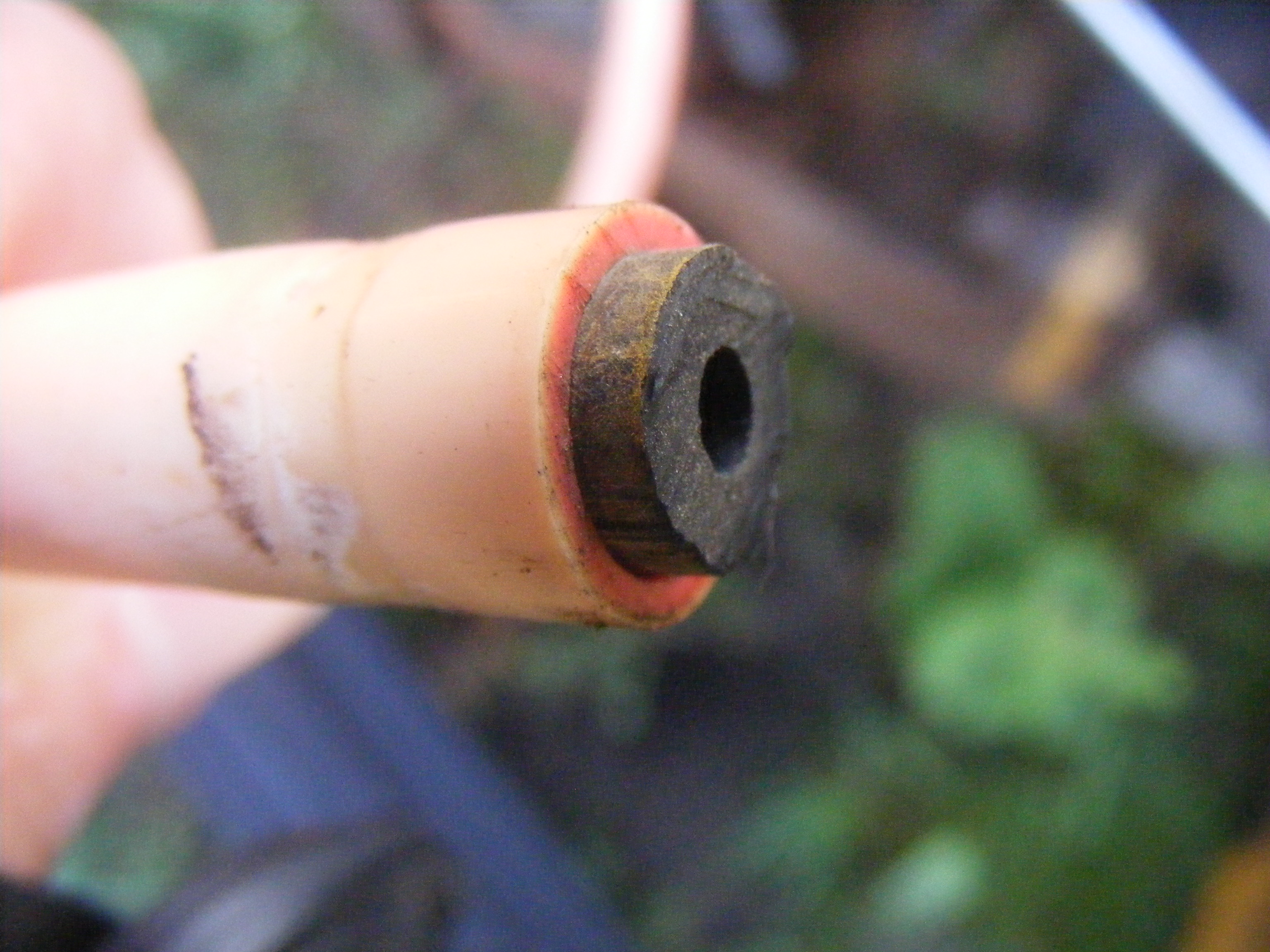

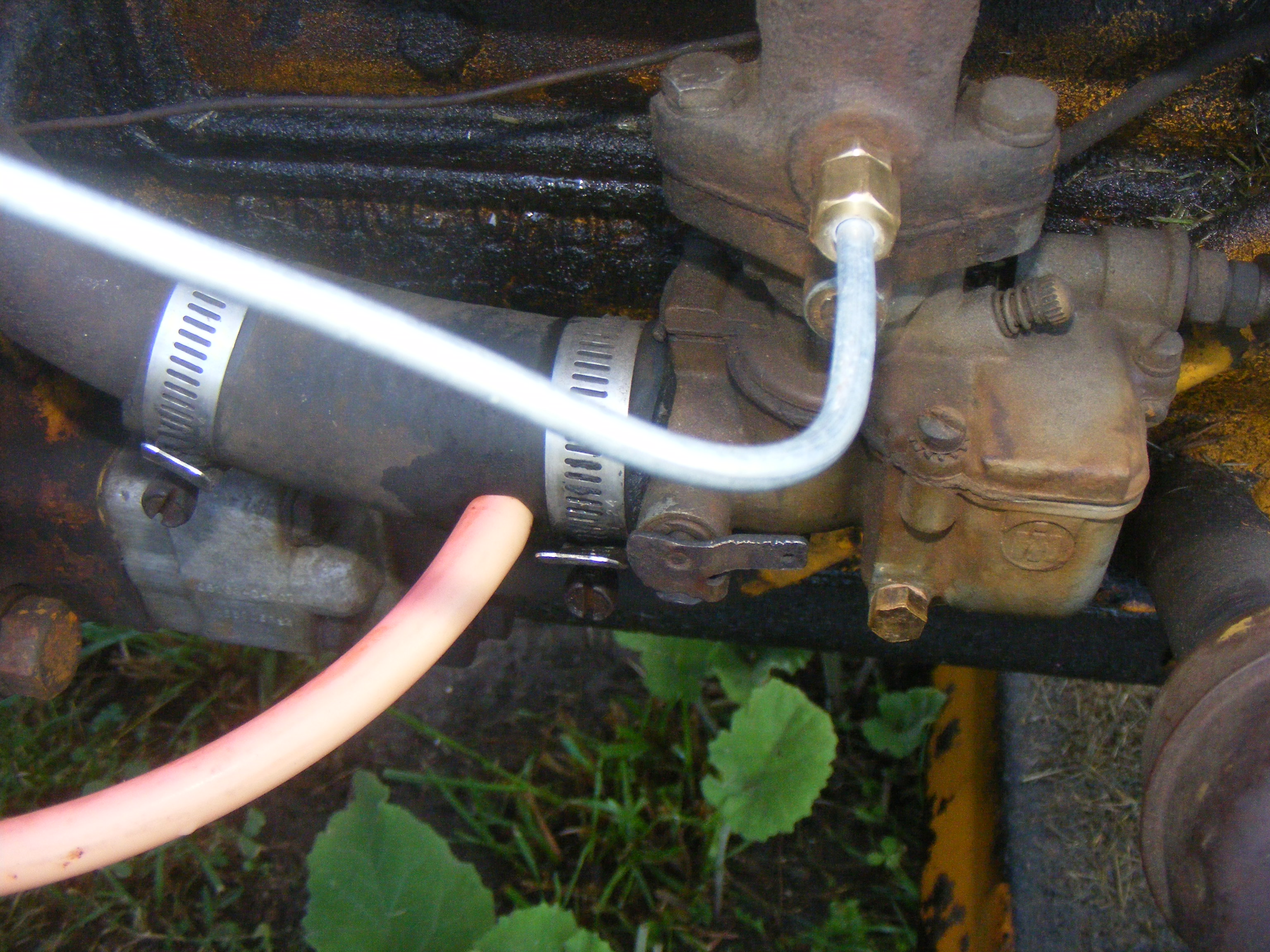

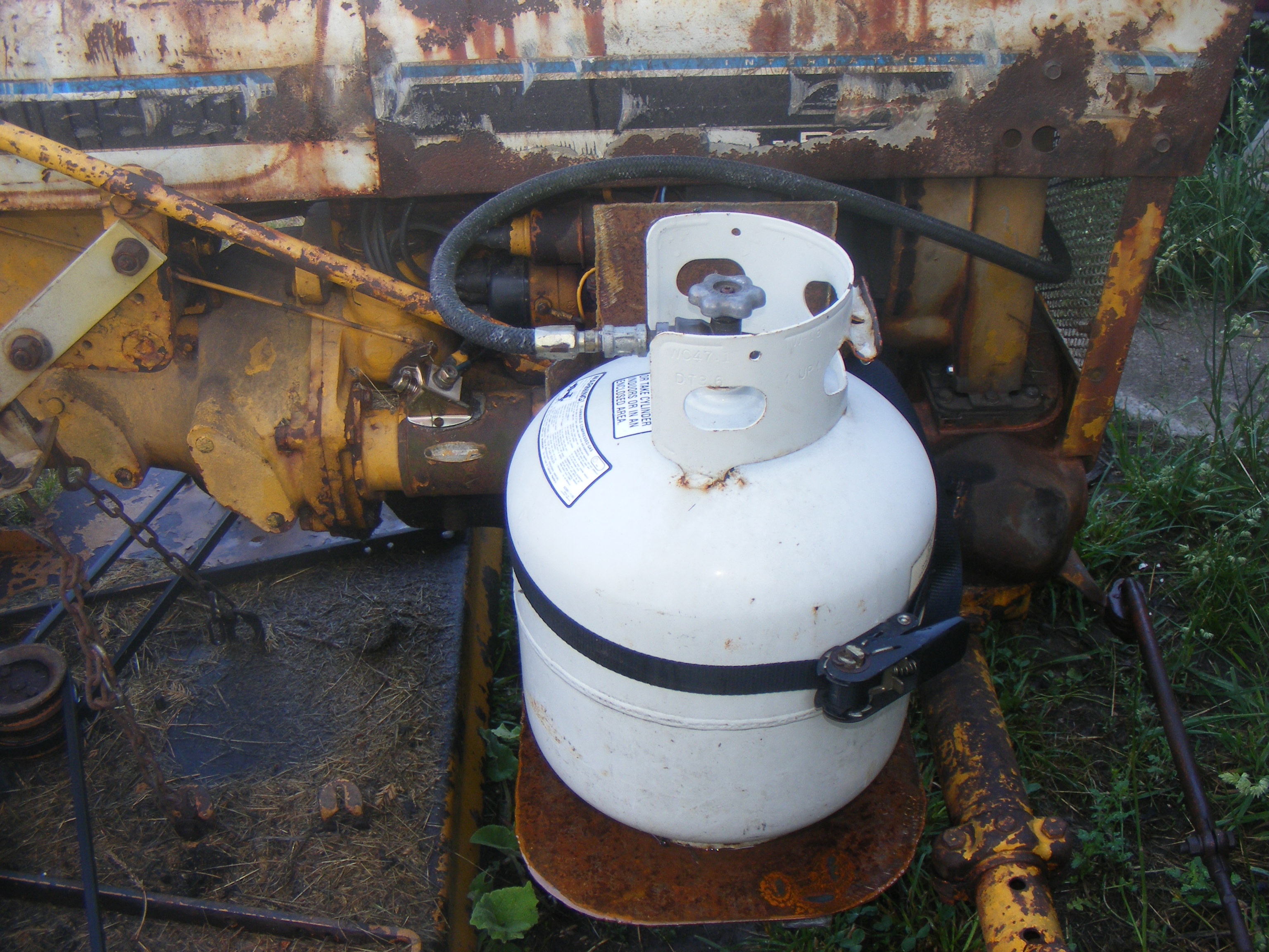

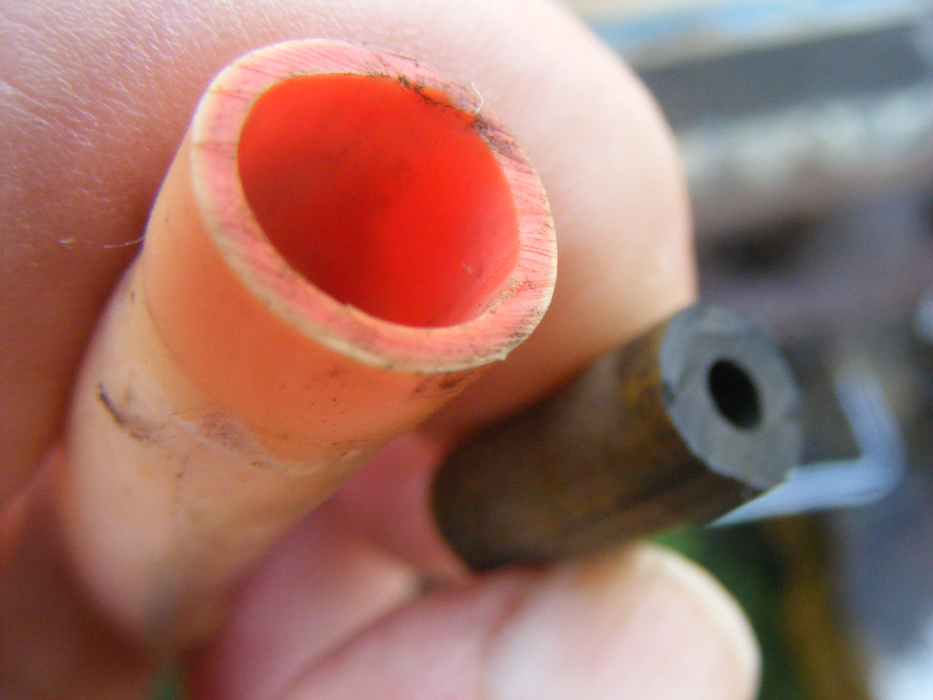

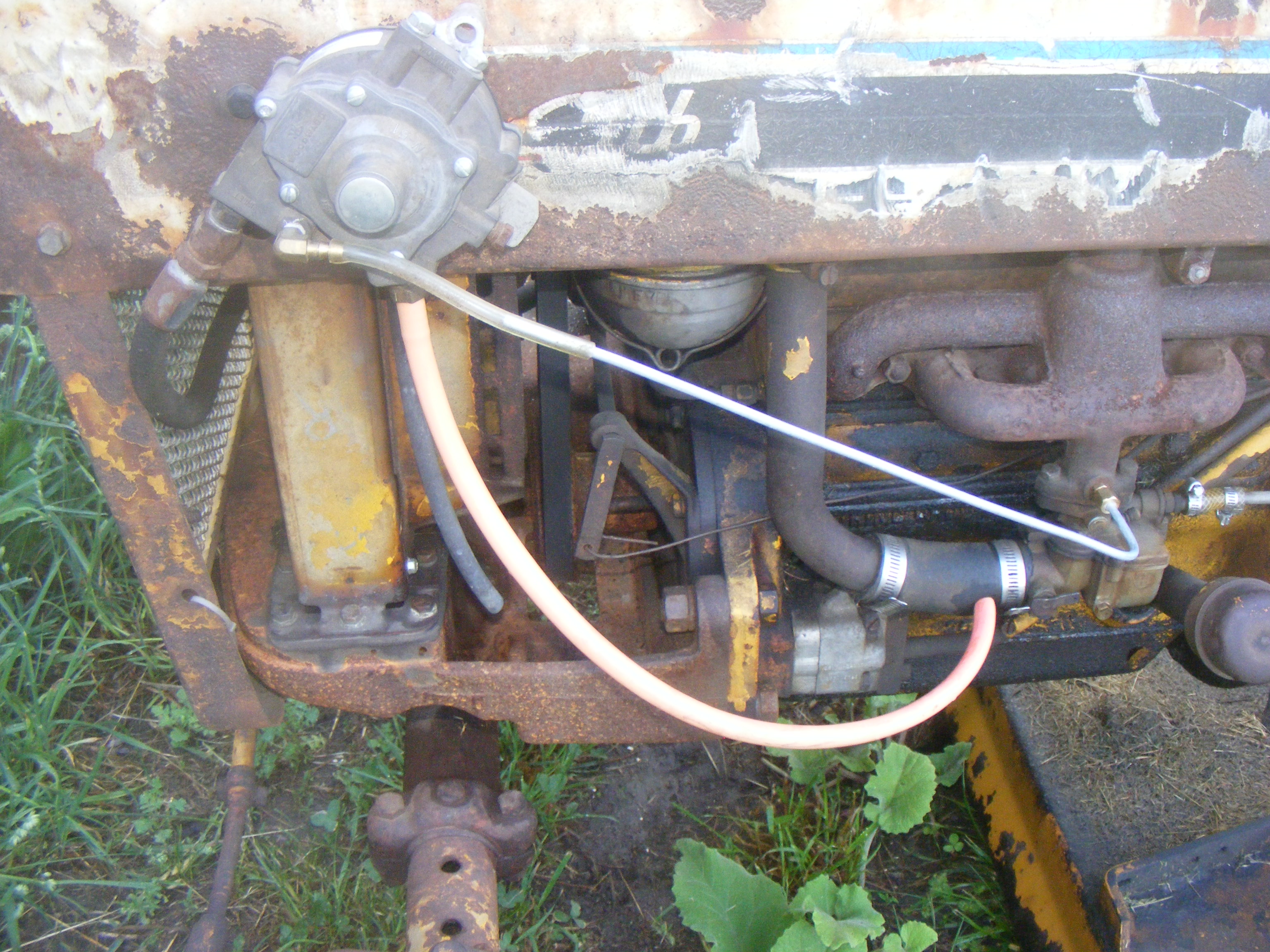

DSCF1308.JPG DSCF1309.JPG DSCF1313.JPG DSCF1312.JPG DSCF1311.JPG DSCF1310.JPG Pictures of the 1964 Cub Loboy converted to propane . You can see the homemade orifice I made from a piece of rubber hose and inserted into the vapor feed line, the full 3/8 red rubber line would not even try to start the engine, the next orifice I cut was to small and would only idle , then this one in the picture is perfect .As you can see I cut a round hole into the rubber connector from air cleaner and carb to wiggle the hose into tightly , Starts cold, carry's the mower and bounce of the governor. These tractors are known for being low power and mine is no exception but this did not seem to effect it when mowing, might of improved it. I will mention the small brake line tube ,this is a safety device built into the regulator that knows when the engine quits because the lack of vacuum and shut off the propane.

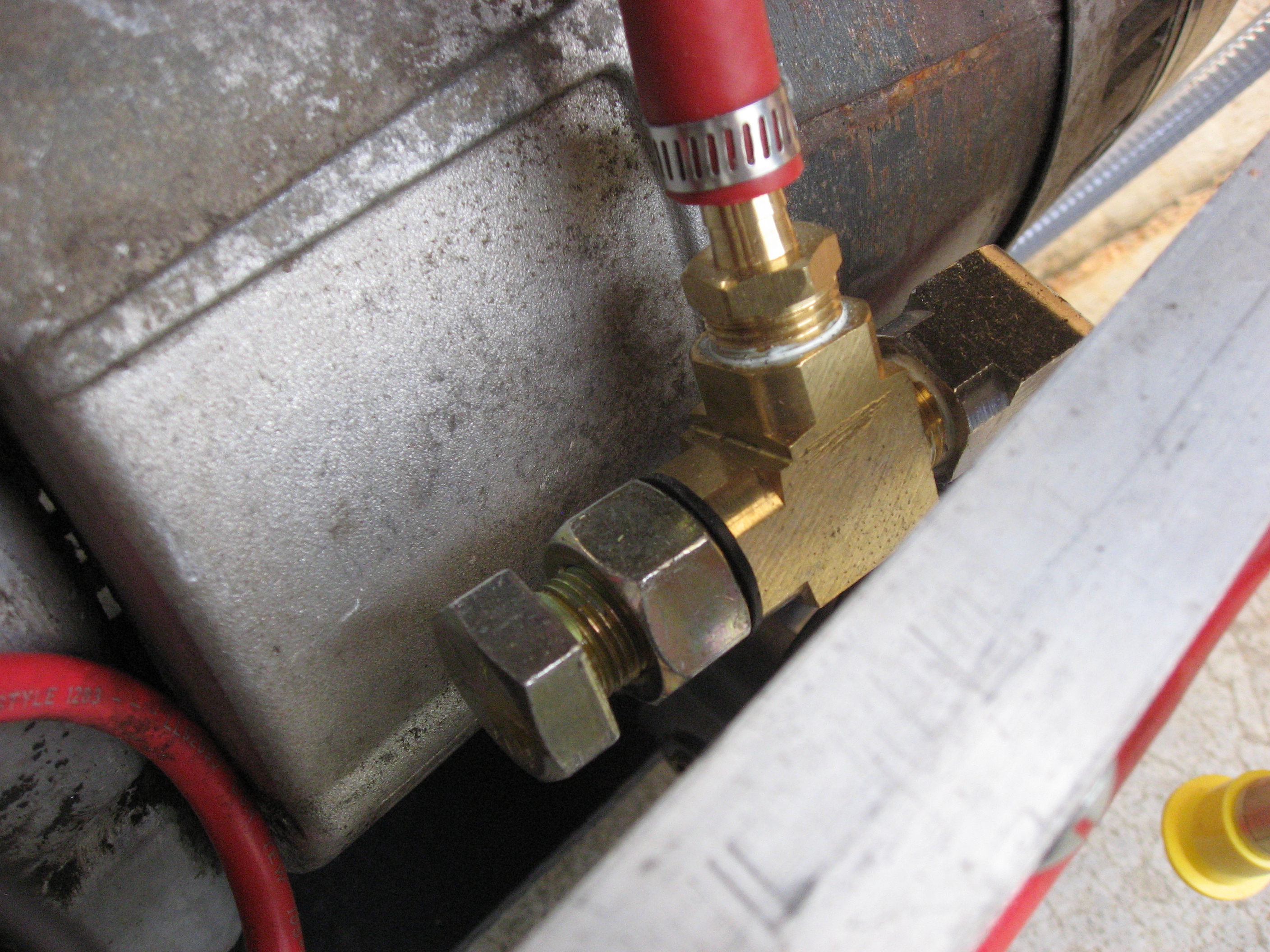

I made my own by threading a 5/8" fine bolt into a 3/8" NPT Tee fitting.

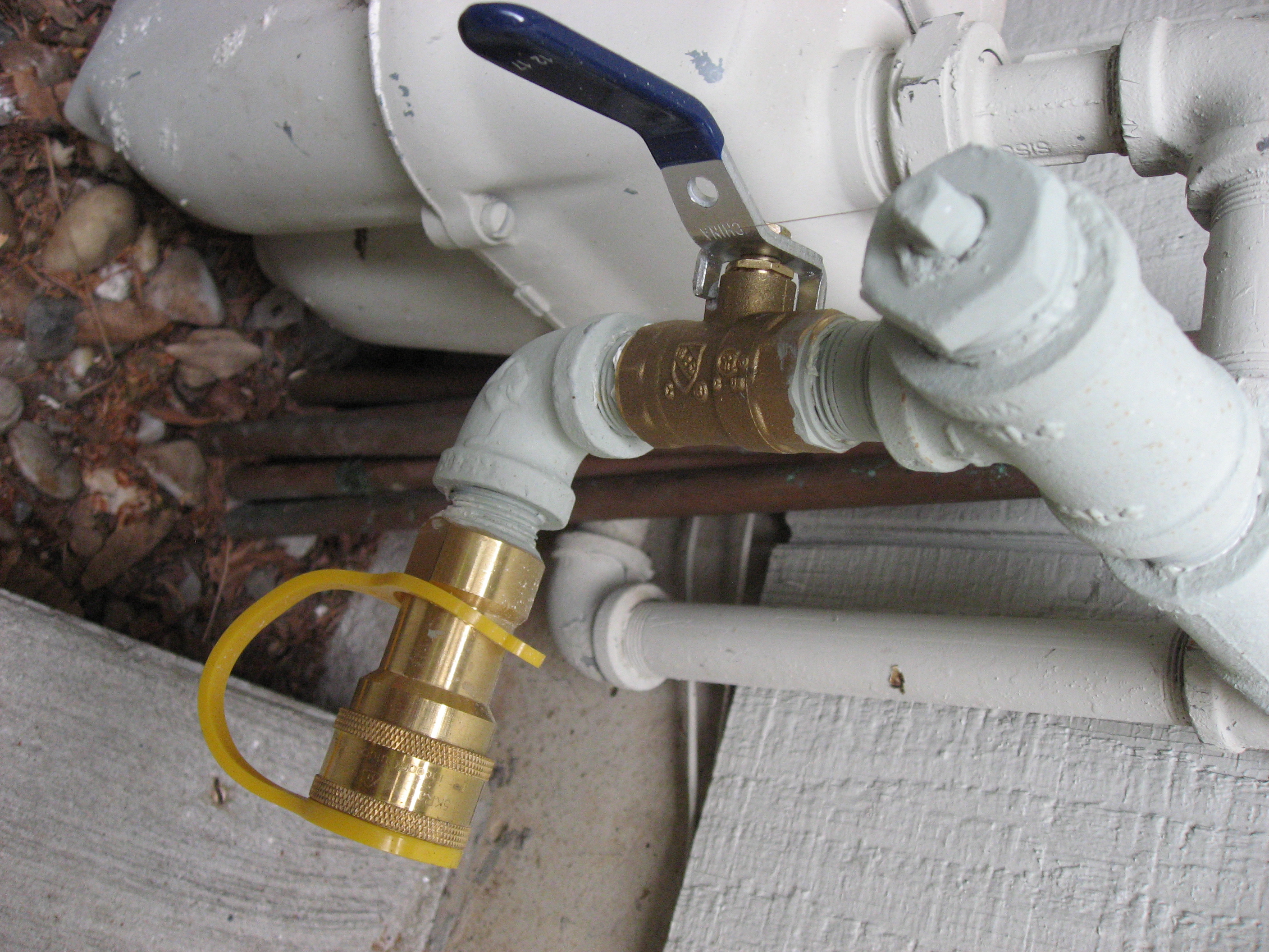

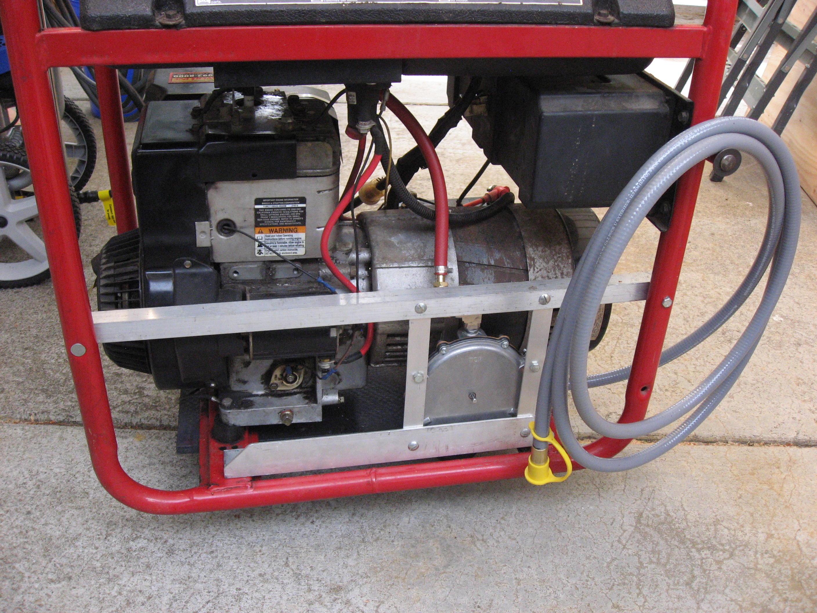

OP here. I finished this project and thought I'd post a few photos and comments for anyone interested now or in the future. I mounted the Garretson regulator to the generator frame and made an adjustment valve out of a 3/8" NPT Tee fitting and 5/8 fine (18 TPI) bolt. This allows you to fine tune the gas mixture. With this set up I could use low pressure natural gas or propane. I have added a quick disconnect to my gas meter that feeds a 12 foot hose to the generator.

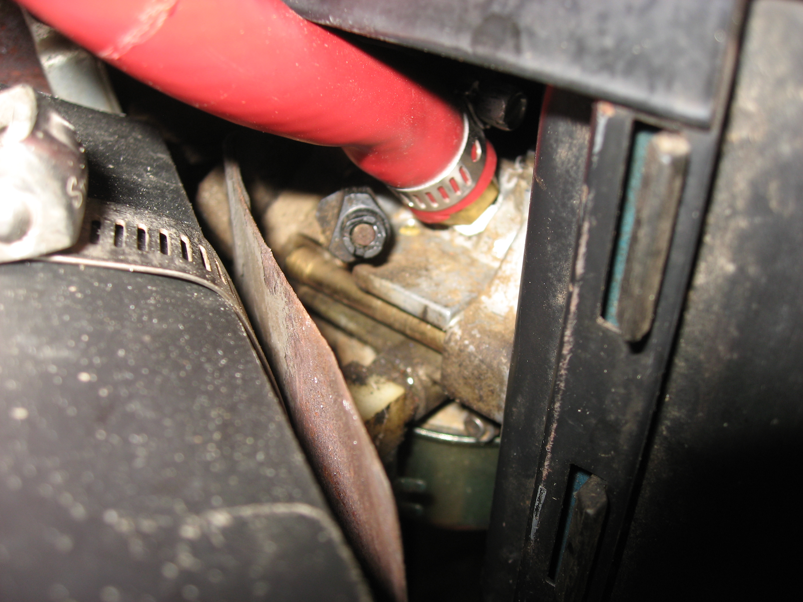

My initial attempt to feed the gas into the throat of the carburetor did not work properly. I needed more cranking vacuum and vacuum variability so I drilled and tapped the side of the carburetor right at the venturi (narrowest) point. This gives enough cranking vacuum to open the regulator and allow gas to flow and also enough vacuum "signal" to allow the regulator to open more under loaded conditions. There is an additional adjustment on the regulator to dial in the gas feed under load.
The generator still works as before on gasoline as I did not damage the carburetor when I drilled it (watch for the low speed jet passages). I've seen a number of YouTube videos where engines are converted, but they don't show them operating under load. The key to doing it right, IMHO, is to load the engine down and adjust both the regulator and the mixture valve to ensure it has the right mixture under no load and high load conditions.

Follow up. I recently replaced my breaker box and added a generator interlock so I can plug the generator right into the whole house. We had a power outage and I hooked up the natural gas line, plugged in the generator and we were off to the races. Ran my well pump and everything in the house except AC and range. The regulator does adjust automatically depending on the load on the generator. It is really nice not to have to worry about stale or insufficient gasoline.
