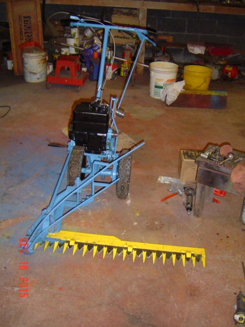

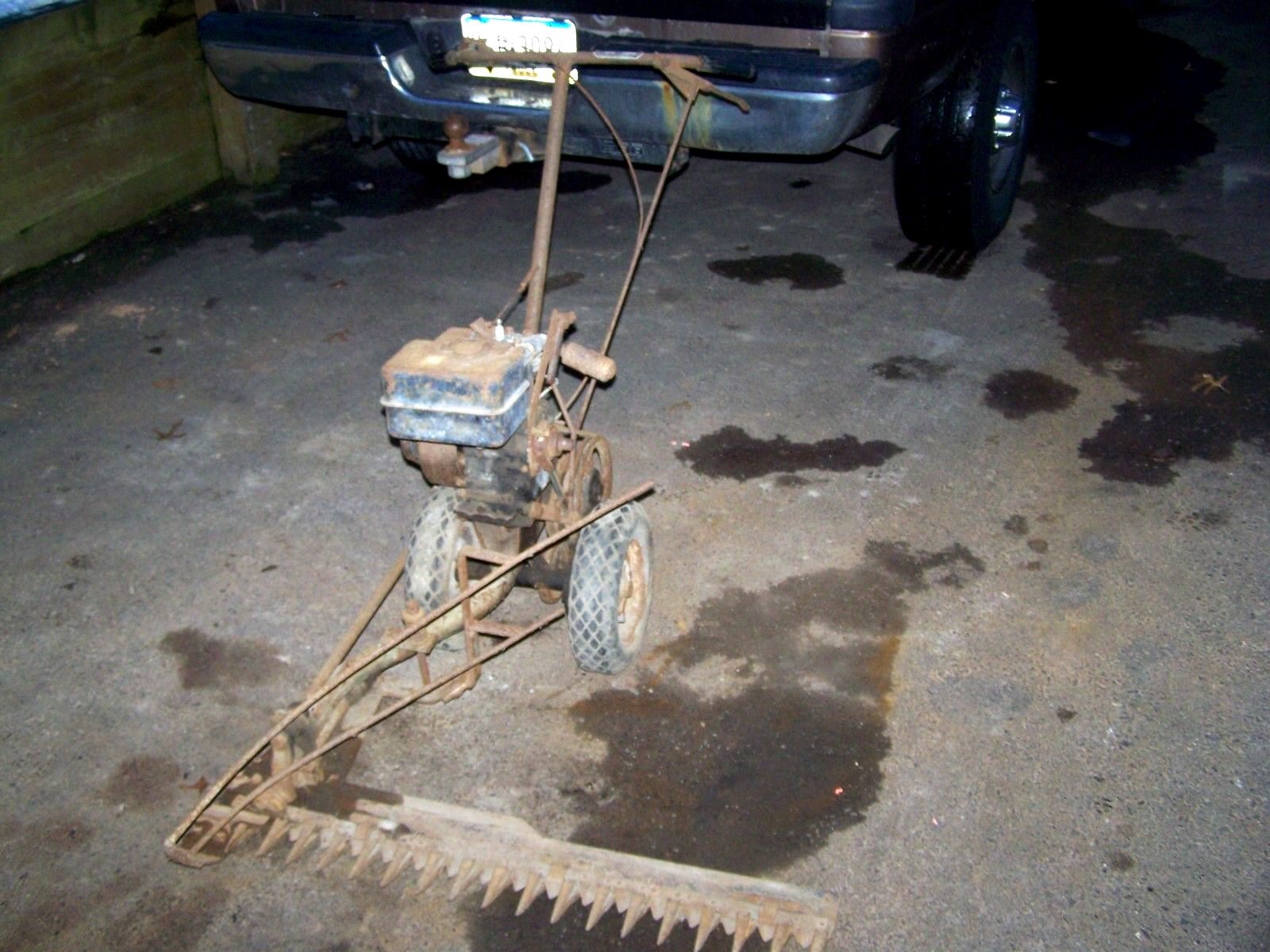

For awhile, I've been thinking about something to mow around the pond. A sickle bar mower for the Ford would be OK, .. if I felt like putting it on the tractor. I saw this Vintage National Mower on eBay in the spring, but decided against it. Once again, this fall, saw it again. I had just finished restoring the Ford Jubilee and felt "I needed a new project". It wasn't too far from me and the price wouldn't break the bank, even , if the project went sideways.

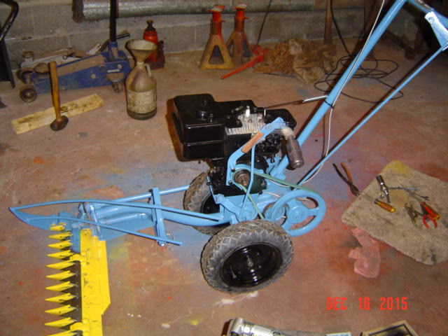

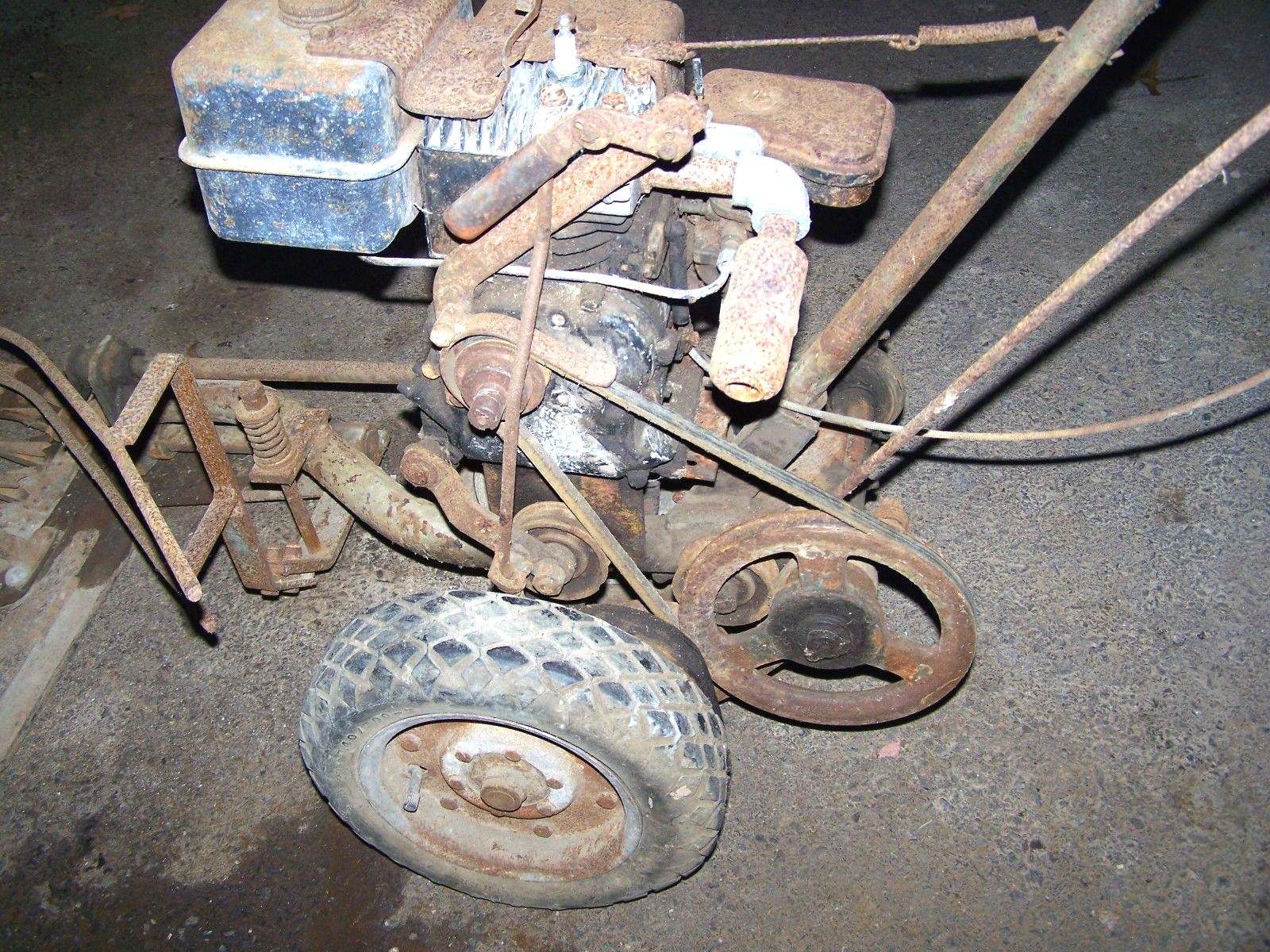

I brought it home and the next morning, started with, getting it running. It didn't have any spark, so got into the points and condenser .... I believe a speck of dirt fell from between the points, but elected to salvage a "all-in-one" magneto" from a push mower, I had, and get rid of the points and condenser .. got spark! Put a little gas in the spark plug hole and it fired right up. :thumbsup: At that point, I felt confident getting into it a bit further.

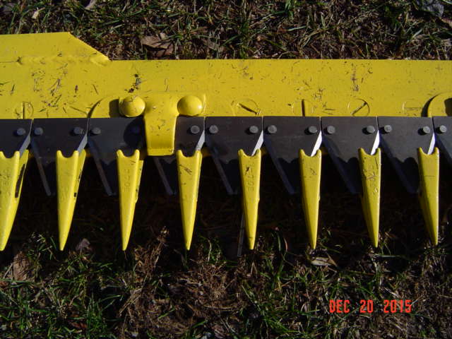

It seems like cleaning things up, is always the worse part. I sand blasted some, wire brushed some, and sanded some. I couldn't get one wheel off, so had to have it pressed off and then fix some incurred damage. It looks pretty nasty in the "before pix", but it wasn't super bad, but did have some pitting. I replaced the sections on the sickle bar and two ledger plates on one pair of guards. I also, changed the starter clutch to a more modern one, as the original only had one pawl, so a lot of the rope was out, before it grabbed. Also, a new throttle cable was in order.
I want to do a video, but haven't had time ... I'll get a video link up, ASAP. I'll try it around the pond ... hopefully the bar will be long enough, but I will have to mow around in the wrong direction, to take advantage of the bar off-set.
