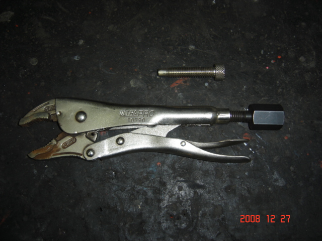

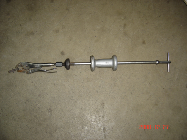

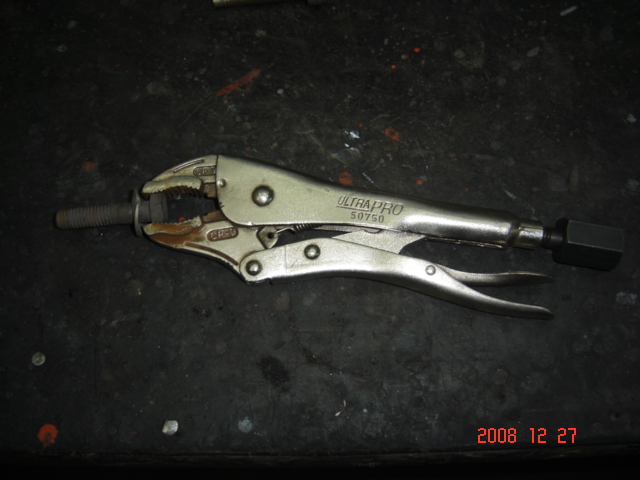

It is a adapter to make your slide hammer from your puller set hook to a pair of vise grips!:licking:
You got it.
Very handy tool. I use it all the time. Just take the adjuster out of your vise grips and put this adjuster/adapter in it's place and use your slide hammer to help pull a part off. It's got me out of some bad situations. Yes I've used it one welding jobs :p
I just try and post some of these unique tools just in case some aren't aware they even exist.

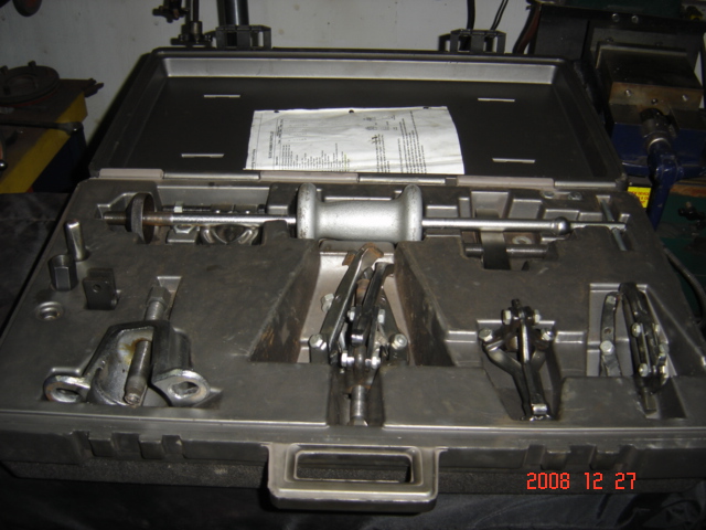

Did that come in one of those hammer sets, or did someone just adapt it for the visegrips?
/ Name this tool #2
#23
JJ it came with the puller set but I bet you can buy them separately. The set is Mac Tools. Check with them I there catalog. Cool hey! :cool:

It looks like a tool that would be easy to make Just weld a long nut used to connect all thread to the end of the vice grip. Would come in very handy.
/ Name this tool #2 #25
i have used some thing like that to adjust a clutch on some of the larger tractors but is that treaded on the in side of the nut shaped end?
