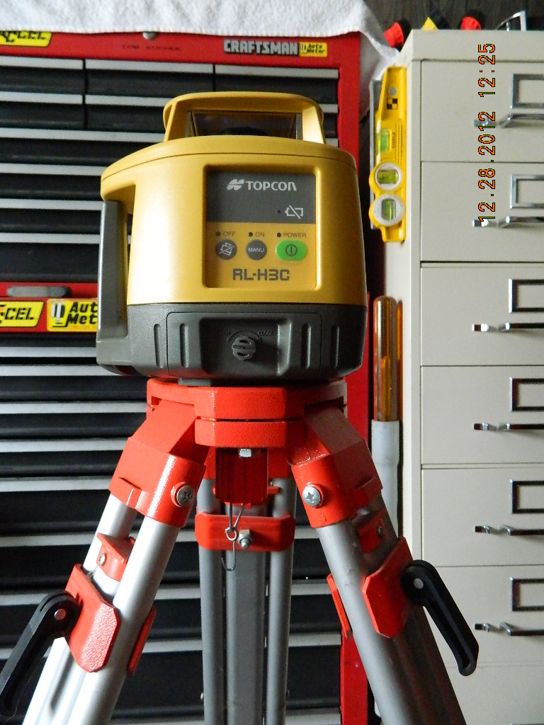

I have a Topcon RL-H3C red laser.
Bought it back in 2002 and have used it alot.
I have seen them on EBAY at very resonable prices.
It is self leveling and you can perform a cailbration yourself with instructions included or online from Topcon.
Self leveling is very important, manual leveling takes all the accuracy and throws it out the window.
Mine even shuts down from vibration or bumping it.
Requires it be turned back on and check your starting point.
It also has manual slope capability for road work and drain field work...
I have used it for siding, cabinet work, trim work, cement footings and forms, pool installation,decks, fencing,wallpapering, landscape work.....
you will enjoy owning one

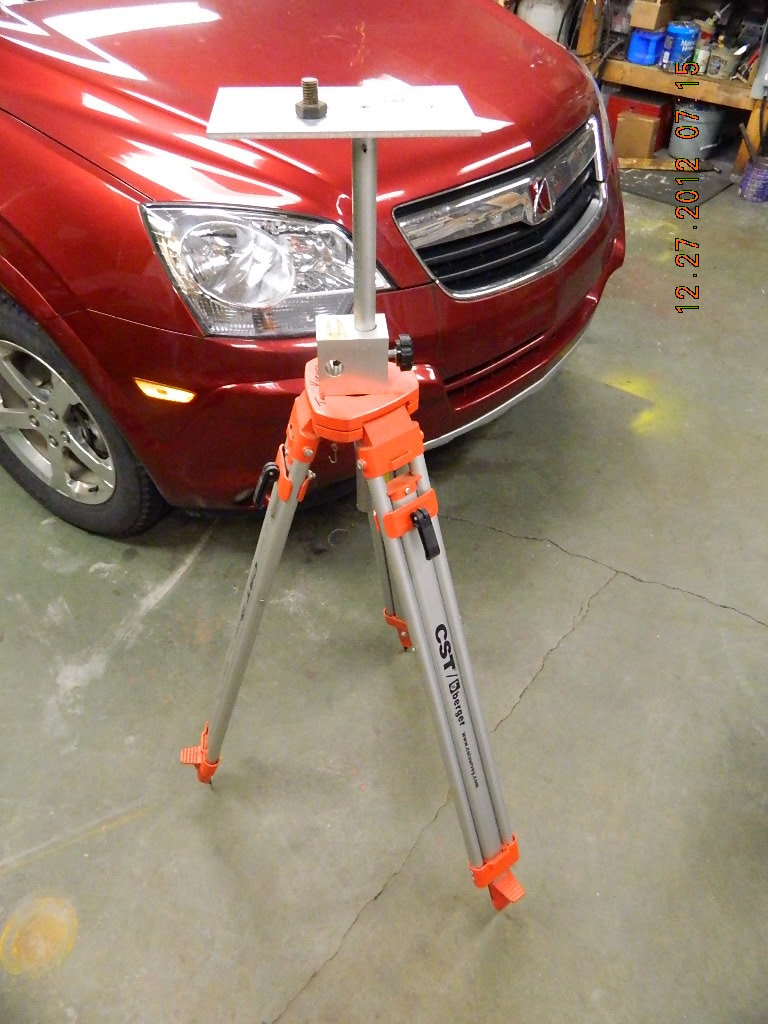

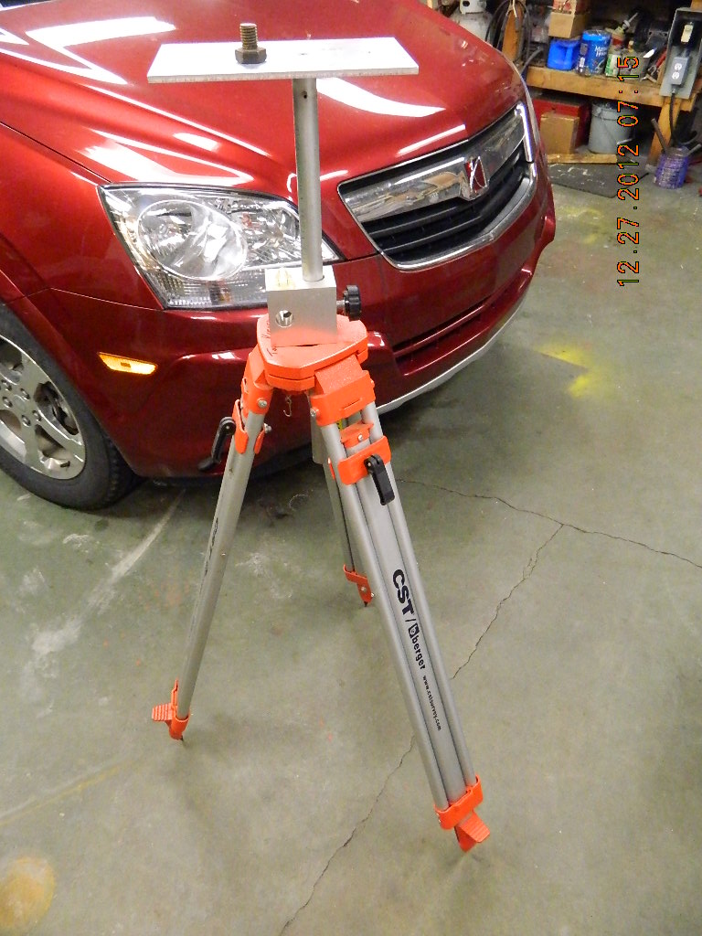

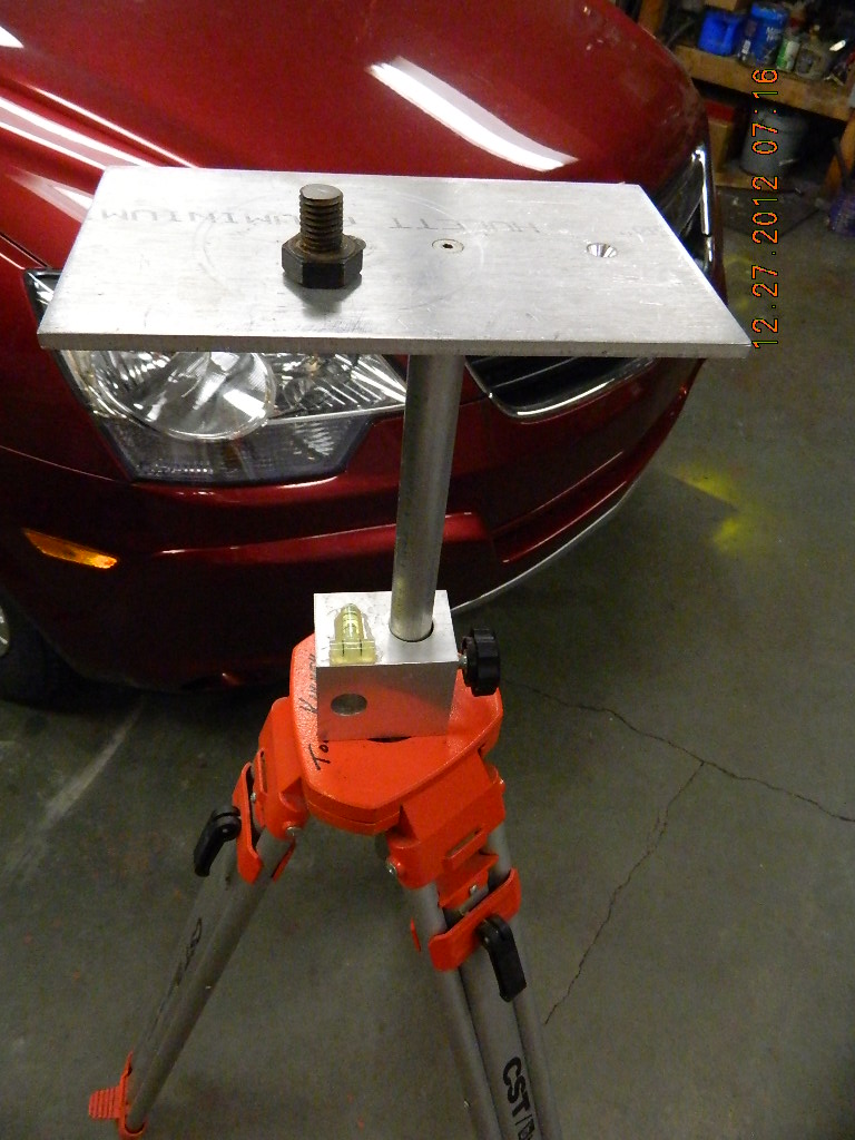

I made a quick adjustment elevation adapter for my tri-pod.
It is nice for trim work and cabinets when you don't want to use a story pole and just the detector for layout.
bolts on to the tri-pod and bolt laser to the top aluminum plate.

Thanks for the pictures

Big Dooley, thanks for info. I see that your tripod is CST but I can't see clear the plate head where the laser is attaching and I'm looking to buy one the same plus also a RL-H4C model. Can you confirm that your RL-H3C model can be mounted directly on the tripod without any adapter or I need one? The picture and description on amazon doesn't say anything.
Thx.

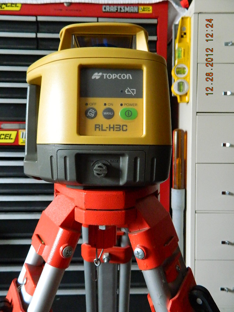

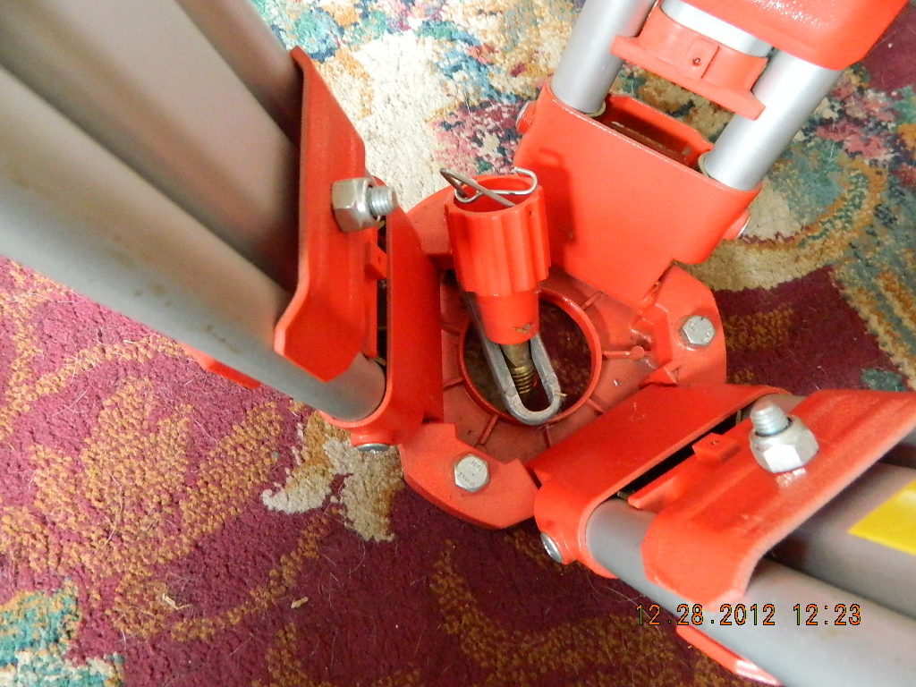

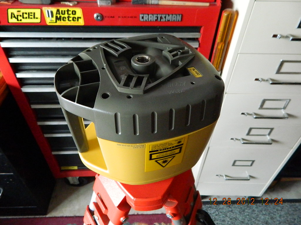

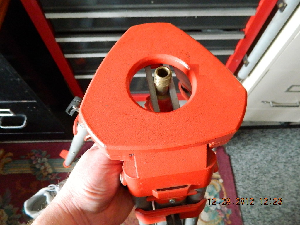

My RL-H3C requires no adapter to the CST stand.
I believe the tripod thread is 5/8-11.
Here are some pics.
Just looked up the RL-H4C.
They have made some nice improvements over the years.
You should be very happy with that choice.
Tom
