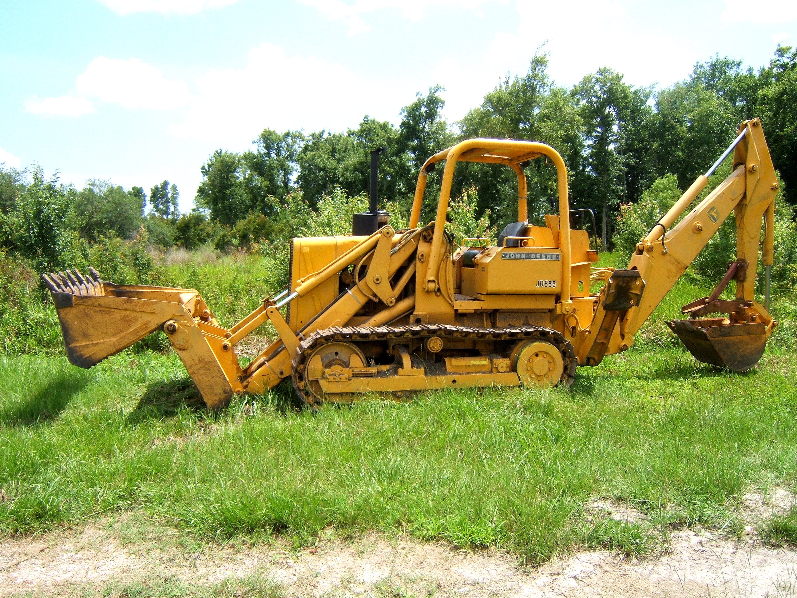

Here's my old JD 555 crawler of some years ago.
